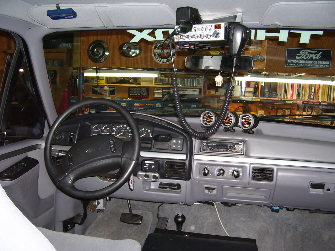

Old Jan 8, 2021 | 06:33 PM

Thats nice!!!!

Originally Posted by Briansshop
Briansshop
That is nice, can you show a pic of the mount. Thanks for posting.
Don't have any better pics of the mount,sorry. Just something I made up from some alum I had. It's been hanging up there for about 15yrs,no probs.
