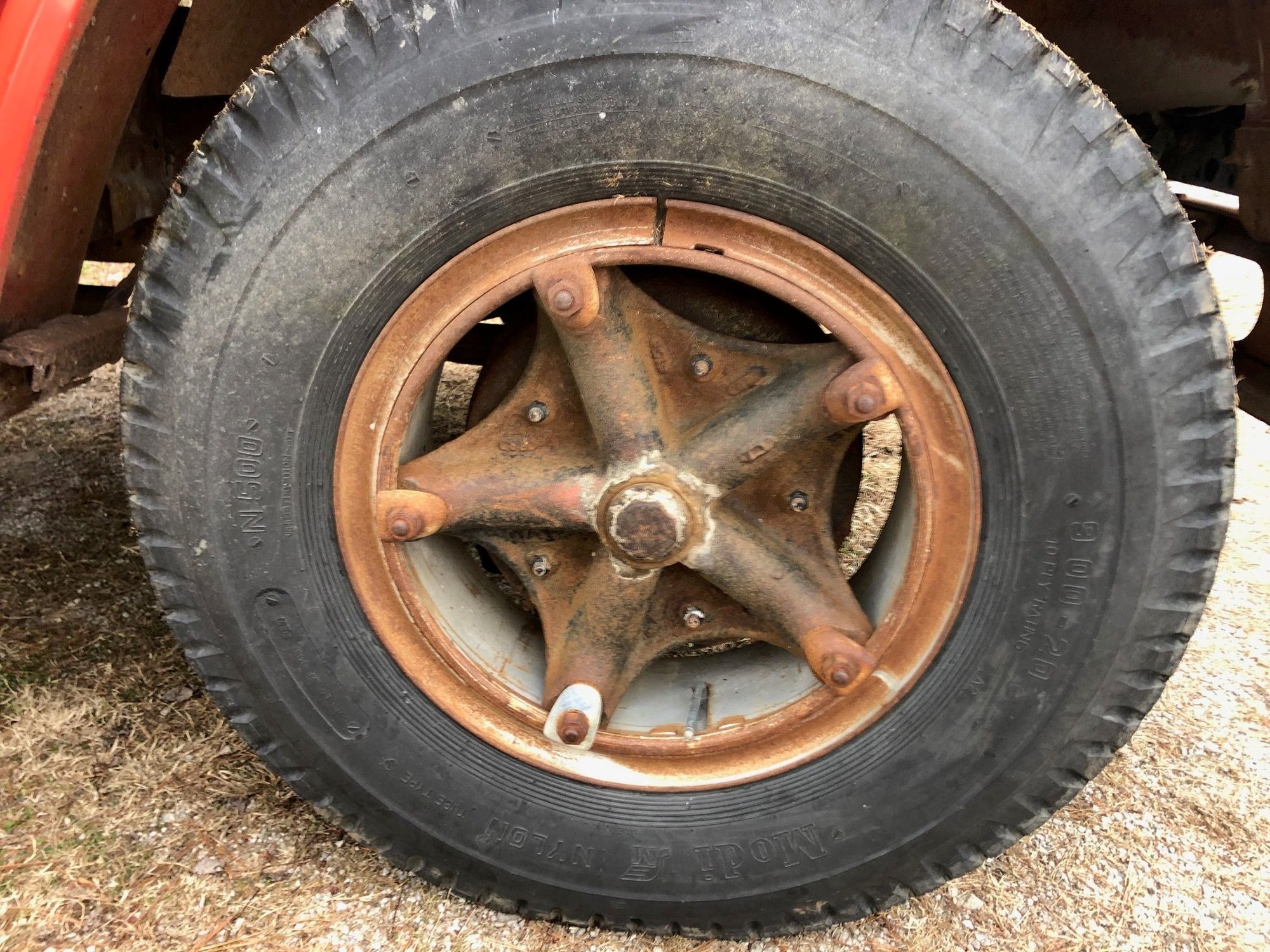

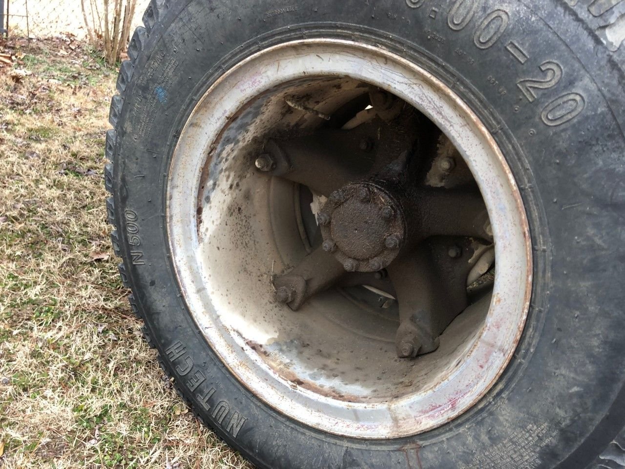

1967 N600 5 Lug Wheels
Guys I have a 1967 N600 and the wheels are 5 Lug (running 9.00 - 20 tires) instead of the 6 Lug I see many others have on here. I know there are many posts about wheels and options to replace. Can somebody take a look at these and tell me at a glance what wheels I have and what options might be available to upgrade to tubeless wheels? I'm going to be looking for tires so I thought this would be the time to look for wheels if I decide to change the wheels. Most all of the posts I've found deal with the 6 - 8.75 bolt pattern wheels and not 5 lug wheels. I don't absolutely have to upgrade to tubeless but I thought I'd see what options might be out there. IF there is already I post that I missed on 5 lug wheels feel free to just post a link to it. I may have missed it.
Front
Rear
Big Red

Guys, I found my own answer in another thread after posting this. My apologies. Again, I can't find a "Delete Post" button or I would.
The answer I was looking for appears to be here:
https://www.ford-trucks.com/forums/1...l#post19452614

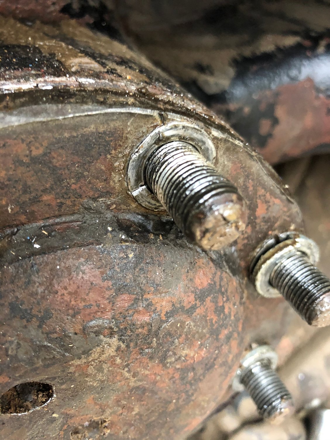

Eaton Model 16802 Rear End Seal
Eaton
Eaton 16802 2 Speed rear outer axel seal. This one has been slinging oil. I took these nuts off to replace the seal but couldn’t get the plate to budge. Any tips? Is this plate actually attached to the spline? Maybe I need to disconnect at the other end first?

That is the end of the axle. There are no clips or other fasteners holding it. Do you have a 3 to 4 lb hammer? Hit it square in the center and it will tend to "bounce out".
You are not the first nor are you alone. This covers the same situation:
https://www.ford-trucks.com/forums/1...questions.html

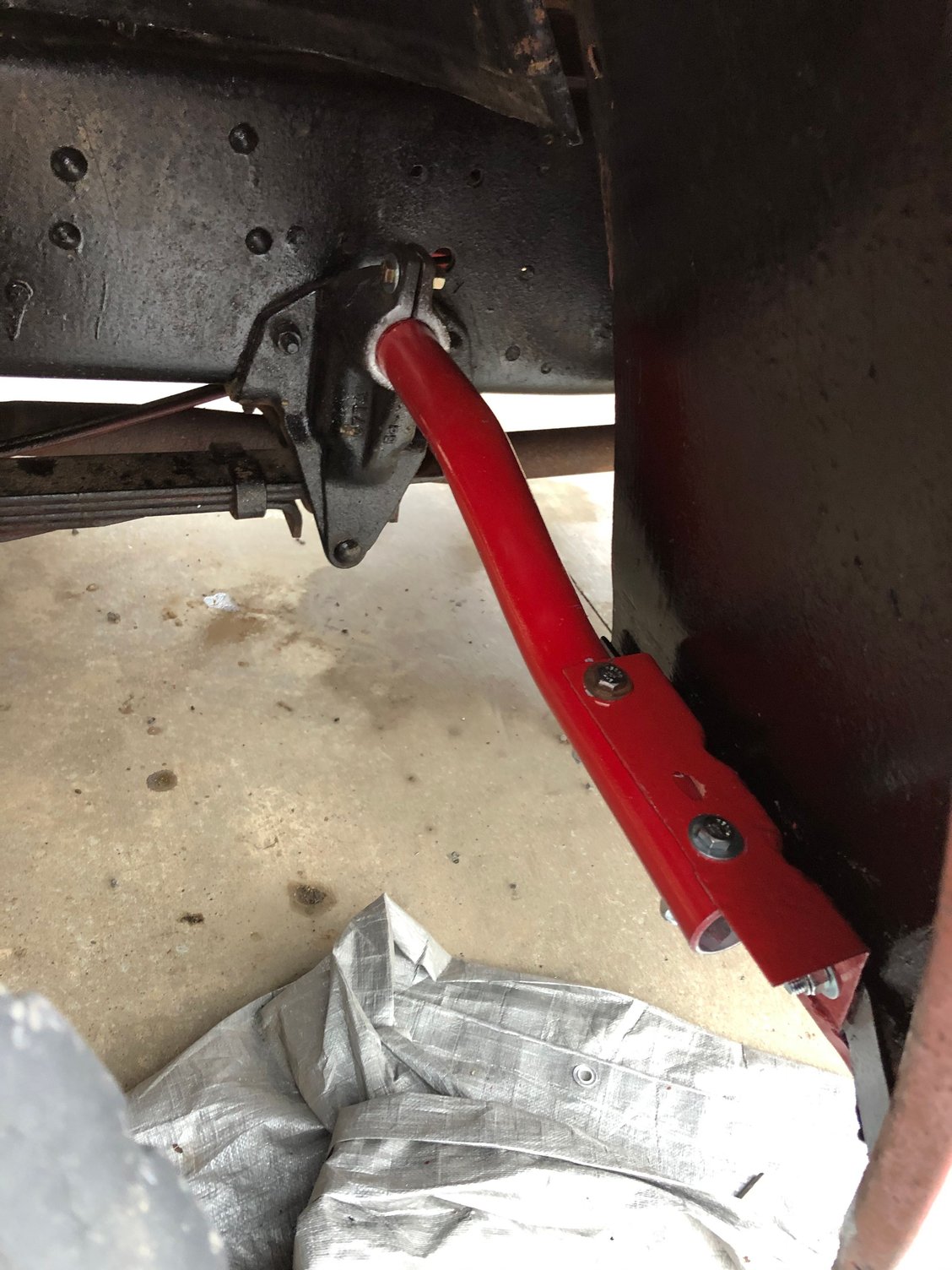

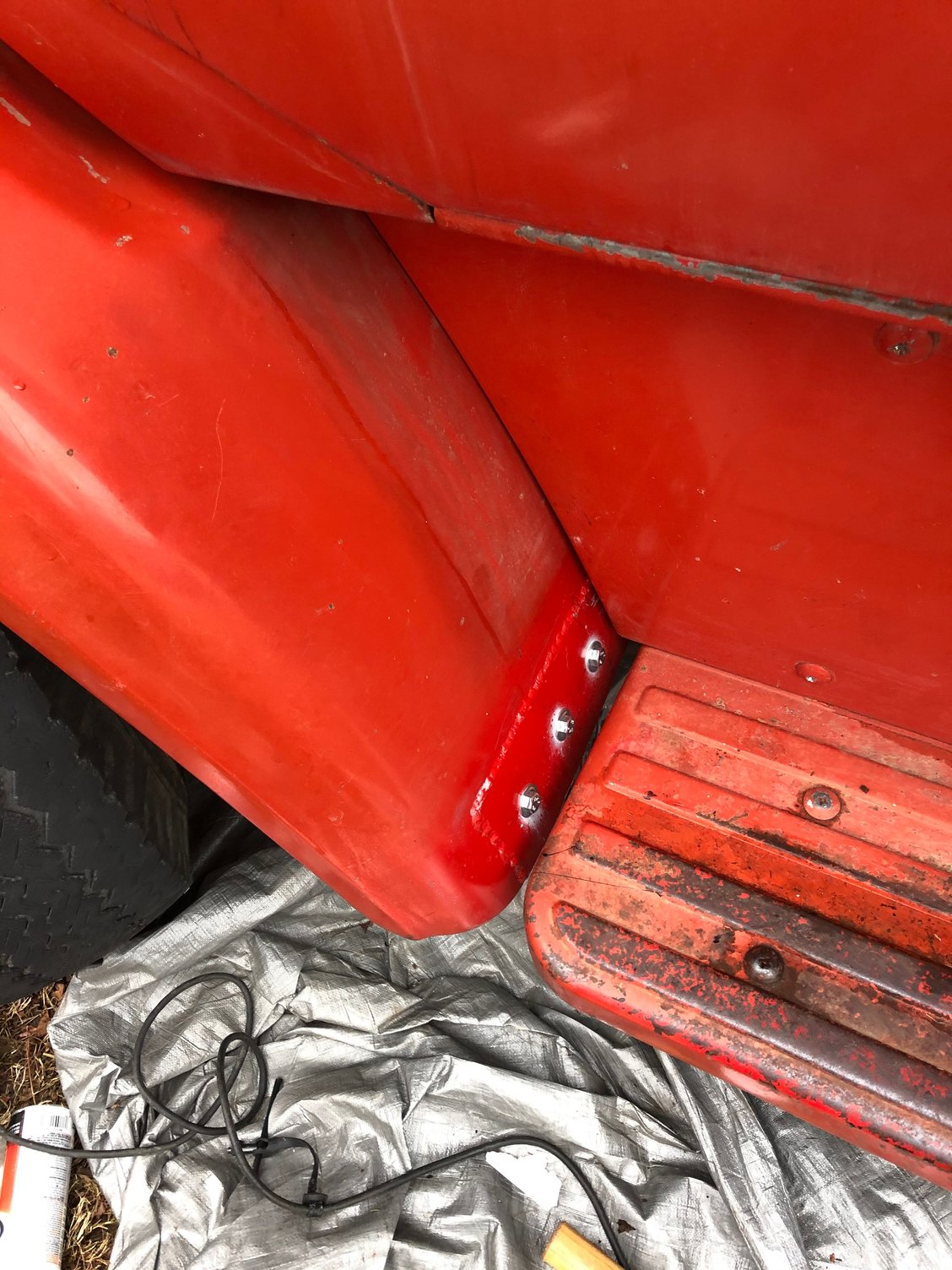

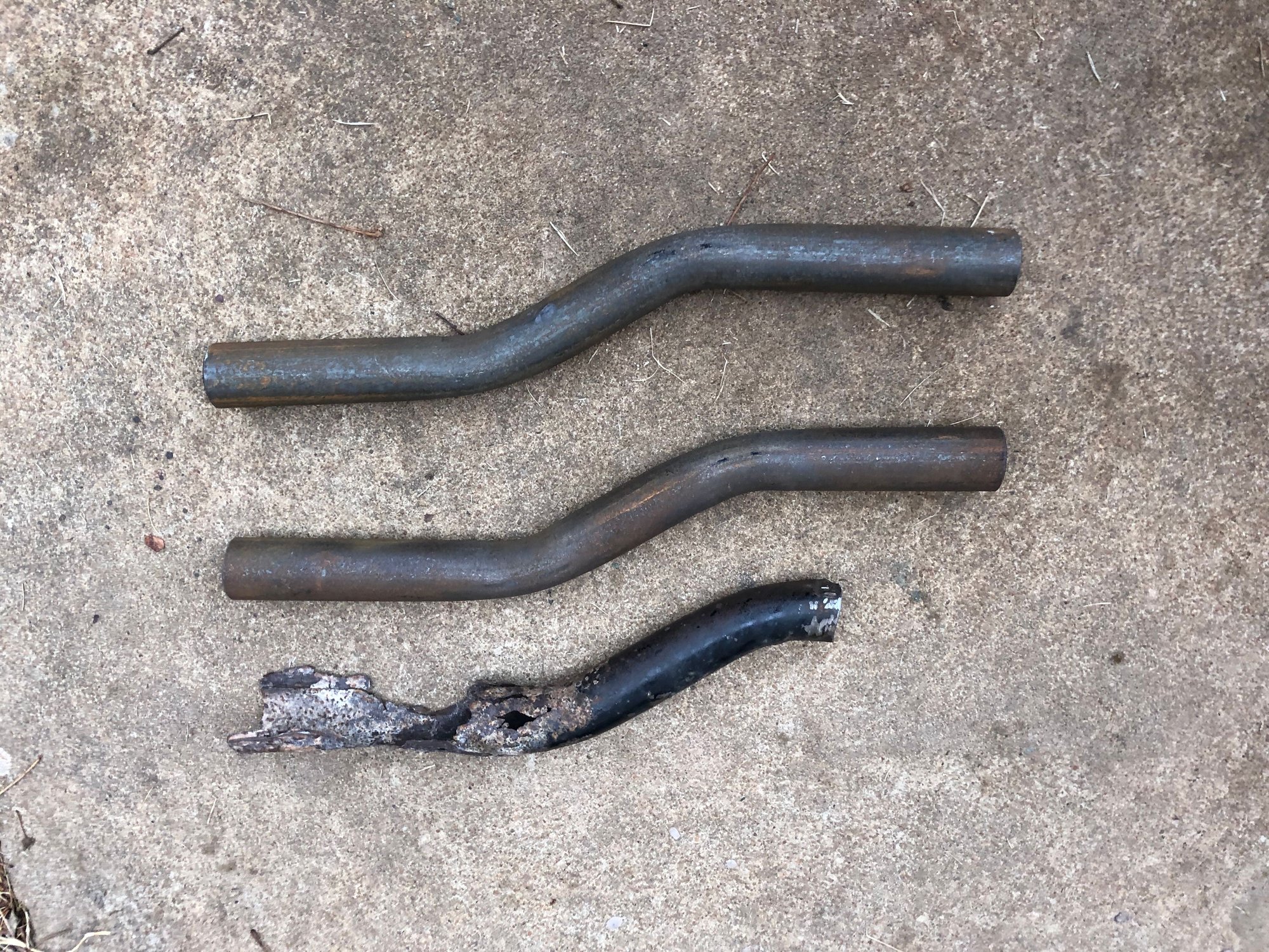

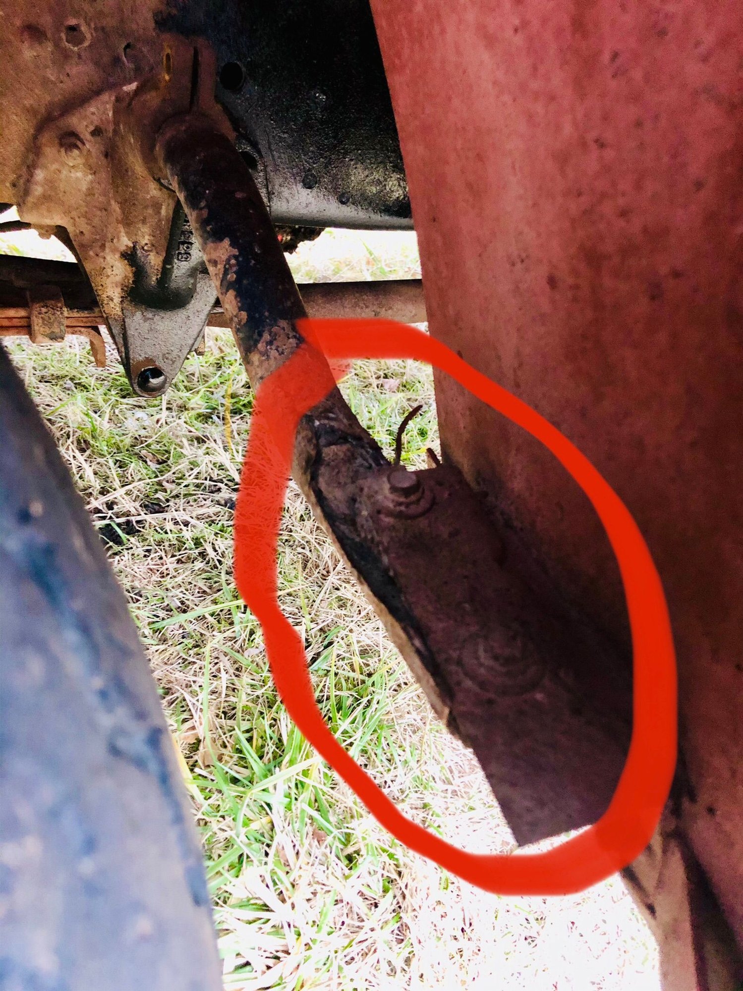

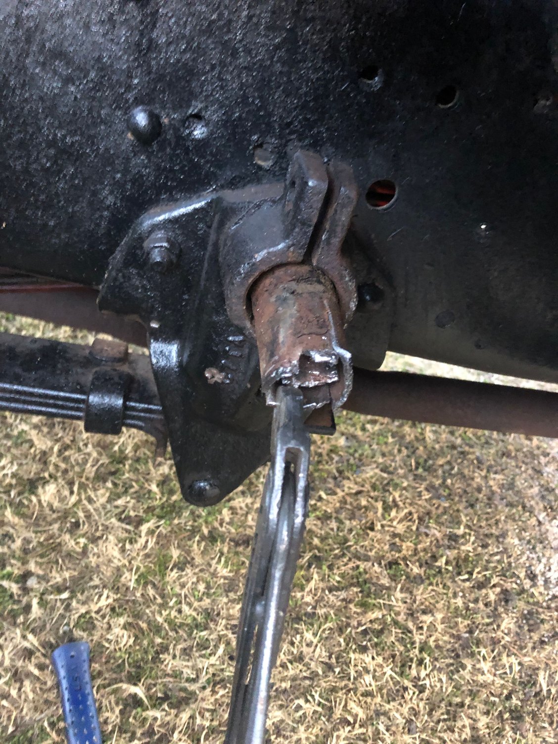

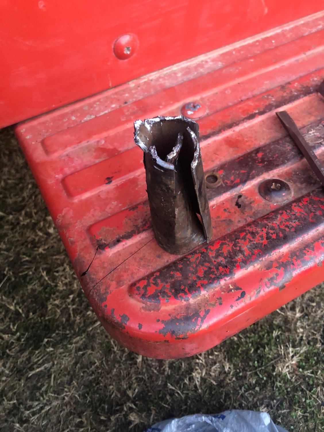

N600 Fenders

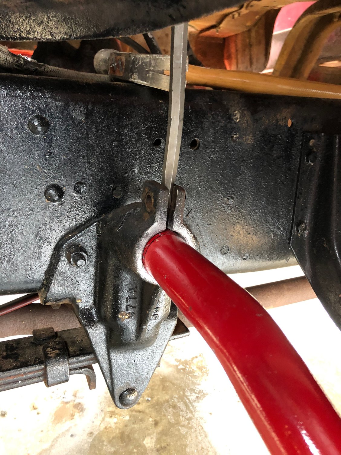

As is typical for N600’s the front fender mounts/brackets are rusted out. I’ve been working on a fix I thought I’d share for anyone else interested.
1. I loosened the bracket clamp bolt to remove the old one but found the pipe bracket to be solidly rusted in place. It would not budge.
2. I cut it off flush and then used a sawzall and cut the remaining portion into sections. Using a hammer and chisel I collapsed a couple sections and was finally able to pull it out. Liberal use of PB Blaster helped too.
3. I took the old rusted piece to the steel yard and matched the size as close as I could to what they had available on hand.
4. The local muffler shop was able to bend the pipes for me to match the original ones.
5. The outside diameter was just shy of what was needed for the frame clamp to tighten securely down. Initially I thought I would have to weld the pipe into the clamp. However the clamp is cast metal so that can be a challenge. The muffler shop simply expanded the clamp end of the pipes for me which solved the problem. Once expanded they were slightly too large to fit in the clamp so a chisel was used in the top of the clamp to open it slightly larger and allow the pipe to slide in.
Here’s some photos for reference should anybody find them useful. Note the fender was removed in the first photos to complete other work and it made access easier but it’s not required to remove the fender to do this. Makes it easier though.
Diameter of my replacement pipe. Very slightly larger would be perfect for the clamps and not require expansion but the muffler shop had no problem expanding it for me.
Chisel used to open the clamp for the slightly larger diameter pipe after expansion.
Installed.
Step view after completion.

Nice work. I have an older N-600 where the rear front fender was bolted to the front of the cab step. I have been exploring a mount much like what you have there. Keep up the good work.
