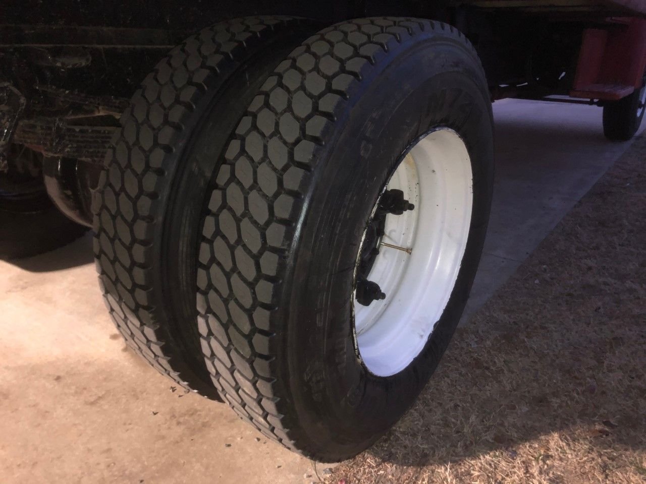

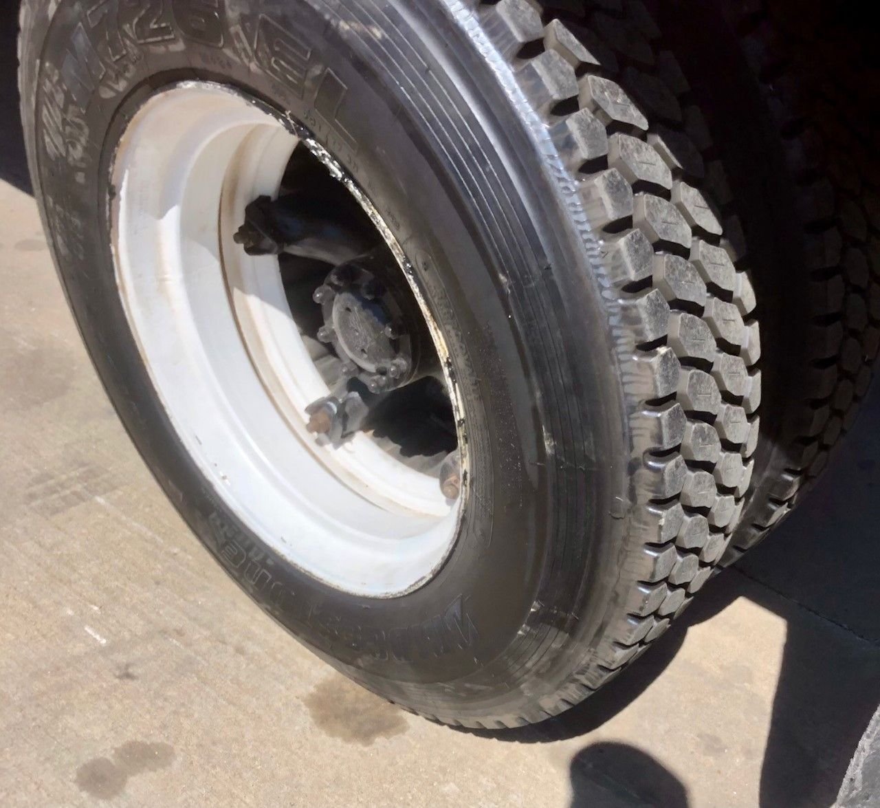

Dayton Rim Conversion 9.00 - 20 to 10R 22.5 Complete
Quick update on the conversion. Many thanks to guys on this forum for helping me through the process. Especially Truckdog62563.
I actually found new re-treads at Southern Tire Mart for $135 each for the rears. New tires were going to be $375 a each so that was a big savings. Had to put new ones on the fronts and those ran $375 each.
Bridgestone retreads

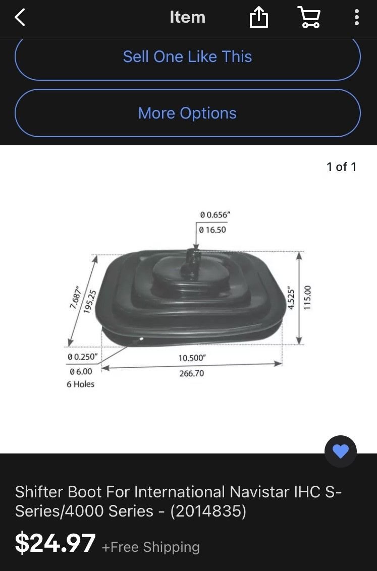

N600 Shifter Boot
The floor shifter boot for N600's is long obsolete. Here's what I came up with and it works great in case it can help anyone else.
Just turn it upside down and stretch to fit.
Old Apr 10, 2021 | 08:01 AM
wharthog's Avatar
wharthog
Joined: Feb 2008
Posts: 516
From: Michigan
Now that is sharp! I'm headed that way. Thanks for posting that info.
Old Apr 12, 2021 | 02:53 PM
Bluetick01's Avatar
Bluetick01
Trailering
Joined: Jan 2021
Posts: 24
From: Tulsa, OK
I thought someone else might be looking for a solution. It was about to closest available (dimension-wise) that I could find and it worked for me. Good luck!

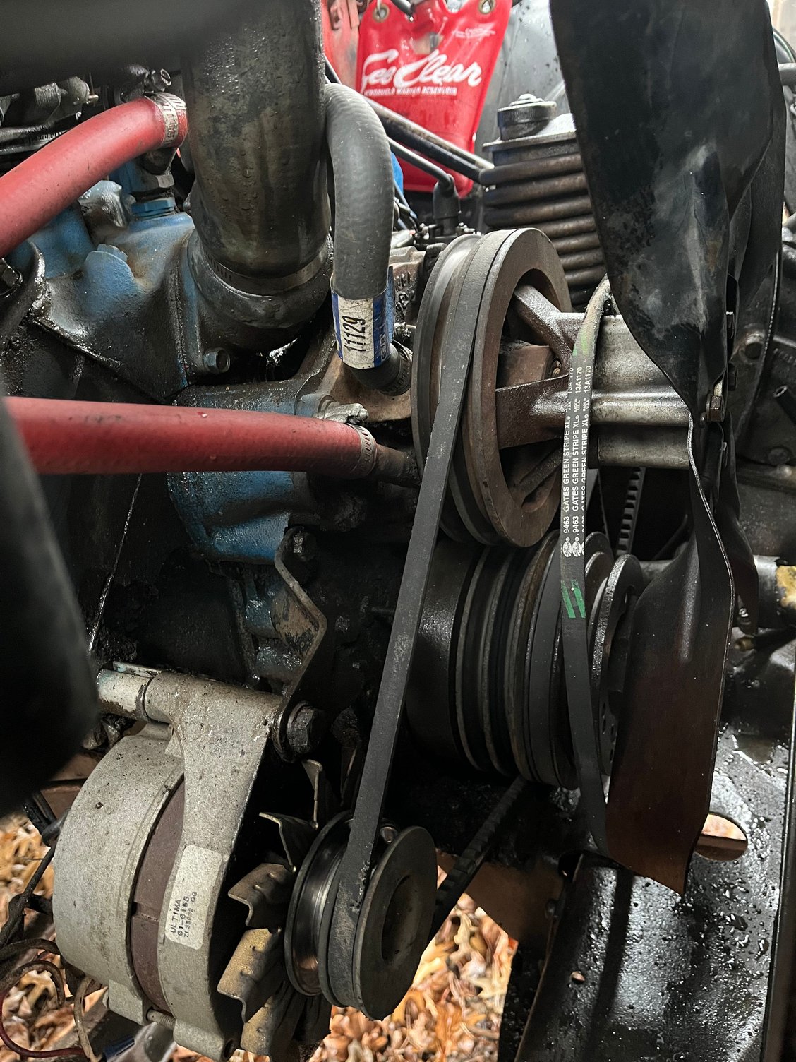

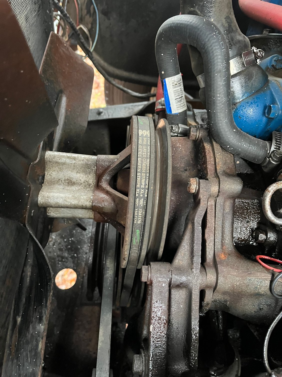

361 Water Pump
Having trouble locating a 361 water pump that looks like this one. Anybody got a lead?
Old Jan 24, 2024 | 05:30 PM
  #29
85e150's Avatar
85e150
Joined: Apr 2004
Posts: 34,476
Likes: 2,800
Is this your model?
https://www.ebay.com/itm/174939813443
Old Jan 24, 2024 | 08:31 PM
  #30
Bluetick01's Avatar
Bluetick01
Trailering
Joined: Jan 2021
Posts: 24
From: Tulsa, OK
Still looking
I haven’t pulled mine yet but what’s throwing me off when comparing the one you sent and mine are these ports. I don’t see those on the ones on I’ve found.
