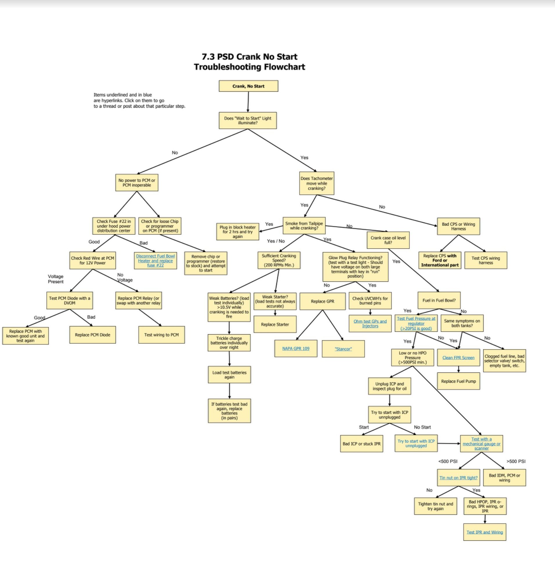

Damn, Grab a test light I prefer a non-LED, check fuse 22 under the hood AND 30 under dash, installed, IIRC the left side looking at it should be hot with the key off the right side should be hot with the key on. How do the grounds look?
Old Jan 18, 2021 | 09:40 AM
Willys54's Avatar
Willys54
Joined: Jan 2021
Posts: 5
Thanks for the truble shooting chart I will hopefully be able to work on it again after work today. The grounds on the truck have been replaced with new heavier ones
