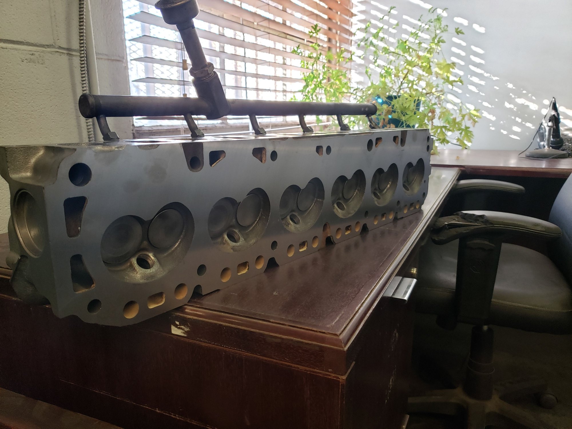

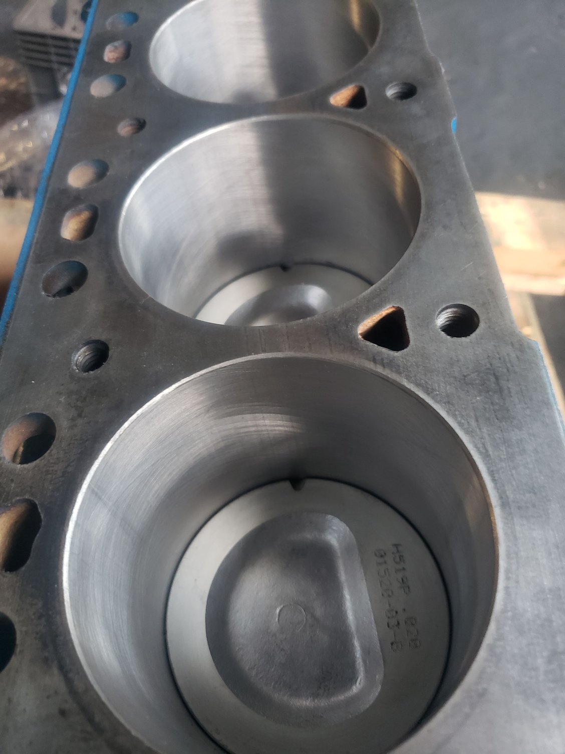

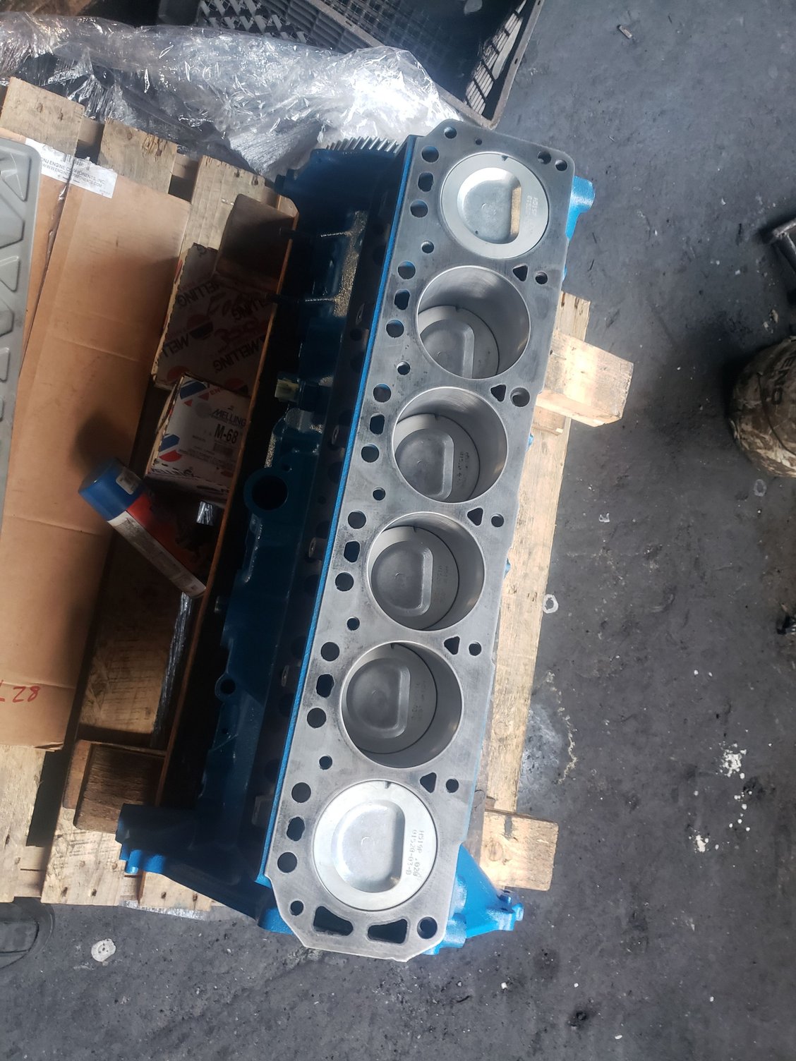

What it looks like now. The head is on but did not take any pictures. Only add on is the melling cam

The stock Fuel injection requires the PIP signal from the stock distributor to operate.
There is no way to duplicate that signal with an HEI distributor.
Otherwise everything looks good.

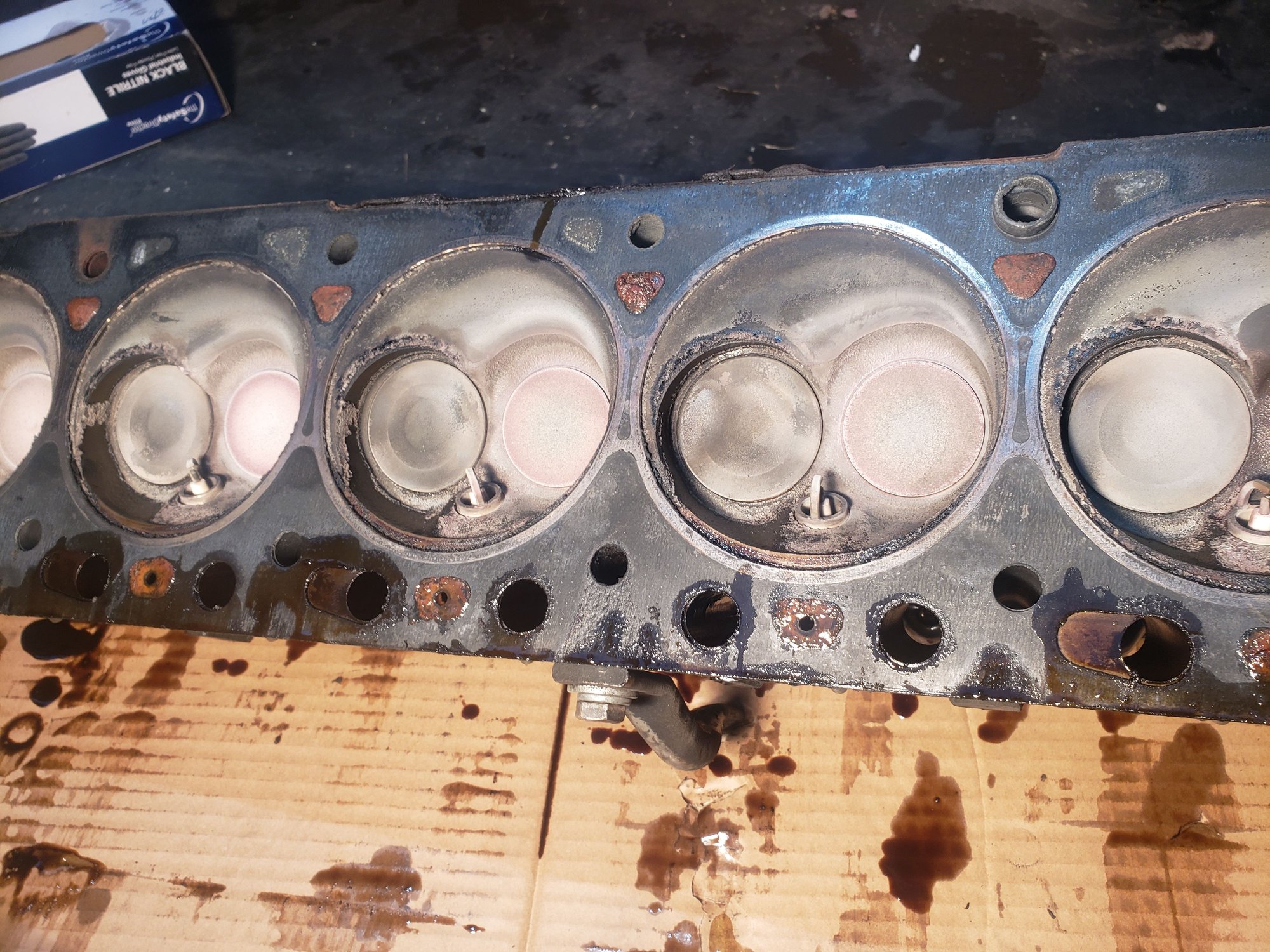

The machinists finally answered today. Says he only took .010 off the head. Looks to be a bit more then that wouldn't? At lease by looking at the before and after pics. The combustion chambers are a lot smaller than original.
Before machining
After machining

Based on the material left around the "pry up" slots on the edge of the head I would say your machinist is correct. Generally speaking, a .010" head cut will clean up most used heads

My experience with Ford engines of that era is the combustion chamber generally runs a little larger than print, probably due to the engine plant leaving a little extra on the head casting after machining. A .010" clean up cut will not change the compression ratio significantly; I would say you are still close to the published chamber volume of the head.

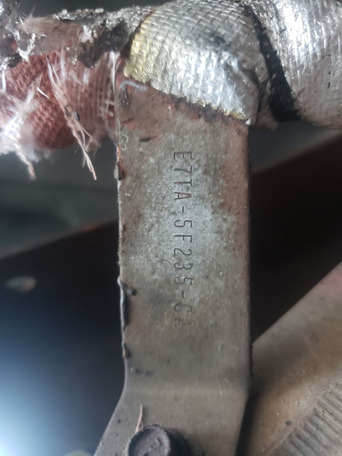

Thanks for the input, you've all been a big help. Now on to my next issue. Been trying to find a replacement A.I.R. tube and check valve. Any Idea where to find them or happen to know the part # for the check valve? Found the part # for the tube (printed on the tab).

I fixed somebody's once many years ago using a flexible gas supply line for a hot water heater. I think it was stainless steel so there no longer was a corrosion concern.
not a bad idea, I'll check out one of those. Thanks again
