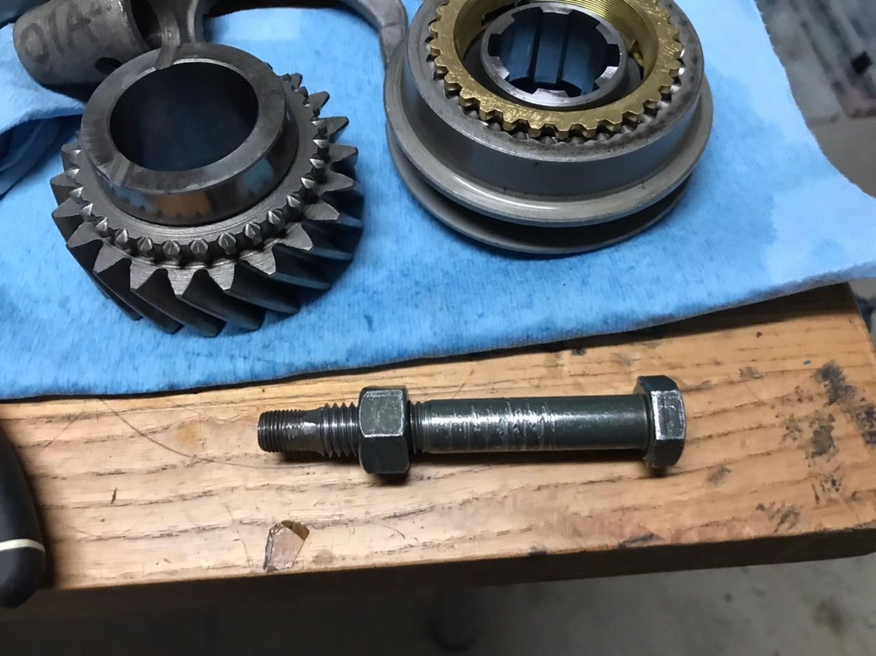

I think it was Stu that posted about making a tool for the pins. I followed it and it worked great. 1/2 grade 5 bolt ground down and threads cut to catch the grease zerk. Used a variety of washers to pull the pins.
