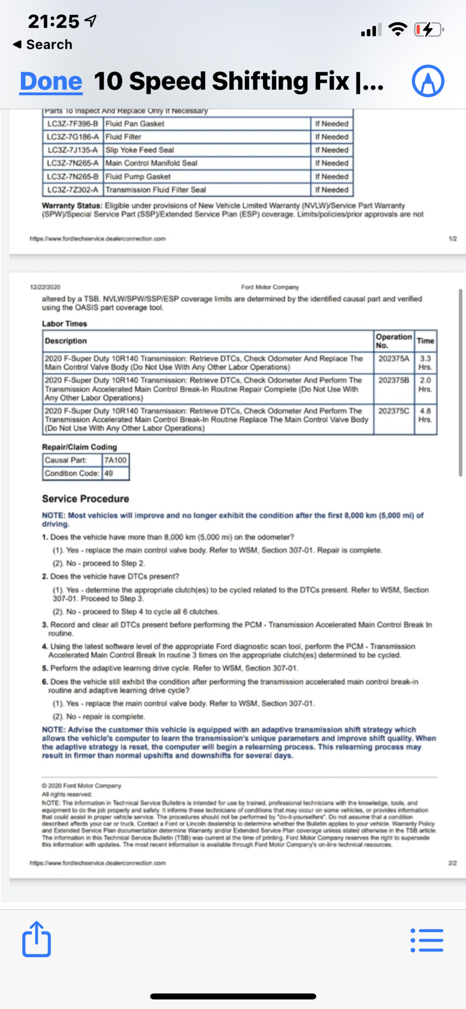

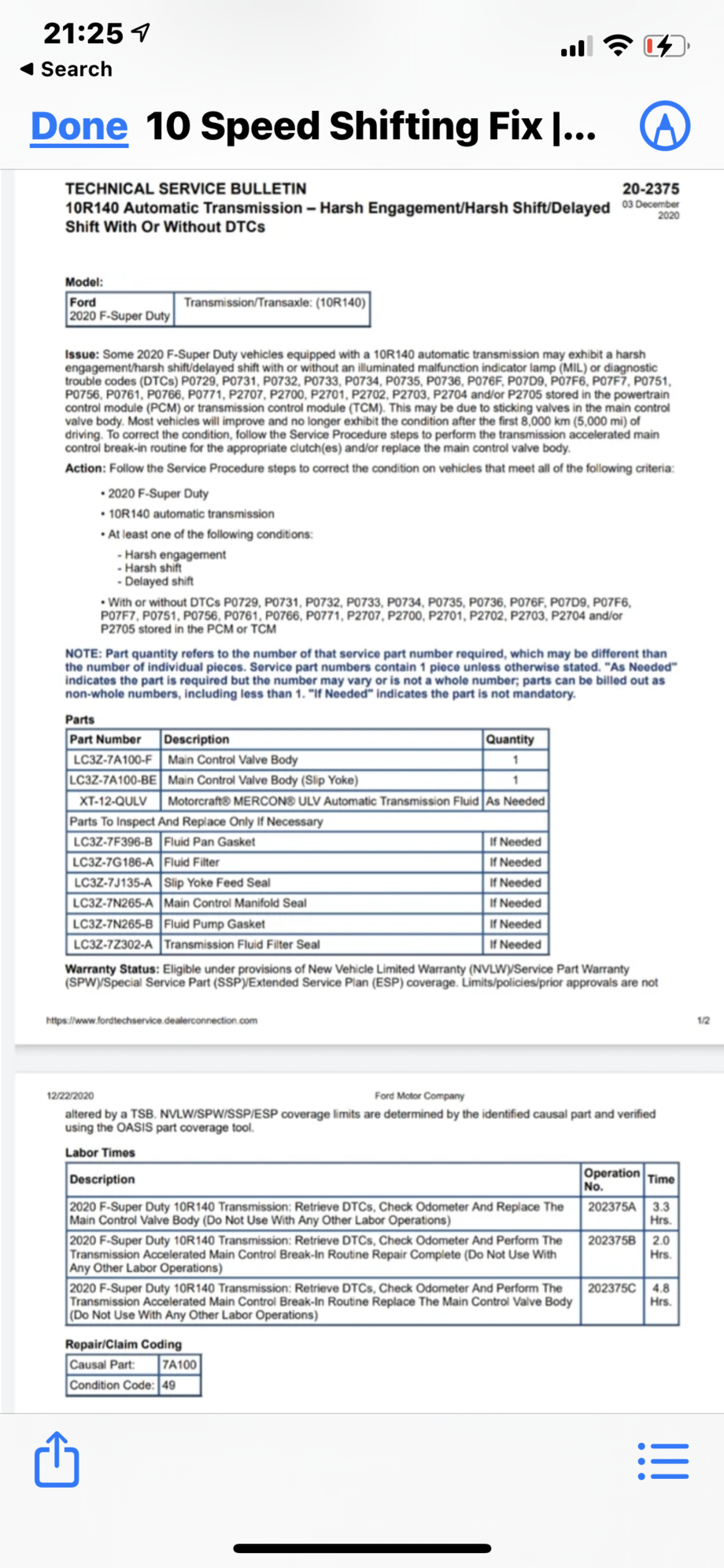

New TSB 20-2345 out addresses this issue

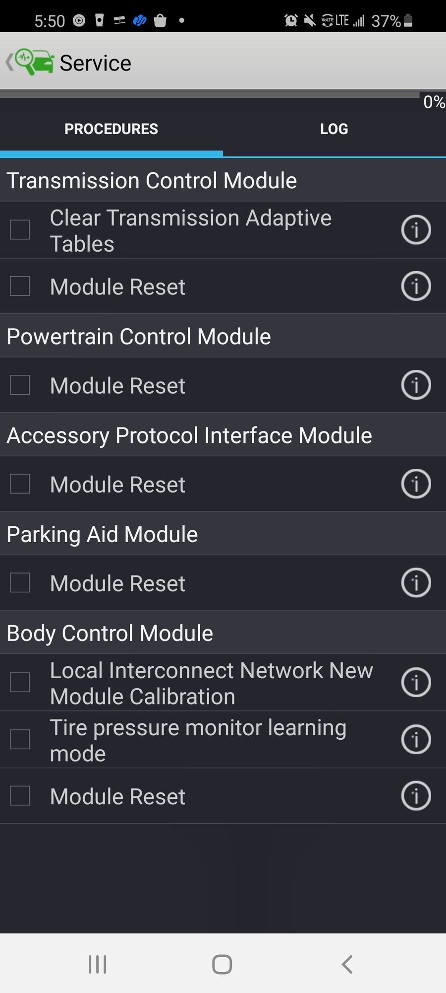

First and foremost disconnecting the battery does absolutely nothing. These trucks all use modules with non volatile memory. It's takes 30 seconds to reset with Forscan Lite. So if you don't want the 15.00 investment then go to the dealership and I will bet you will be time and money ahead going with forscan.

It doesn't really concern me but I'm curious. I didn't think you could do anything but monitor in Lite.
You can carry out the following service procedures in lite.
Thanks! That's good to know. Reps intended, apparently I've thanked you already somewhere else.
I don't have Lite on any of my devices but maybe I'll grab it just to have. I've used regular FORScan several times but had always heard that Lite was pretty much just for monitoring.
