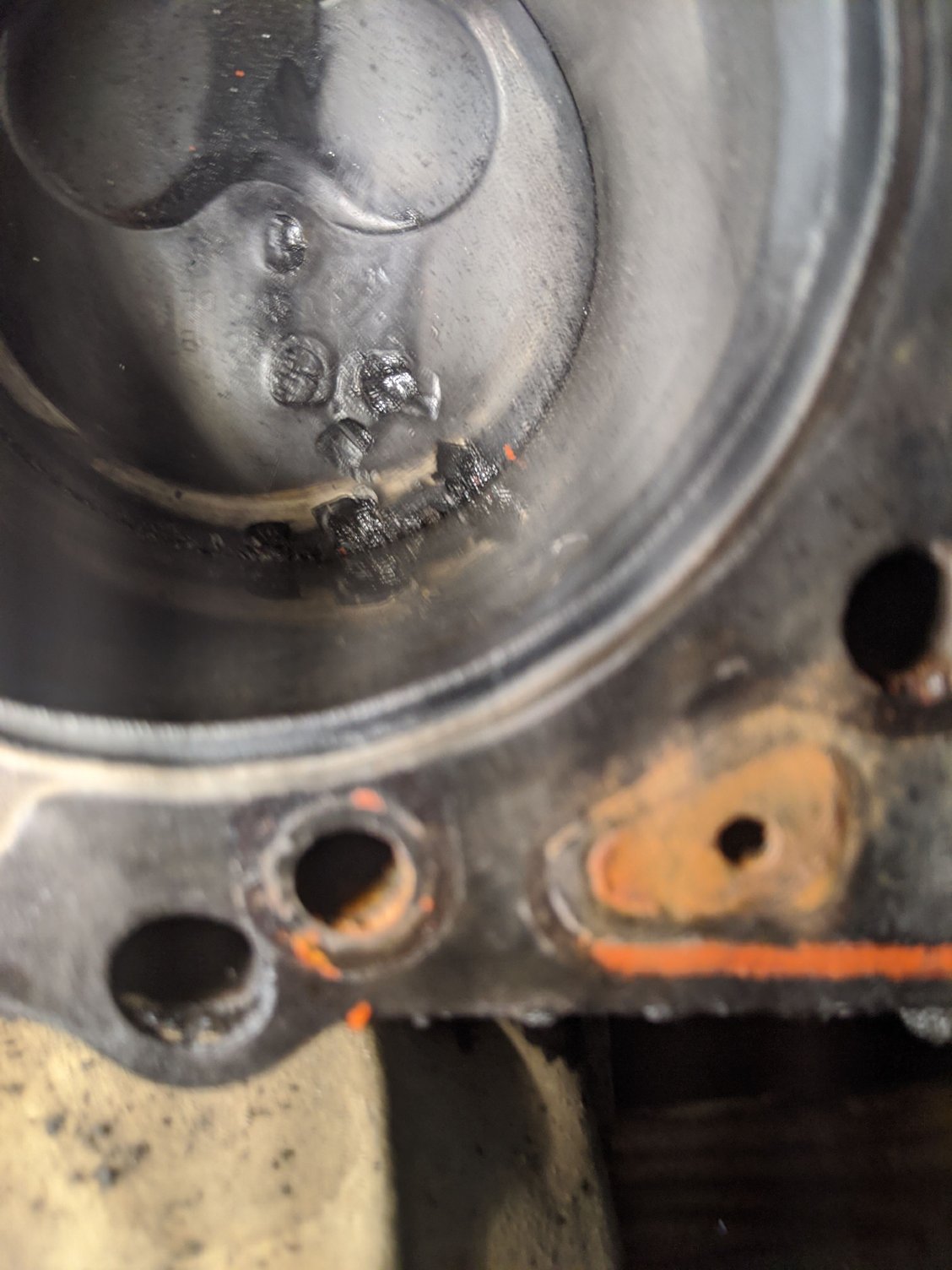

I know lonewolf has had really good luck out of his set of auto lite glowplugs, but every set I pull looks like this or worse...
Pulled this today from a customers truck, got lucky we caught it in time before it was unremovable or worse caused piston damage like this
^ motor I bought from a junkyard, it had another set of auto lites in it that were also swelling.

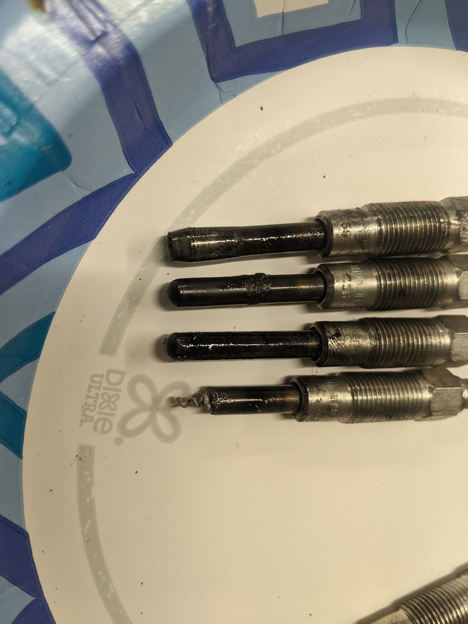

from the top 1357, 2468. This doesn't make me feel well... New Bosch plugs. None of them ohmed under 10k and half were OL. But two look like they broke.
Well S#-$T

I'll have to look into that. My main concern is that the tip of 7 is missing. These have about 15 seconds of run time.

15 seconds and they did that?
I would make sure your controller isn't sticking. Even the cheapest of glowplugs should last a week or two, definitely try to get a refund or replacement though.
I have a set of the Bosch plugs in the house that came from a uhaul with around 20k on it since the motor had been replaced. They were all good and still working and I kept them around for trial if I ever converted my 85 to zd9 instead of the ZD-1's.
All eight are obviously old but they're 100% intact and all get glowing hot.
I think either your controller is sticking or you got a dud set. Only real way to get the pieces out is pull the head, and that's if they're not already in the pistons.

I have a feeling the controller stuck. It was before I switched it to a button and that's probably why I was having some issues. Yeah, maybe 15-30 seconds. But if they found the piston looks like the truck will be getting the IDI ripped out and get a powerstroke sooner than I intended...

I wouldn't sweat it to be honest. My old motor when I got it most the glowplugs were broken on, a year later I had to do head gaskets and noticed several pistons had glow plugs imbedded in them, fast forward a couple years and I added a turbo and pushed quite a bit of boost on it vs a stock turbo one, eventually one did crack. But there's honestly no telling how long they were in there. The motor had 460,000 miles when I got it and the guy told me he used ether to get it going the whole time he owned it because they never worked.
If mine made it through that, id say you've got plenty of time to prepare for your motor swap.
