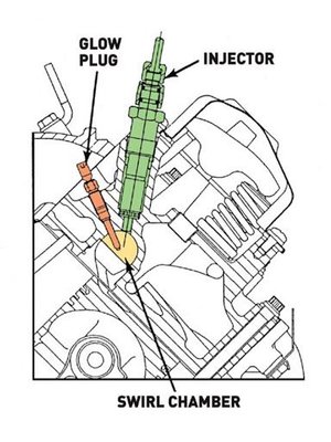

as far as the broken pieces you might put blankets over the heads and crank the engine over and see if those pieces get blown out.
if the pieces have already made it out of the pre-cup they may have already made it out the exhaust by now.

i read on here a guy used a shop vac hooked up to some hose and he was able to get them out that way too

you get a bit more access by removing the injector .... it's no easy task if the piece is side ways ... best hope is it is still stuck in the GP hole as the plug was pulled out.
anyway not a fun job.

Yeah I would pull that injector and use a shop vac on one of the holes and let the other flow air to hopefully pull the pieces out IF they're even still in there or free.
You can build a little catch can out of an old jar, drill two holes in the lid and stuff a 3/8" hose in each, works good to catch metal or fluids to see what all comes out.
