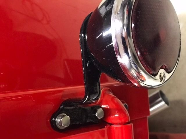

The hood on my 54 has a course thread nut welded in place in the hinge pocket. I bought the hood used this way. I am currently using a course thread bolt with a washer as you see in the picture.
Shall I cut this nut out and install a nutsert I got from Mid-Fifty? The nut-sert is fine threaded so I can use the correct fine-thread hinge shoulder bolt.
Will a nut-sert with stand the dynamics of the hood hinge movement? Has anyone else used this hood hinge repair kit on their truck?

I used nut inserts on the top hole in the bed stake pocket for the top taillight bracket bolts. I used an insert tool / inserts from Mcmaster. For safe measure I added two small tack welds to each insert to keep them from twisting.
JB

They also make two versions, which I didn't see anyone mention. They make flush mount, which is in Abe's picture and they also make a shouldered one, which I feel is stronger but will not work in all applications. Ford used them factory on Mustangs and other models for holding steering components, so yes I trust them.
