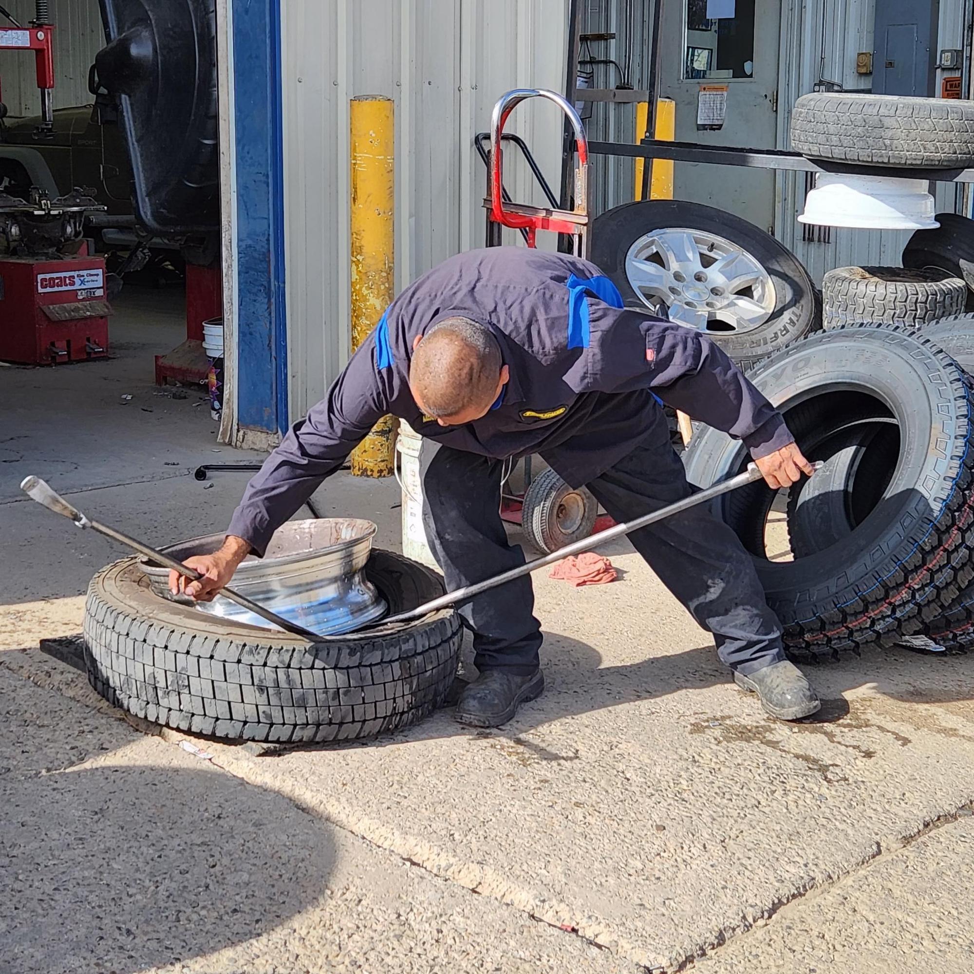

Sounds reasonable. The tire shop's machine could not mount them; they used bars. This is not one of those national chain shops; these guys service all kinds of big trucks and buses. The manager told me that big truck tires were much easier to mount than 19.5's.
