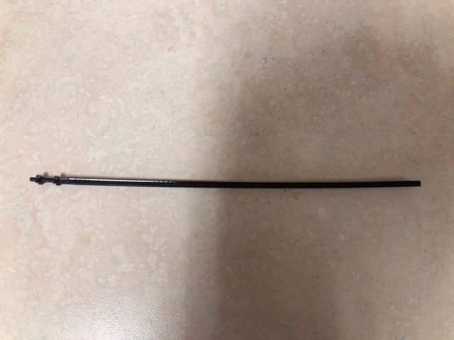

I ended up removing the extender and it is indeed a 7.5" Air-Flexx extension. I tried the inflate through cap on my pickup and it works just fine. However, I don't see how the Air-Flexx extension can even work correctly. When I shake the extension, I can feel the innards sliding from end to end, all as one piece. Think of it like I had a closed cigar tube with a metal bar in the closed tube and it would slide from end to end when shaken. The 'innards' of the extension have right around 5/8" of travel, which seems too much. I'll attach two photos which illustrate my point. When I use a paper clip to push the valve side all the way in, the cable supposed to push the Schrader valve at the other end just barely is long enough to extend maybe 1/32" past the end of the extension. At this point, the paper clip on the other end is about 5/8" into the extension. It appears that screwing the extension onto the wheel valve stem does not push the 'innards' far enough back up the pipe, so to speak, to let the air gauge touch it. The Schrader valve on the end looks like it's still recessed a good 1/4" from the tip. There's no way the gauge or air chuck can reach the Shcrader valve to push it in. To me this appears to be faulty construction. I should be able to simply screw this extension onto a tire valve and then use an air gauge right as it sits, with or without a flow through valve at the end. I would leave the wheel as is now but cannot get an air chuck on the inner rim. The wheel simulator holes appear to cut off about 1" of travel vs the regular wheel and make it just impossible to get the air chuck on straight. sigh...

This is what I suspect I'm going to find is the case with mine as well. Just eyeballing it when I received it I immediately thought the inner cable that engages the valves is too short to work.

They’re re actually 7 1/4”, not 7 1/2”. I measured wrong. Amazon sells 7 1/4” length.
Here’s a pic of the stems.
I actually found a solution from Amazon. Apparently we’re not the only one to experience this problem. The solution is easy…just cut off the very end of the extension with a hack saw. We took off two threads worth of stem and then we can press (hard) and get an air gauge to work and a pressure chuck to put air in. I might sand down the end just a skosh more to make it work easier but the fix is in. Lopping off the end apparently took an inner lip out that held the valve/cable in the extension body but since we have a flow through valve on the end that didn’t prove to be a problem. Thanks to all for helping out. For those interested, I’ll post a pic of the actual inner valve/cable.
