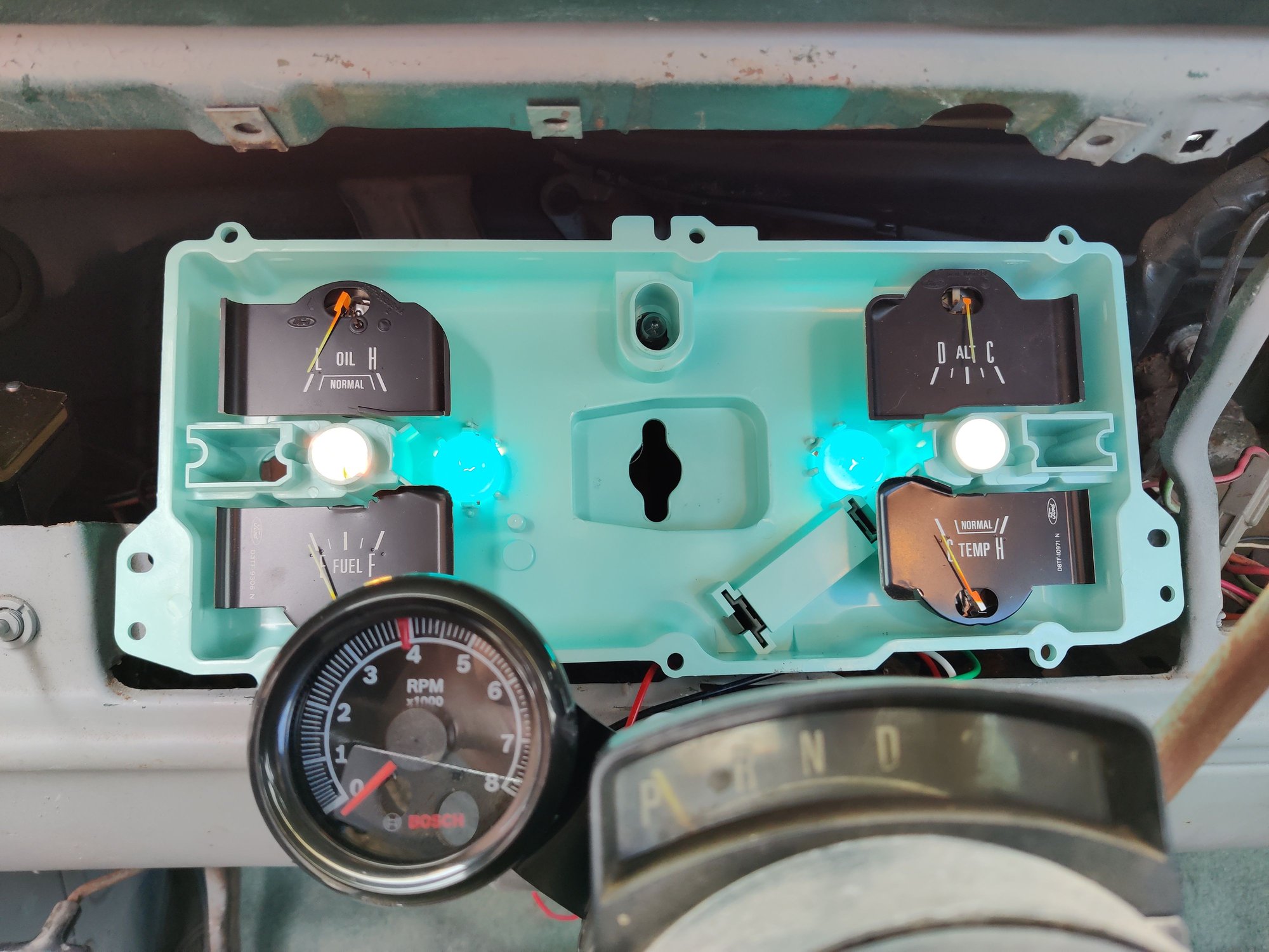

And the saga continues...got my parts in. I got a cheap Amazon seat cover, seems pretty nice, but I forgot to take a picture of it. I think I need to fix some of the tie downs anyway. Biggest success today though is that FINALLY I got rid of the stupid blue LED strip and put in a proper OEM dome light. Now I can actually see inside when it's dark and it doesn't feel like I'm in a rave. Replaced the headlight switch and now most of my interior lights work as expected.
I did hit a snag though, I replaced the crumbled plastic gauge holder, but the black washer looking thing in the picture isn't the kind that can be moved to the new one (and it crumbled when I tried). I'll have to find that piece or some washers so I can mount the speedometer. And the bulbs in the gauge cluster still don't work. The little printed circuit board looks OK and I tested it with my multimeter to make sure when the bulb was in the socket it was making good enough contact for continuity. So I don't know what it could be, none of the lights work like the blinker, warning lights or illumination lights. The bulb that illuminates the washer and headlight switch IDs work and the bulb that went behind the HVAC works.
My guess at this point would be an issue with the harness...I guess I need to figure out which pins on the harness plug correspond with the illumination lights and blinker to see if I can wire a bulb to them directly to test. Unless anyone has better ideas. So still without gauges at least until I can get the speedo mounted, and without gauge lights until I figure out what the problem there is.

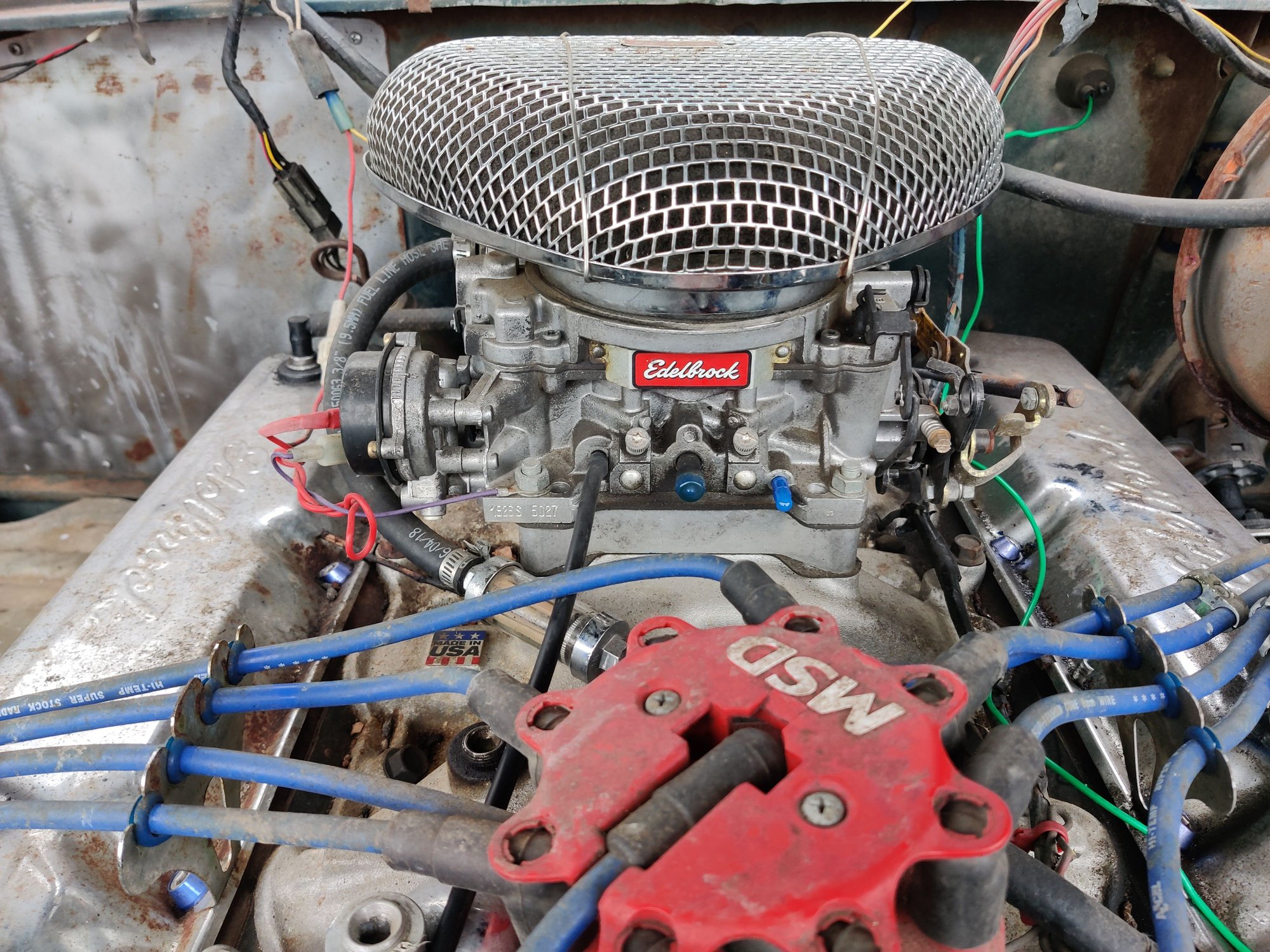

Continuing with another day of work on the truck. So as I was reading about the Edelbrock carb and how to hook it up/adjust it, as well as how the vacuum ports work, I realized the moron PO plumbed the distributor vacuum advance to both the manifold and ported with a splitter, which basically disabled the vacuum advance and created a vacuum leak. If you look at the picture of my engine bay in the first post, you can see how it was plumbed, so basically the manifold vacuum would suck air from the ported vacuum, so there would be very little or no vacuum applied to the distributor. It explained the high idle for sure...fixed it to where now it's on ported vacuum. I don't see how it could have possibly worked before...maybe they didn't care about the high idle?

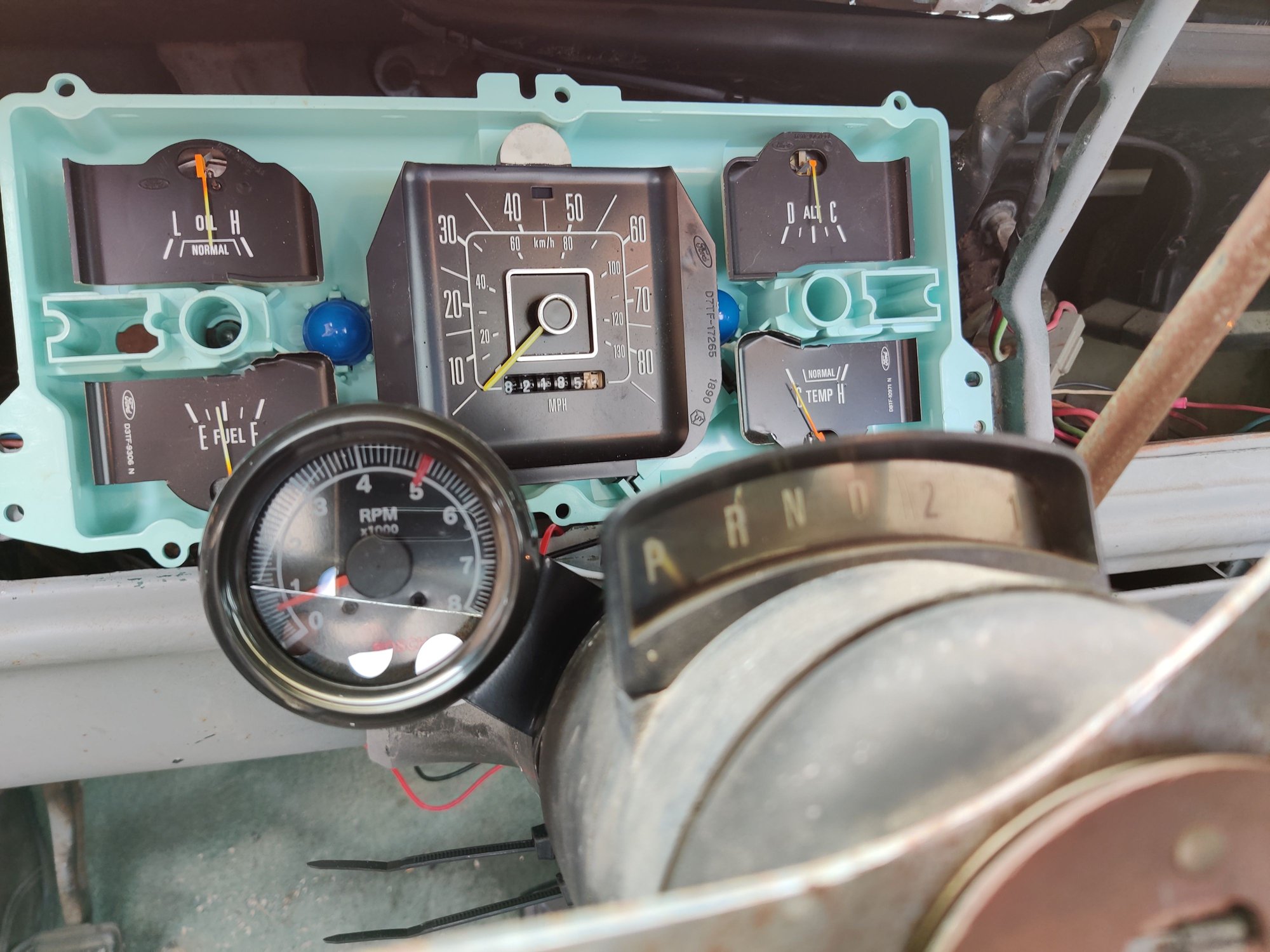

Anyways...I also added a tachometer so I could do idle fuel/air ratio and just see the idle. Right now I've got it attached with zip ties to make sure that's where I want it permanently. Before I fixed the vacuum ports, it would idle super high at 1500, after the fix it was still a little high at 1000. I realized the throttle is a little sticky and won't close enough for the idle screw to do anything- but i was able to work it a bit to get it to go down. Then did my adjustments, it was running ridiculously rich before. Now it's properly adjusted, it's idling at a cool 500-700rpm, and hopefully will use a bit less gas. Using a vacuum meter, nice steady needle in the green zone.

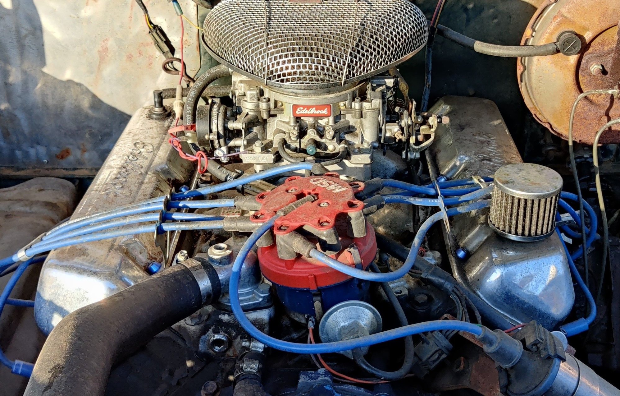

Also, I realized all the vacuum lines are run weird, notice the PCV port on front is capped, on the back of the carb there's a splitter from the brake booster port that goes to the crankcase and brake booster, though that seems like it will work and seems a bit more reasonable since the crankcase hole is in the back. Something tells me whoever installed this carburetor had no clue what they were doing and didn't bother to learn...I figure at some point I'll just take it off, rebuild it, and reinstall it properly from scratch just to be safe. I'm sure the rich running means the spark plugs probably look awful, and I also know I should probably do the timing as well, that's going to be on my list next week to check the plugs and timing, will have to buy a timing light. But just from what was done today, it runs a lot better, even though it was already running alright before.
Also figured out my electrical issue with the gauge cluster lights, basically the little sockets weren't contacting the circuit board well enough. After some pin bending and wiggling while testing with my multi-meter, I got all the lights operating properly! Now I just need to wait for my speedometer head gasket to get the dash put back together. Only hiccup is now my temperature gauge doesn't work, it was a little flaky before I took it apart, basically wouldn't read at all until I drove around a bit even if it was at a normal temp, now it won't read anything at all. I should probably just get a new circuit board, but I'm budget-limited so hoping I can just work the contacts enough to get it working.

Nice little tachometer, super easy to install.
we have lights!
notice the vacuum lines joined by a splitter before going to the distributor.
properly plumbed vacuum advance.

Run the brake booster directly to the intake. The PCV valve is supposed to go to the center port you have a cap on, on the front of the carb, under the Edelbrock name.

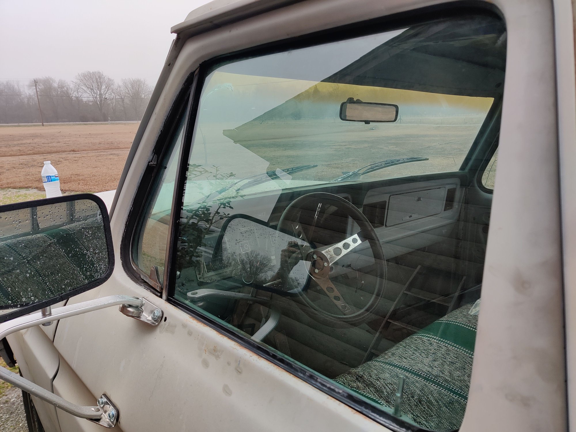

One thing that has been driving me crazy is that the windows rattle around because of the missing rubber channels & weatherstripping, not just because of the sound but because I was waiting for the day the fatigued glass would finally just explode as I was driving along. Well no more! Got a kit on RockAuto and replaced everything...I can see why the lazy PO didn't do it, because it's quite a hassle to get everything aligned and working. I had some trim tools and the forethought to get some dry spray lubricant. Everything is nice and snug now! The only problem is that I can't roll down the driver window because the rubber retainer on the lift is long gone...it lifts just fine but there's nothing to pull the window down. Not a big deal, since I don't have door trim panels anyway should be easy to install some.
Also bought a scraper and finally scraped off that awful blue tint on the rear windows. It was so bad it was basically fogged glass, I'd have to have the rear window open just to see behind me. It looks like they applied two layers of tint for some reason...let's just say I hold whichever PO that abused my poor truck in very low regard...

New channels & weatherstripping for the glass
No more goofy blue tint & decals, I can actually see behind me!

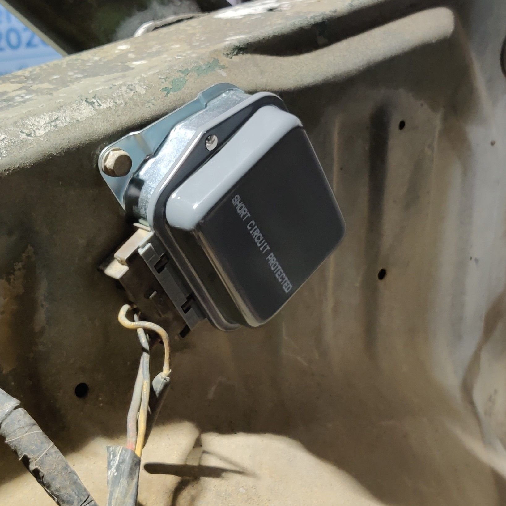

So tonight was fun, after work I was driving the truck down from my inlaws (about 30 miles away) to do some work with/on it this weekend at my house. It died a little over 2/3 of the way there, in the middle of the road. Thankfully I had my wife following me to put her blinkers on, and a police officer pulled up to help out too. Battery was completely dead, and my Jeep just didn't have enough "oomph" to jump it to get it off the road...to make a long story short I paid $140 to have it jumped by a wrecker (the "police called me" rate...), he was kind enough to sit for nearly half an hour to let the battery charge up enough to make it the rest of the way home rather than just hook me up and tow me for $500. Made it home and tested to find out the alternator is definitely not charging.
Which kind of was unexpected...now the last few starts I did have some trouble getting it started, it was cranking a bit slow, but once it started up it was fine, and I had driven it around quite a bit. It must have gone 40+ miles on just the battery! My best guess is maybe the alternator was intermittently working...because when I went to have it tested months earlier the guy at Oreiley said it was fine and charging.
So that's the weekend project now I guess, gonna take the alternator off to get it tested just to be completely sure it's the alternator and not some other electrical issue. Never a dull moment with this truck I guess...

It might be your voltage regulator. I put a new alternator on mine and found out my voltage regulator was toast. It essentially tells your alternator when to kick on. I would also check your fusible link between the alternator output to the positive side of the starter solenoid.
We have a winner! Got out there this morning to start doing tests, sure enough doing a jumper on the regulator plug and the battery would change. Got a new regulator, did the trick. I'm going to call it my $160 voltage regulator...between the cost of the jump and the actual price at the parts store. I guess as a side note now I know my ammeter on my dash doesn't work at all, needle doesn't budge even though it kind of looks like it's on the "charging" side.
