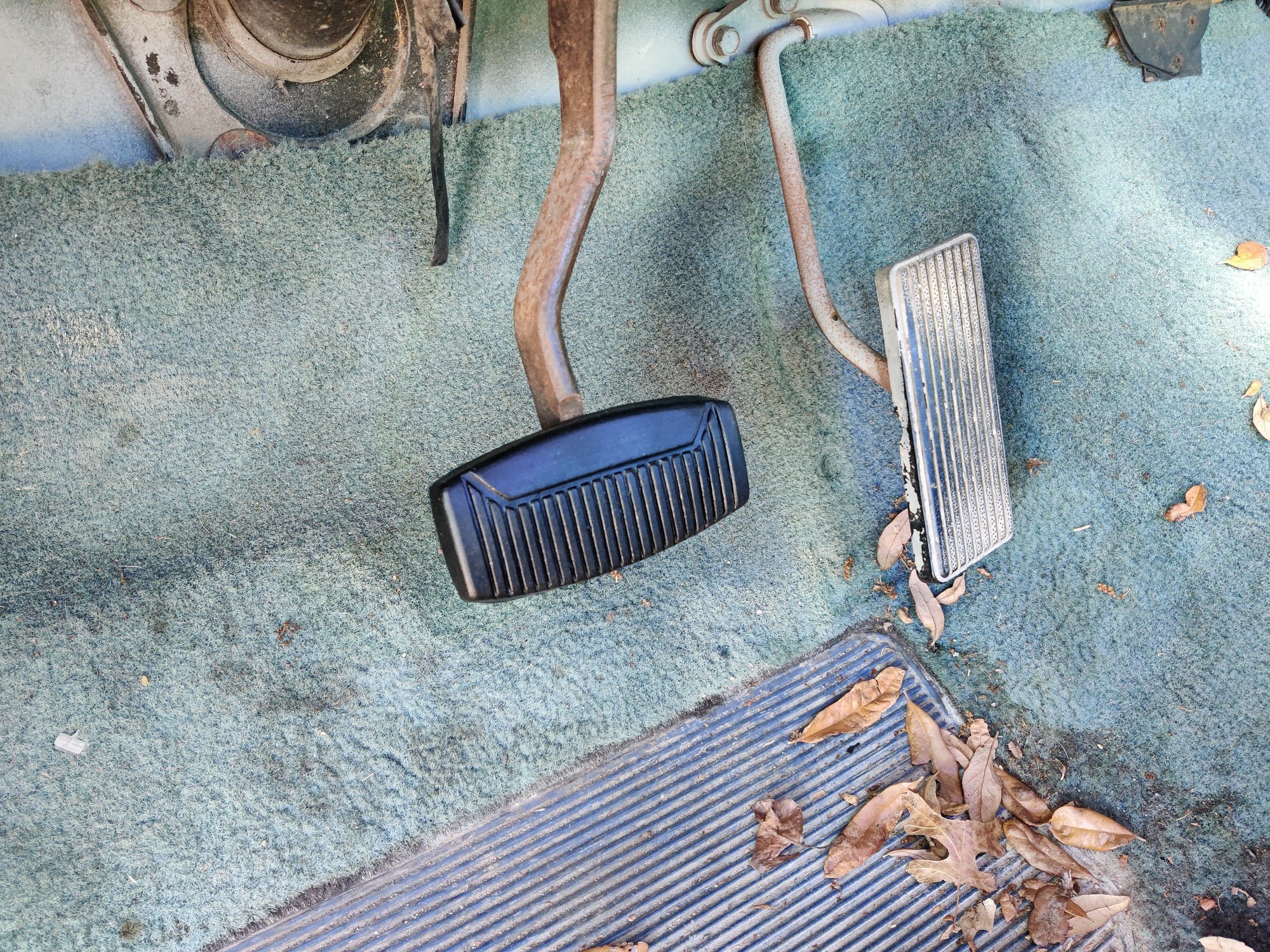

While I was at it I decided to take care of the brakes, another common job I've been told is very easy. After replacement the pedal feels better, but stopping and pedal travel doesn't seem to be any different...maybe I put it on wrong? It did only take 30 seconds rather than the hour or so I thought it would take, let me know...
They told me I needed to replace the pads...I could only find this one pad?

Those pedal pads? Ford used those for decades! They were used in the 1980-1996 OBS trucks, and I think they were used in later F-series trucks too! I believe that pedal pad design goes back to the early 1960s!!!

I wonder if they didn't mean brake pads.

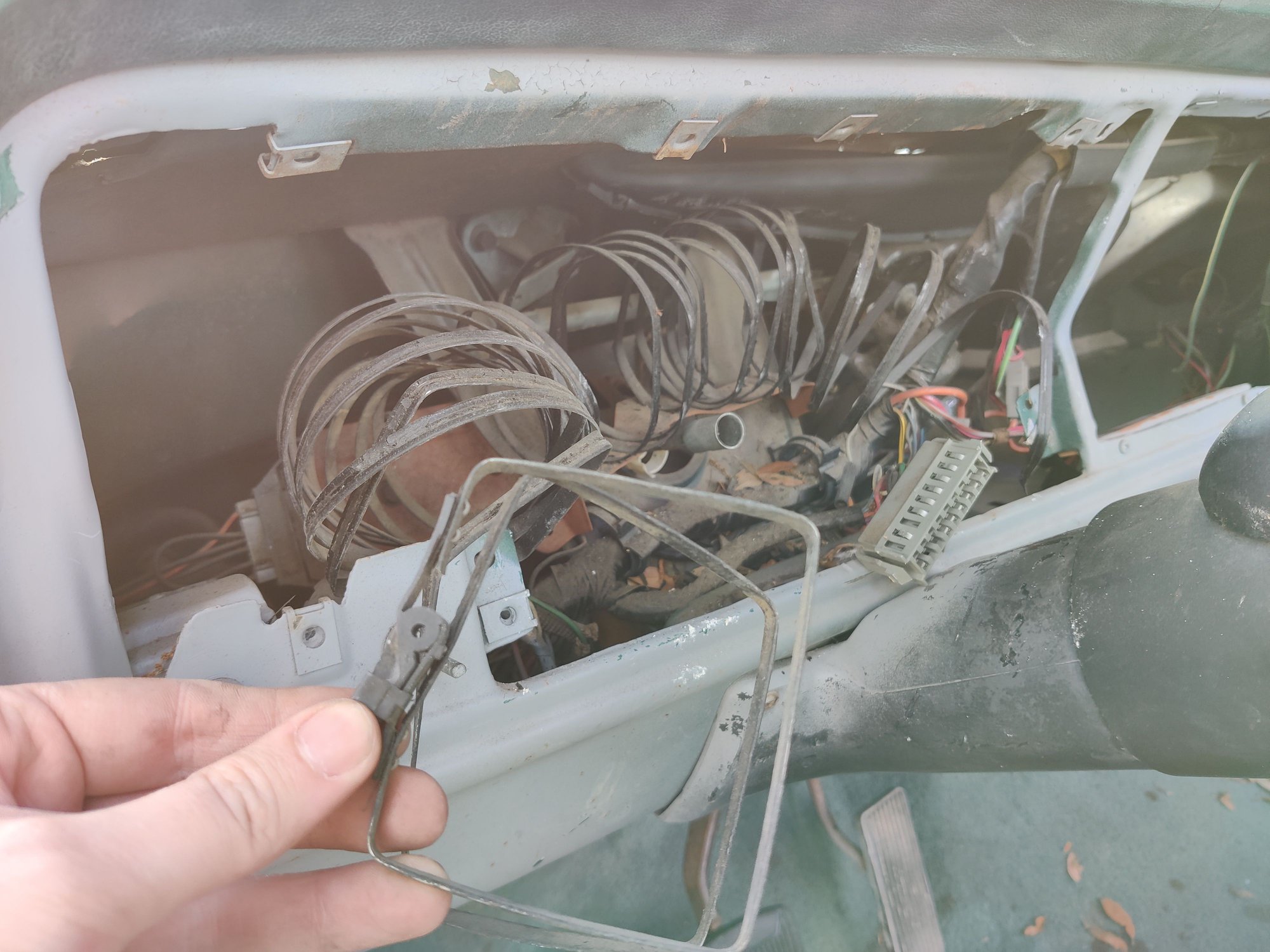

So went to look at the wiring, and hopefully figure out why none of the interior lights work. Checked the fuses, all were good as tested by a multimeter. I messed around with the headlight switch, and figured out that the interior lights actually do come on when I twist the switch to the "click" position where the dome light comes on. I even was able to get the lights on in the "dimmer" range, but not consistently. I'm guessing maybe the switch itself is bad, upon inspection it looks like a replacement, with a "Made in Taiwan" sticker. Though there were still no lights in the gauge cluster- just random lights from the missing hvac and the transmission gear indicator.
Went to take the instrument panel out...and it basically disintegrated as I pulled it out. Don't think I've ever seen what looks like plastic get so brittle and crumble so easily...not only did it shatter in places, it grinds down to powder. So all the gauges are functional, and the printed circuit board looks to be in decent shape, so my best guess is that the bulbs aren't making good contact because of how the plastic has worn away where the bulbs contact, not to mention a few are missing. I found replacement plates on LMC, so I guess I'll get one of those, and reuse the printed board and get new bulbs.
Also I discovered evidence that the truck did have A/C at some point- the remains of the driver-side A/C duct. All that's left is the metal frame, the material that it would have been made out of was completely gone. So I guess someone replaced the original bezel as @four-sixty-power noted earlier.

Looks exactly like my '78 behind there. The Texas sun does no favors to all the plastics under the dash!
I'm going to go with one of the retrofit kits and totally replace the stock stuff because I can't find original flex bits anywhere.

We got a back panel from LMC and are happy with it. FYI the cheapo LED bulbs work in the cluster. I did get some genuine Sylvania 168 bulbs for the two back lights for a little more light at night. The Sylvania's are about 7.00 a piece, while the cheapo's are much less and can be used for the side marker lights too.
Check the bulb above your wiper/washer and light ***** to see if it is good. Also the one behind the climate control. They are odd ones. I don't remember the numbers off the top of my head. I can look it up in my manual if you need me to.
I just ended up just picking up a bulb kit from HiPo Parts Garage Been real happy with them, and no spending a bunch of time trying to figure out what bulbs I needed. Probably paid a little more than I had to, but it was worth my time.
