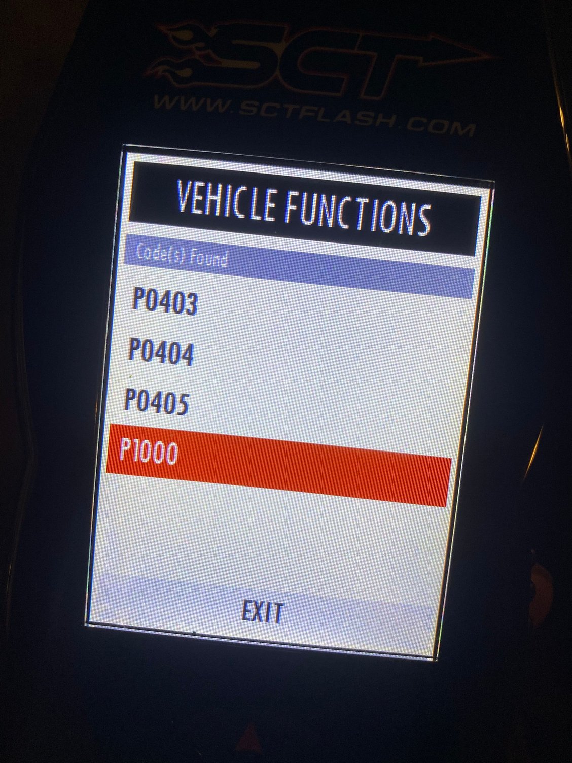

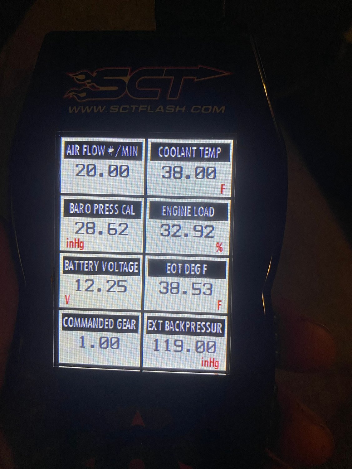

Do uou have a scanner/code reader? Do you have any Dtcs ? Post some readings.

Just started it up then put the scanner on.

Those codes are egr delete related. Not the problem. You might look in to checking the pressure in your degas bottle. I think there are write ups in the tech file on how to correctly do it.
Do you have white puke on your degas bottle.
