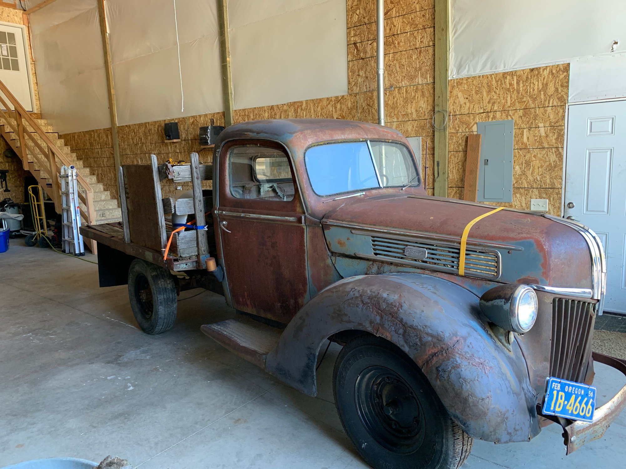

My name is Craig, I was pretty excited to find this forum as I have recently brought home a 1941 3/4 ton truck. Only to learn that info on these trucks are hard to find along with parts.

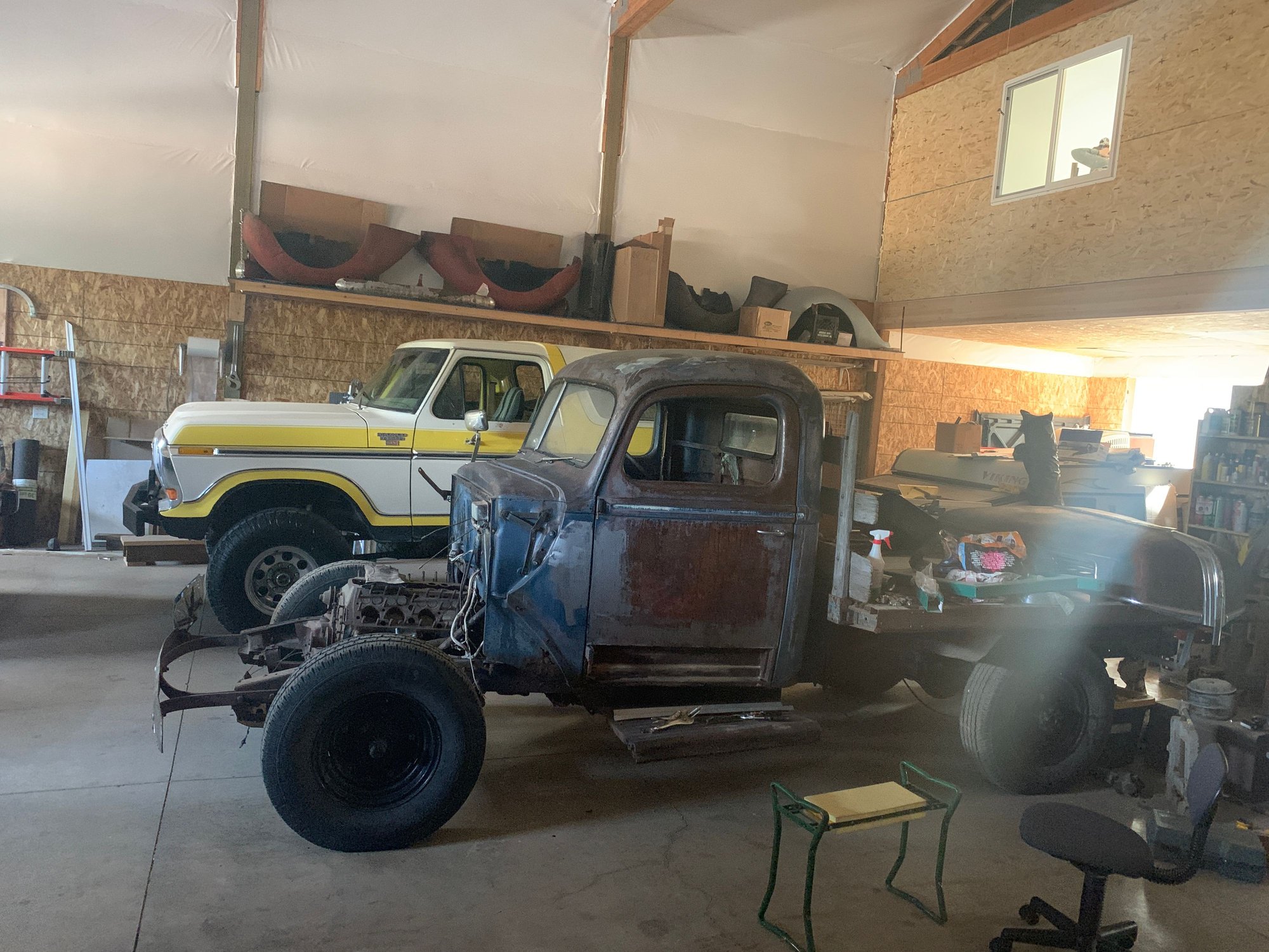

my current plan for this truck is to build an 8ba engine coupled to an AOD, upgrade suspension (so the truck is fun to drive and I don’t have to stop to pee every ten minutes) other than that restore it to her formal glory.
Craig

Welcome to FTE! Nice truck to start with and thanks for posting pictures.
Some unsolicited thoughts (feel free to ignore these):
I like 8BAs, they are the best Ford flathead V8s.
I recommend doing a lot of measuring before going AOD, they are a lot bigger than the stock transmission. In addition to the frame mods, it also takes up floor space, which isn't plentiful to begin with.
The suspension can be a lot smoother than stock simply by cleaning up the springs and removing a lot of the leaves. Not having to reengineer the suspension is a huge time and money save. This also preserves the factory steering which is actually pretty good.
One thing you didn't mention is the rear axle ratio. The axle is a good strong unit, but is almost guaranteed to be geared like a tractor (4.88 ratio). I personally really like the wide five wheels and 3/4 ton hubcaps. I can think of two possibilities in order to retain those and get a higher speed rear axle. You can re-gear the stock axle to 4.11 with an available kit from Chuck's Trucks, or with a bit more work you could swap in a 42-47 half ton pickup axle and install 37-39 Ford rear drums.

Thank you for the ideas. The AOD is more so my wife can drive it. I will have to look to see what it will take to install it. As for gears, I was waiting to see what tires and rims I decide on. Was talking about lowering the whole truck 2” or 4” but not totally sold on the idea. What is wrong with the mustang II suspension? Was looking into that option. The truck will be converted to 12V since it has to be completely rewired.
As for the 8BA, an upgraded dizzy is already in the plan. The engine came with EAB heads. The block is being bored to .030 over. Have a Max1 cam. Keeping the ford crank because I don’t know if the pistons that I purchased will allow it. The pistons have a compression height of 1.763”, I believe factory for pistons have a compression height of 1.519”. Then again I my be reading into it to much.
