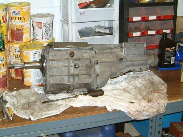

This is my rebuilt, with hop up parts, WCT5 I installed in my 70 AMC Javelin.
Posi stop shifter. You can get different sticks to work in trucks.
