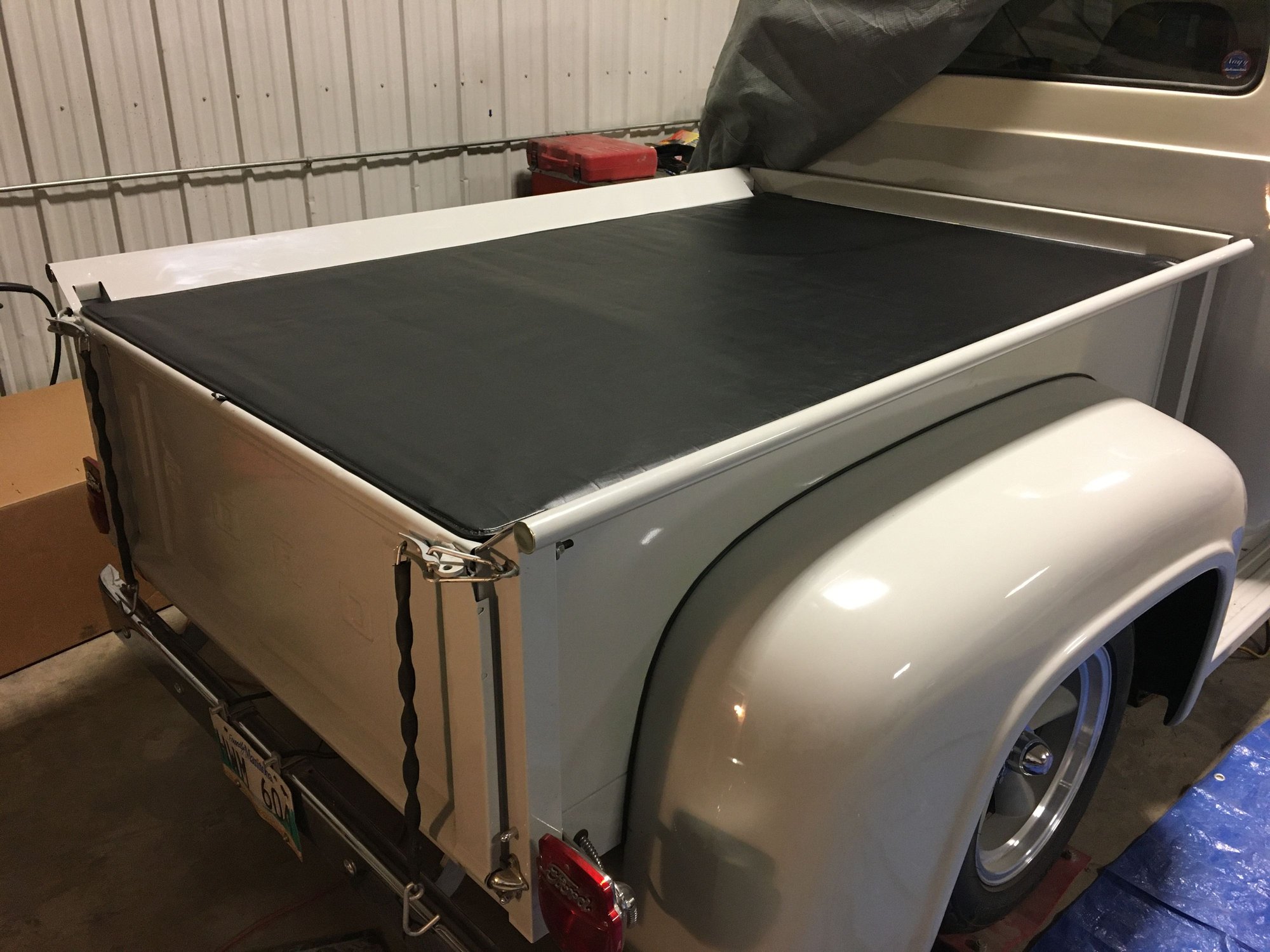

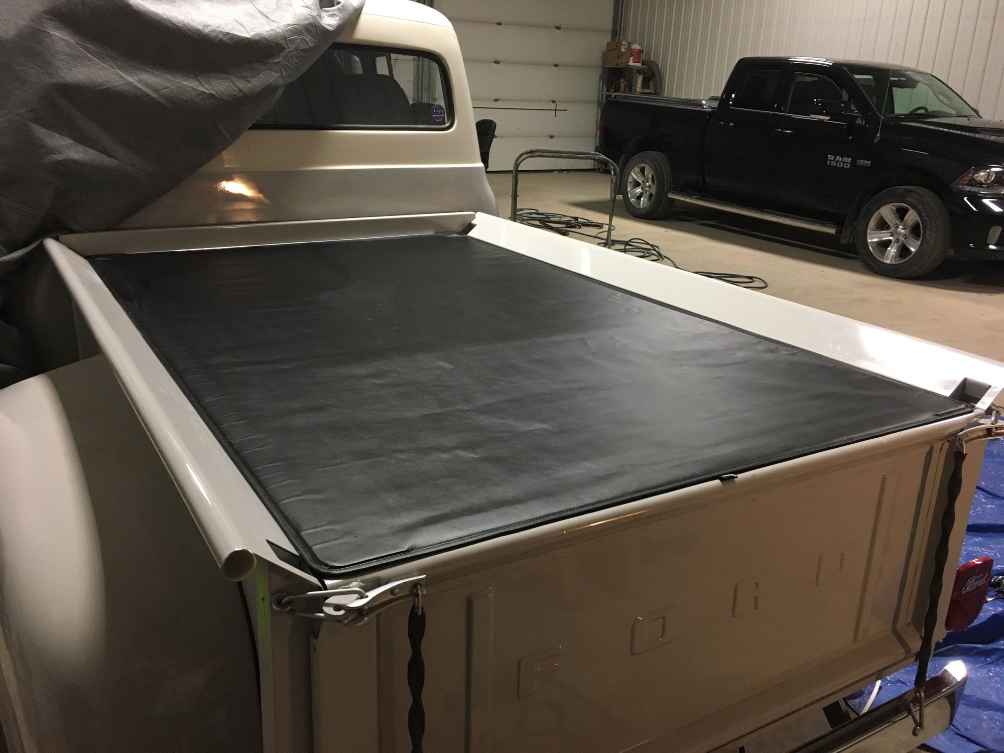

Well it is installed.
It latches better with the tailgate closed as my box spreads a bit when the tailgate is open.

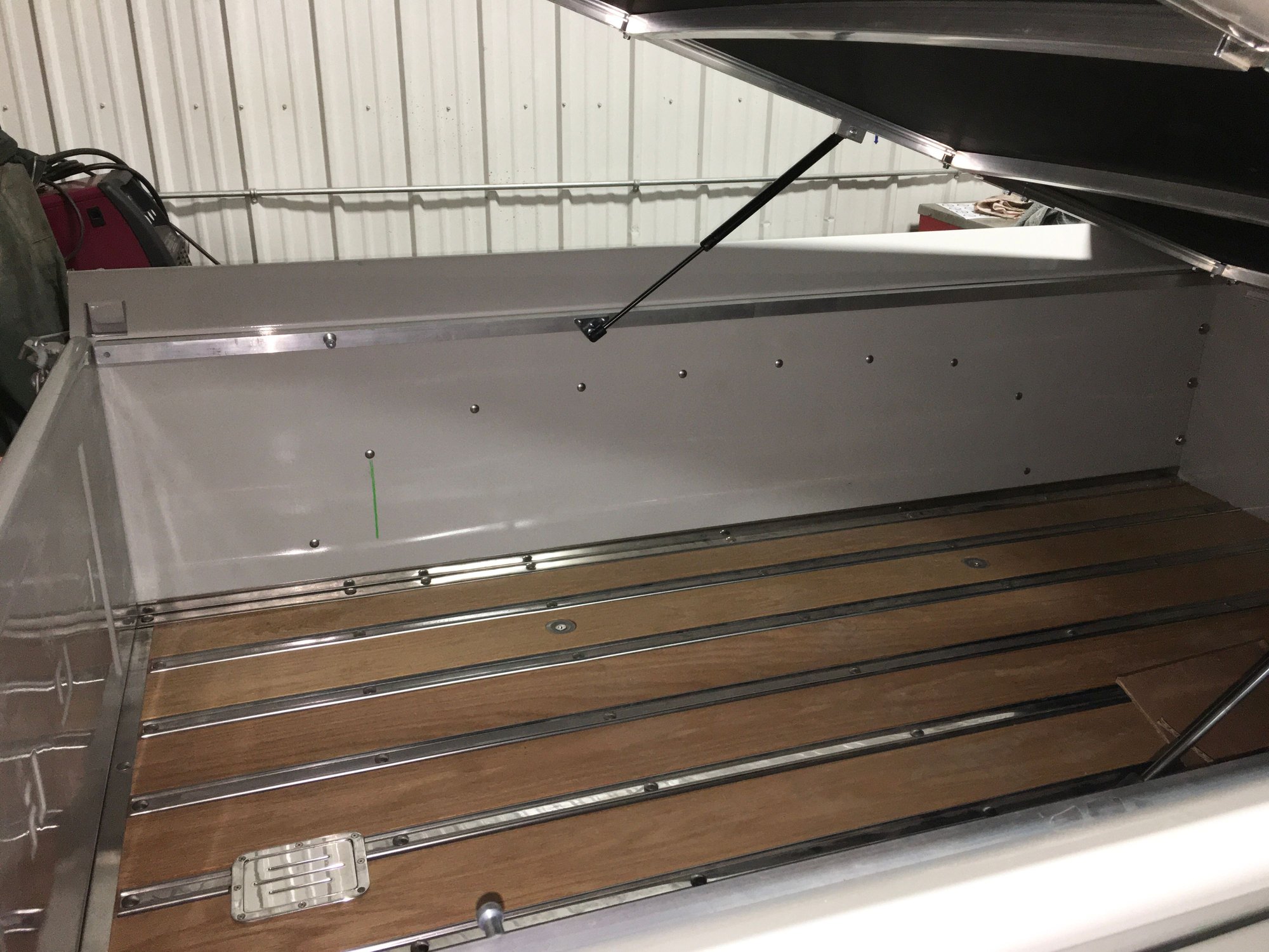

more pictures... inside with the rails and such please
j
Old Apr 17, 2021 | 05:27 PM
F100wish's Avatar
F100wish
Joined: Feb 2017
Posts: 490
Likes: 33
From: Winnipeg
Very similar to your earlier photos in this thread, but will do next time I am out at the truck.

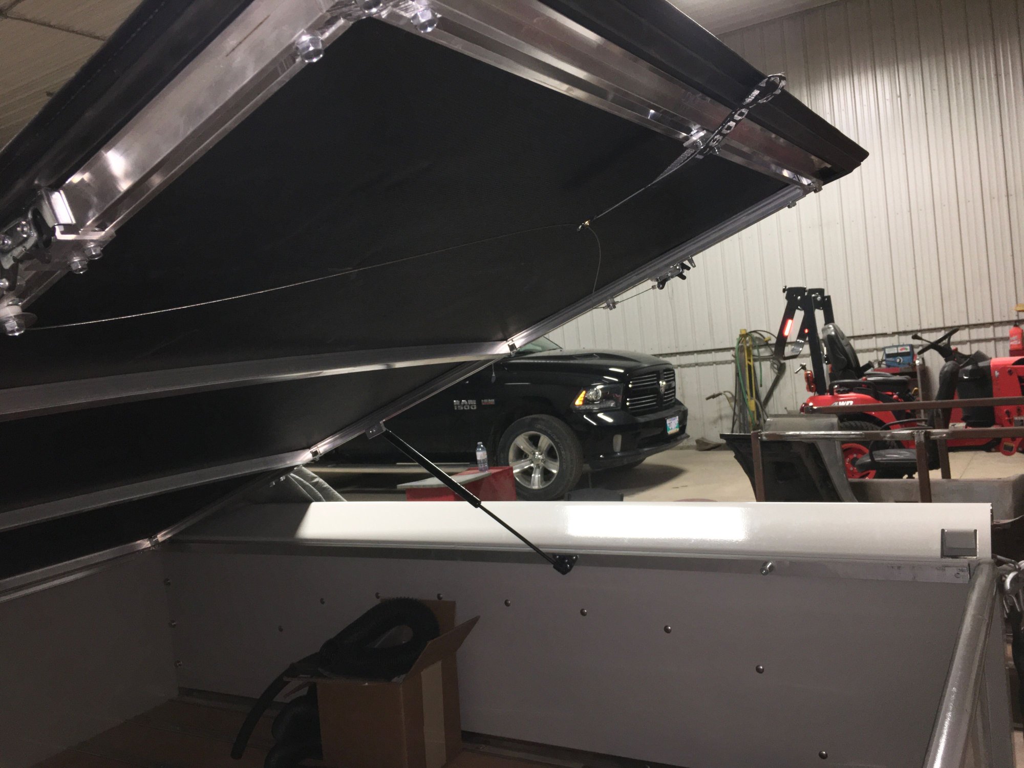

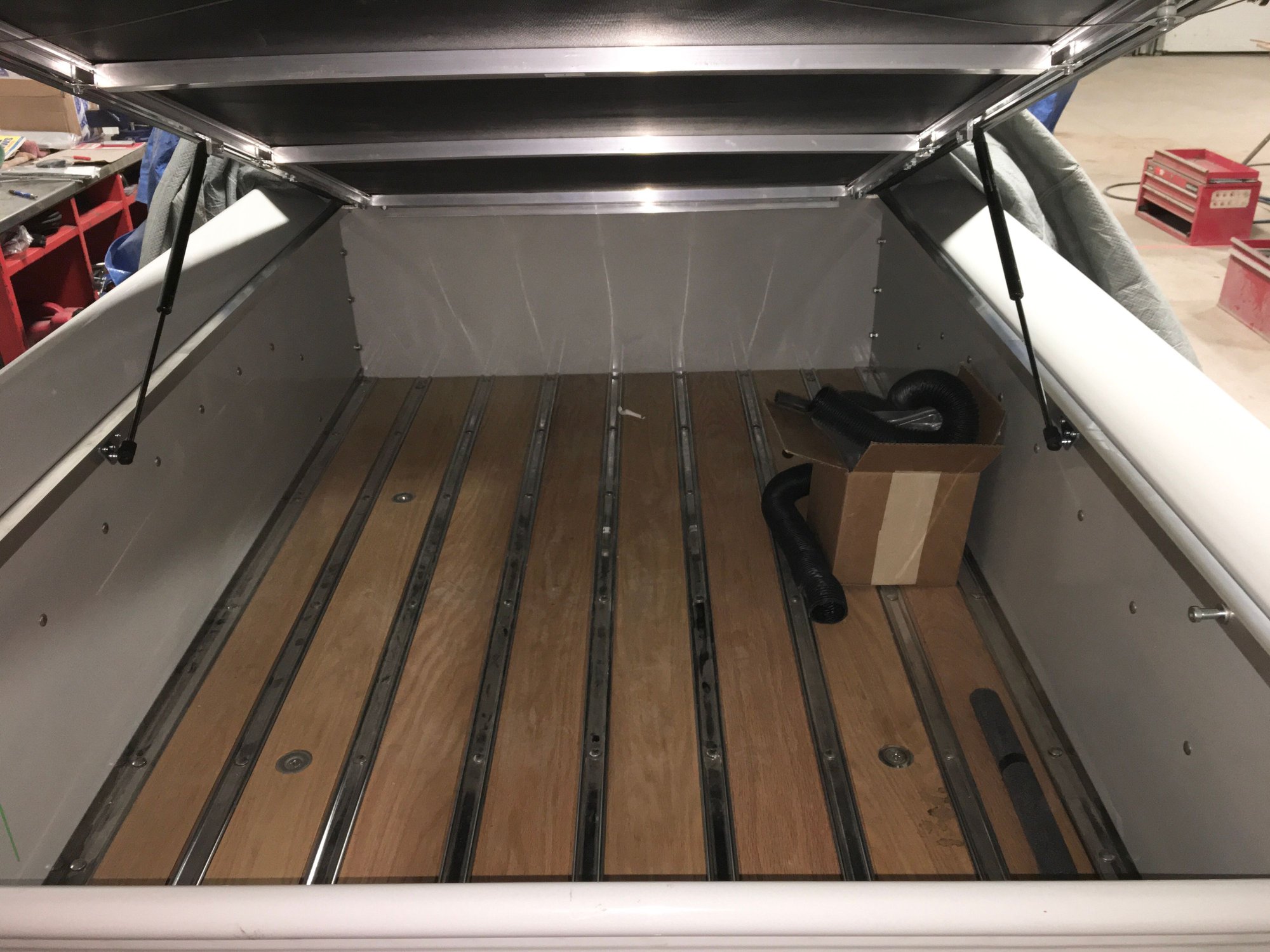

Inside box pics of Craftec tonneau cover, as requested.

Install is not bad at all, did it by myself. The wire guide pin .... make sure nylon washer is not IN track but on top of it... took me an hour to get them out without dismantling the whole thing, I also located the side and front support rails in the box with the screws first (and test fit the cover and locking mechanism with release cable) before I peeled the self stick pads cover, you won't be able to move it if you screw up. When I was happy the lid closed and locked then I undid the screws just enough to be able to move rails away from the box and peeled one corner followed by the whole length of the rail and press into place then tighten screws.
In this pic you can see the wires going to the side of the tonneau and they slide around the white nylon washer then attach to the lock mechanism. Make sure these are showing like in the picture before you insert corner pieces and tonneau top.
