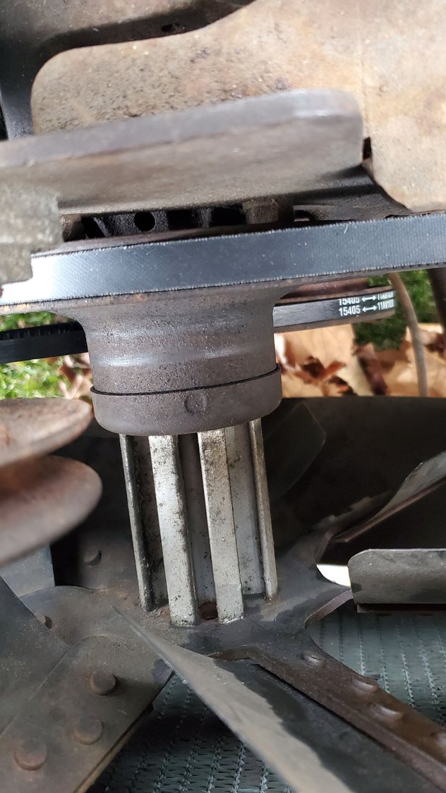

So I decided I'd try to take the alternator off by taking that forward, upper mount off and sliding the alternator off the broken bolt, but the water pump pulley is in the way of one bolt, and mostly in the way of the other. I took the fan shroud bolts off, and that gave me enough room to get the fan bolts off. The problem now is that I can't get the fan spacer off, which I assume needs to be removed to take the pulley off. The fan is stuck to the spacer, but I imagine that could just stay stuck. Any tips on how to get this off? I'll attach some pictures.
Fan bolts off.
The spacer connected to the water pump pulley.
The upper mount bolt, behind the pulley.
Lower mount bolt (covered in PB Blaster)

You must not be reading the reply’s. The alternator is not going to just slide off of the bolt no matter what you take off. The bolt is STUCK in the alternator itself. That’s why everyone said to drill holes in the area YOU circled in red and let the penetrating oil do its job. THEN try and slide the alternator off of the bolt. You are going to end up putting a hole in the radiator and them have another mess to deal with!

I did read them, which is why I'm taking the mount off, which is why I'm trying to figure out how to get the pulley off, which is why I'm doing all of this before I cut into the alternator. Can't slide the alternator off with the mount in place.

If you are good with tools take a sawzall and cut right behind the front mount. If you have to cut into the alternator housing while cutting. Then do the same at the rear right in front of the spacer. Again sacrifice the alternator as you cut. Then pull the alternator out, remove the spacer AND if the the group is right put a pair of vise grips on the bolt and finish taking out.

I hear what you are saying that fan assy has to be removed even if you were to cut the ALT mount. Also how do you get the new ALT on?
If you have not done so place some large card board between the fan assy. And the radiator, more layers the better..
If you have all the fan bolts out use a rubber mallot or dead blow hammer and tap on the extension.
Tap. Turn. Tap. Turn and use a little penatrating oil and it should come off.
When putting everything back together use never seize on the bolt & fan spacer.
