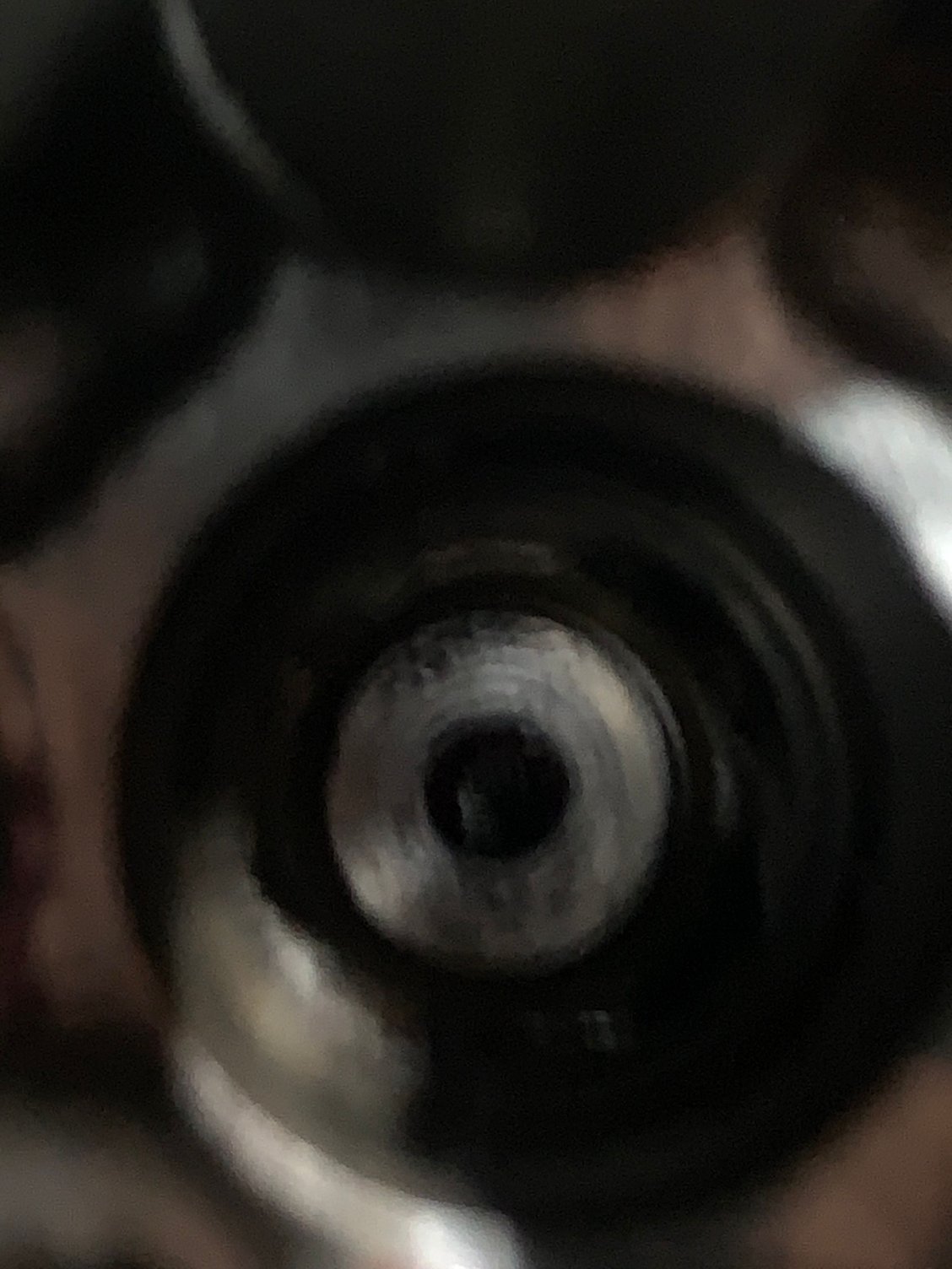

So Im putting in new injector cups because of diesel coolant, but none of cups are cracked thinking must be head or heads. There is a lip in the head at 12:00 under the cup couldnt see before pulling the cups out. It's in all 8 cyl injector bores. Looks kinda to me like over torqued head bolts and head crushed.
Anybody else put in cups and seen the lip I'm seeing?

Do you have a pic? I don't remember seeing anything like that on mine a month ago. B.

kinda it was hard to get to focus
