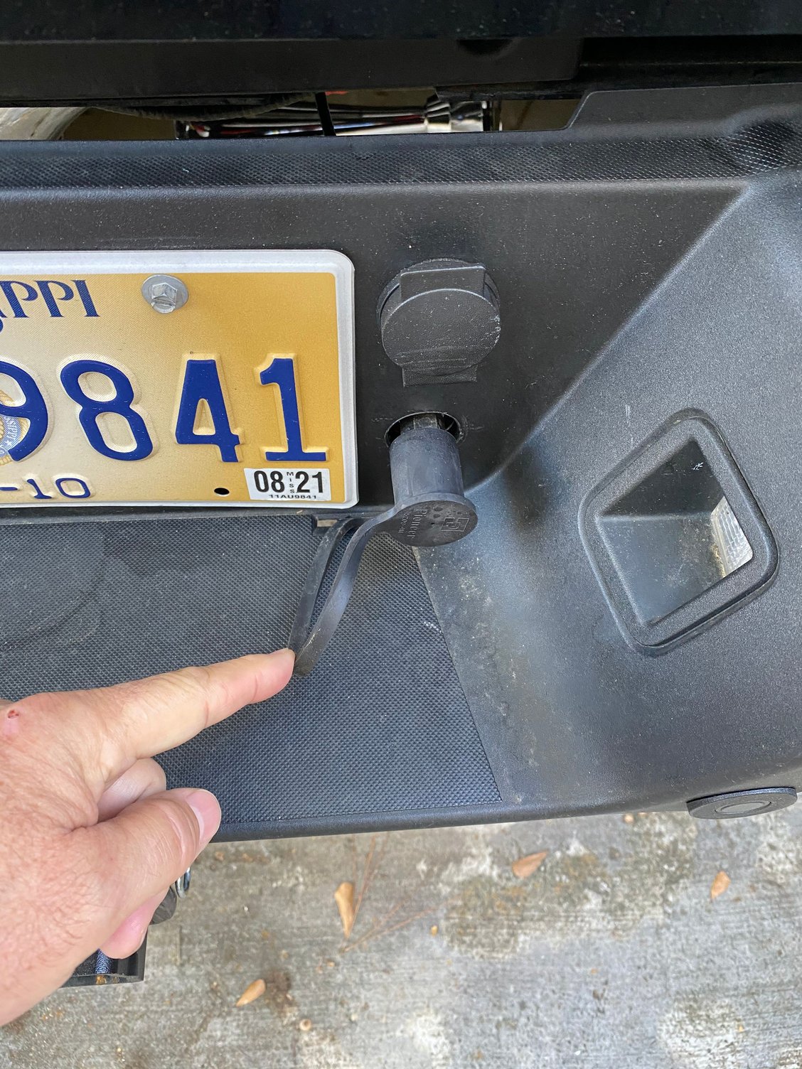

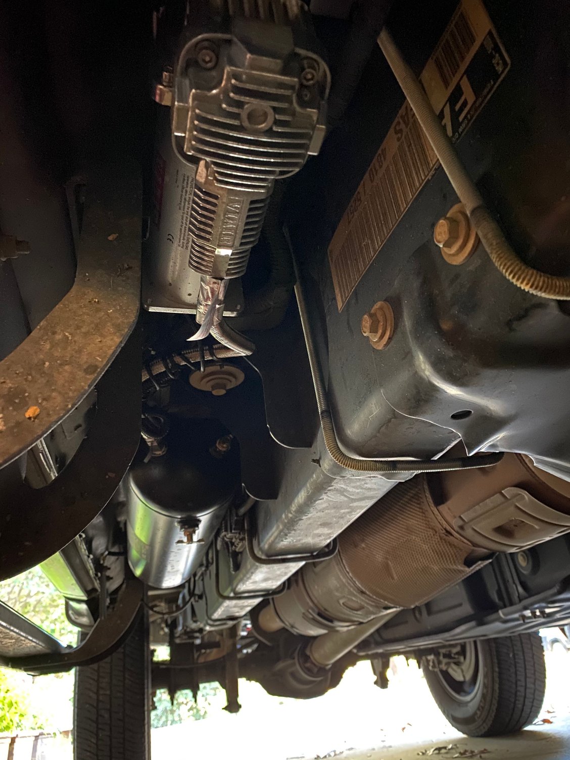

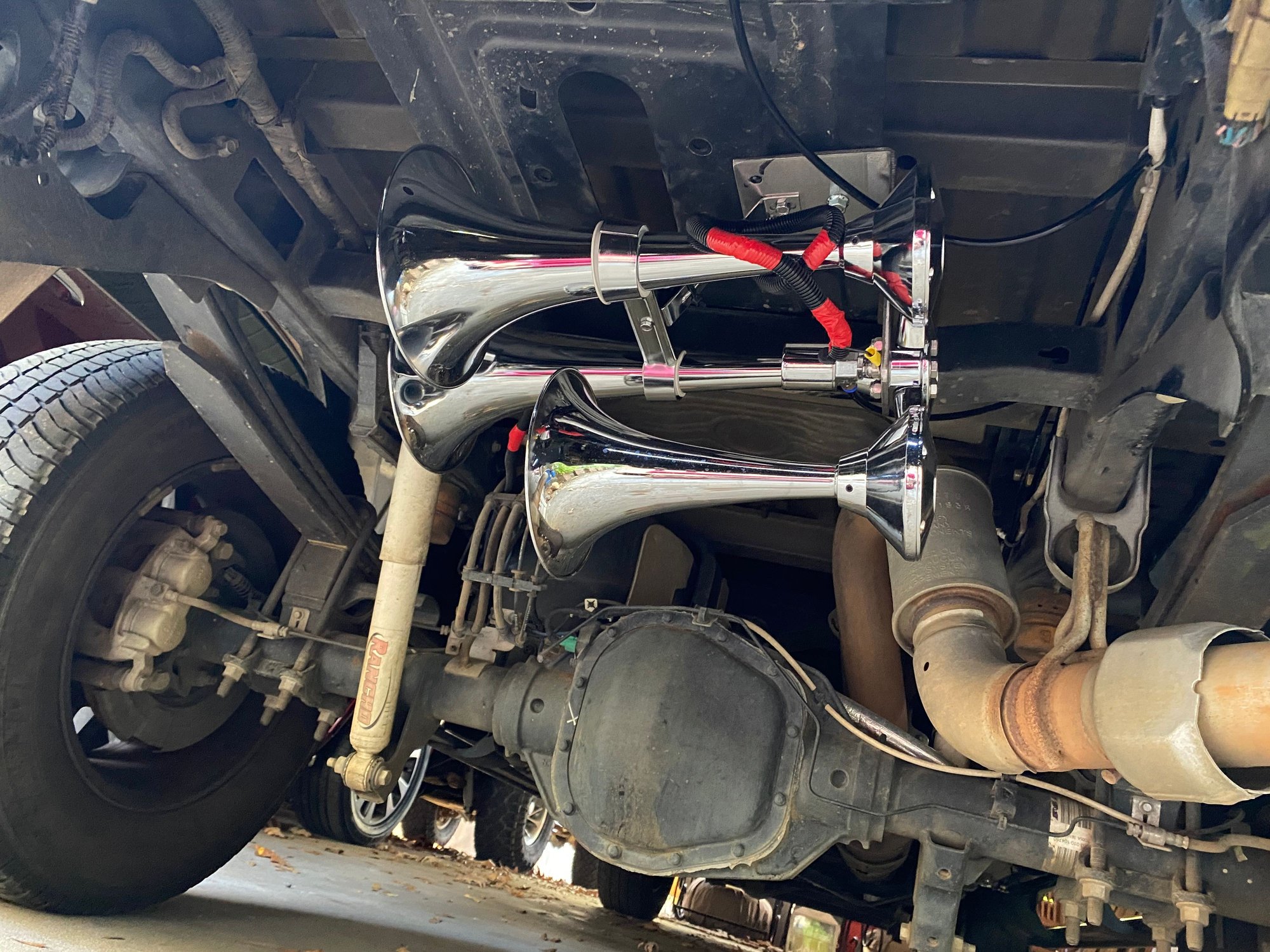

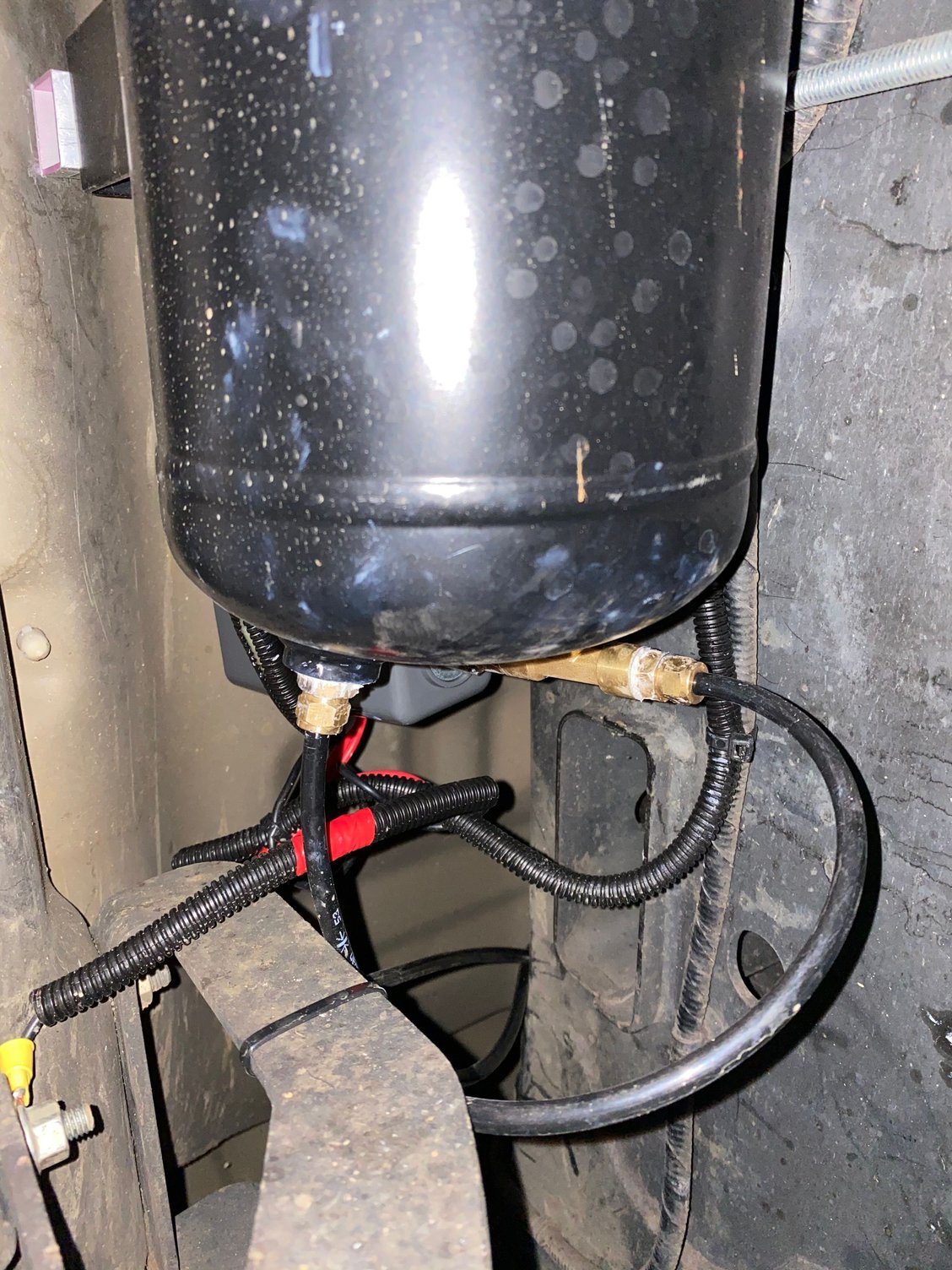

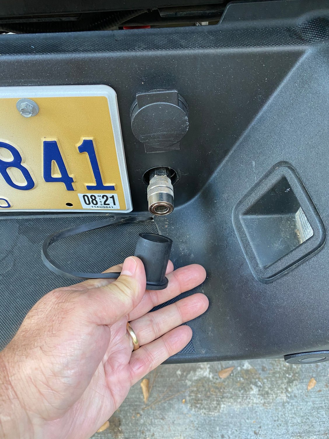

Here is mine

You knocked it out of the park with that build. Amazing. I really only need an Airlift single path cheap compressor setup. I have a portable Viair in a bag setup I carry in the trailer. Of course the more I thought about it I then decided I wanted air horns again and might as well plumb it for OBA. I guess I’m just questioning is there a simple/clean control interface I could hide in the center console. I wonder if I could adapt the airlift analog gauge/toggle setup to control an addition valve plumbed into the train horn tank?
I can get the Airlift wireless ONE right now for $275. Far cry from train horns and dedicated OBA but for the price maybe I should just stick with what I need.
