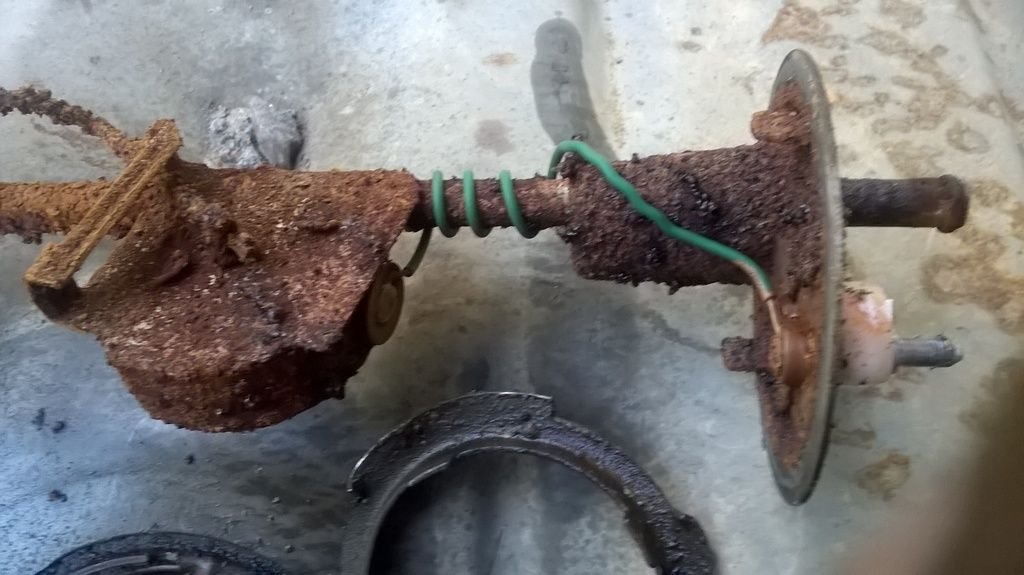

Mike, after these vans sit for a while and especially with the ethanol fuel in them, the tanks, sending units, and pumps tend to rust pretty bad. The ethanol fuel will draw in moisture and then do what is called phase separation where the gas, ethanol, and water separate into layers. The tank will sweat/ condensate and rust.
Here is a pic of the sending unit out of my 85 E150 that had sat for a couple of years.
My 1988 I drive now had sat for a few years and it needed a new tank, tank pump, and sending unit to get it running right.
I think your safest bet at this point would be to start by draining the fuel tanks, dropping them, inspecting, and replacing any rusted or bad parts. With the tank down you can remove the sending unit and pump and test each of them separately. There is a volume test that cam be preformed on the low pressure in tank pump as well as testing the ohms on the sending unit. The in tank pumps are not that expensive so depending on your budget, you might just want to replace them both so you will have piece of mind that they are new and not going to quit on your first trip out..
