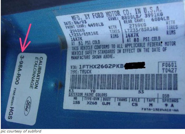

calibration code, isnt on the computer, it is on the B pillar of truck door, if you post the calibration code, our guru's can tell you what PCM you should have.

Oh, and lucky me, the calibration code is missing, you can see where it use to be, the computer that’s in the truck now came from it’s identical twin, same year, engine, trans, rear gear, etc.
