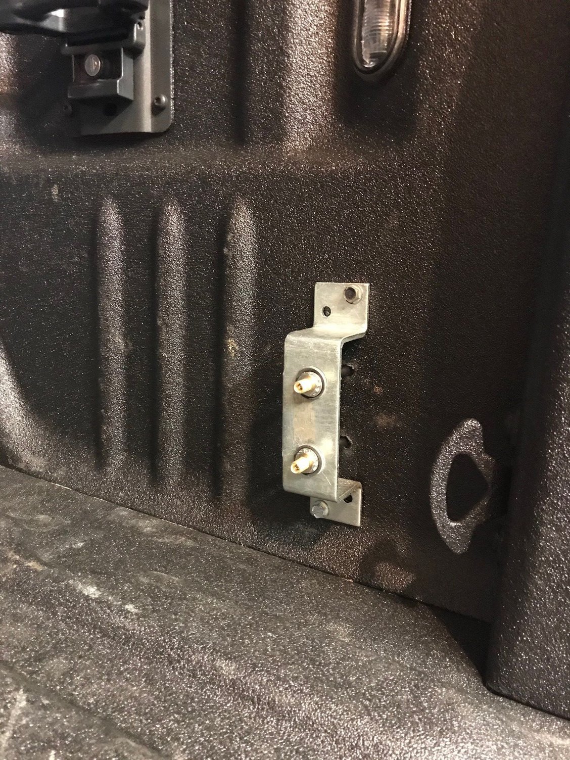

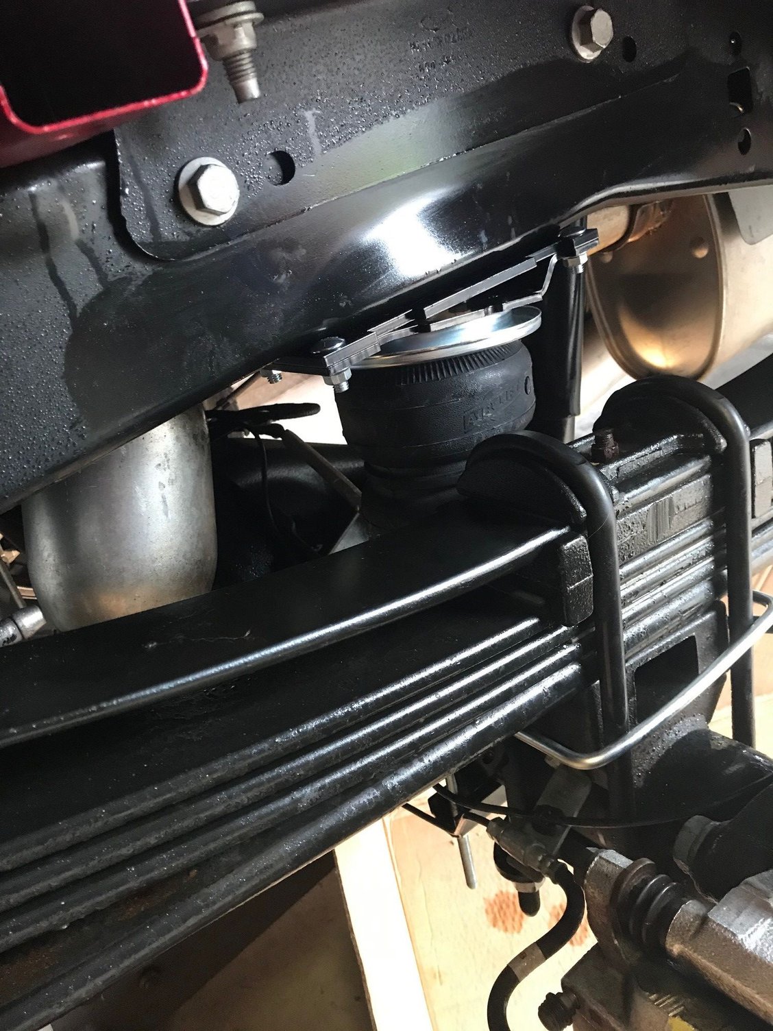

I took advantage of yesterdays mild day in the northeast and installed the Load Lifter 5000 kit on my 2020 F350. The install went really well once I got the truck off the ground and the wheels off, The instruction booklet was very detailed with nice clear pictures for each step, I also watched a youtube video that etrailer put out that a friend recommended.The instruction booklet was dead on with the video.I would recommend that you plan out your own map to run your air lines and the location of the air valves depending on the year of your truck. I installed the valves in the bed so that they are better protected and a easy access. The kit does not supply a mounting bracket for the air valves.

nice install and idea for the fitting.

I picked up the toy hauler yesterday from the dealer. After getting it hooked up and pulled out I filled the bags to 55 psi. The ride was smooth and it felt better behind the wheel. It was a stiffer ride but it did take the bumps better. I did like the fact that I had no sag and the truck sat like there was no load in the bed. I'm really happy with the Air Lift kit, the install, and the performance.
