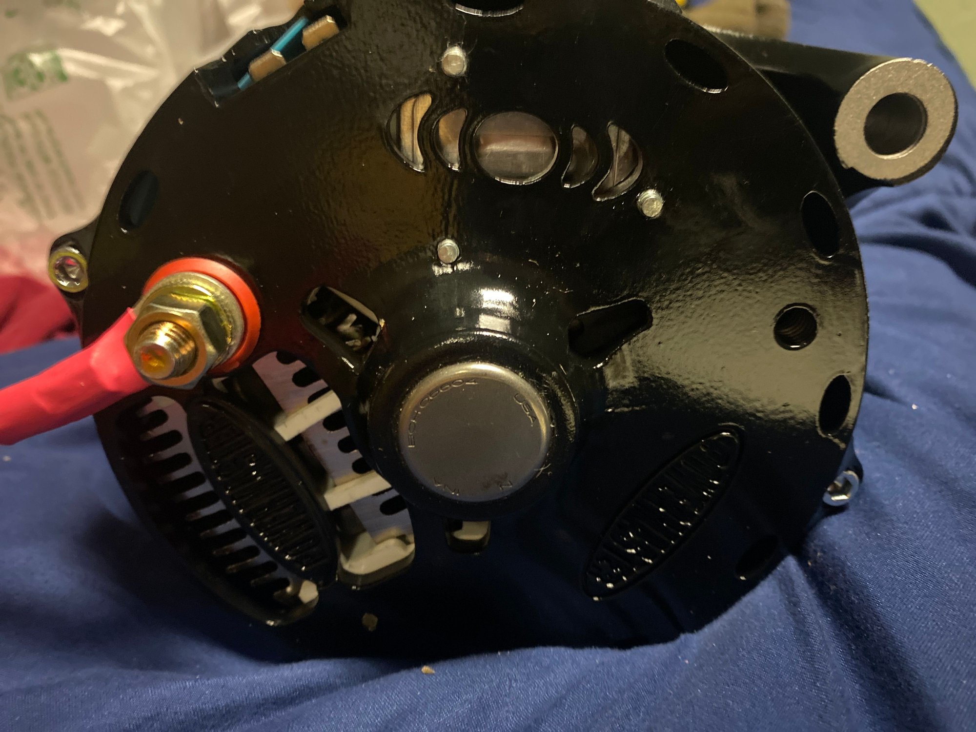

New alternator
I've just bought a new power master alternator for my 7.3, and the website said it would fit the truck, and maybe I'm just retarded, but some of the wire hook ups just don't seem to match anything I've seen anywhere else
Old Dec 12, 2020 | 07:59 PM
ford390gashog's Avatar
ford390gashog
Joined: Jan 2004
Posts: 26,007
Likes: 575
From: Brentwood,CA
What part number? That has GM 10si connection.
Old Dec 12, 2020 | 08:04 PM
Mikey21's Avatar
Mikey21
Joined: Jun 2020
Posts: 39
713-8-57141, multiple sites are telling me it should be a direct bolt on OE/OEM fit
Old Dec 12, 2020 | 08:09 PM
ford390gashog
Joined: Jan 2004
Posts: 26,007
Likes: 575
From: Brentwood,CA
That alternator only replaces the small case Ford 1g, yours has the large case 1g alternator.
Old Dec 12, 2020 | 08:14 PM
Mikey21's Avatar
Mikey21
Joined: Jun 2020
Posts: 39
Well that's fantastic 🙃 thank you tho, It said 1 wire capable, guess I misread something
