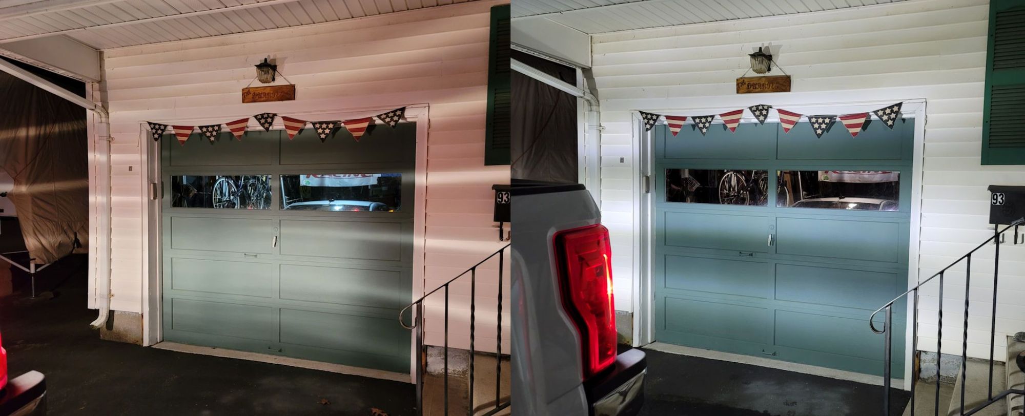

My 2019 F-450 XLT, though the owner's manual stated had LED backup lights, seemed to have incandescents. They seemed extremely yellow and dim right from the start and made it very difficult backing up with the mirrors (the AGC of the camera helped a lot). I had purchased some Fog Light pods from Diode Dynamics and really had great success with them. I received a discount coupon a few weeks back, so while perusing their site, I spotted their backup LED replacement lamp series. Bingo! Ordered their "7440/7443 - XP80 - 510 Lumen LED Lamps", shipped... installed today... took all of 20 minutes to do both sides (and the stock bulbs were indeed incandescent, btw). Got the driver's side in correctly - had to pull the passenger bulb out and reverse the polarity on it as it wouldn't light up! 50/50 isn't bad, I guess - there are no markings on the lamps for +/-! Here are two before and after shots in front of my garage for comparison... very telling! $90.00 for the pair BUT, well worth it back down my dark driveway!!!

Very nice side by side comparison though. I will certainly look into these.
