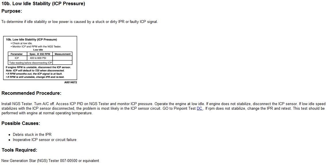

Per the table posted by BWST above, P1209 is reporting a stuck IPR. Given that you bought a new one, that means there is a blockage somewhere in the HP oil circuit. Is the IPR genuine Ford/Motorcraft?
It shouldn't make much difference in this area but what model year is your truck so I look up the correct version of the shop manual?
A quick search yielded this so far:
The procedures are attached if the above leads you to the DC pinpoint tests.
Tagging @Y2KW57 for Tech Folder content. (Done)

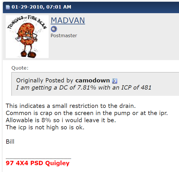

In the thread below, ICP just a bit lower than normal at idle, and @MADVAN talks about a screen in the pump (HPOP?). Is this something we can check?
He goes on to say "ICP is not high, so is ok" but on your rig, ICP is high.
https://www.ford-trucks.com/forums/9...at-idle-2.html
