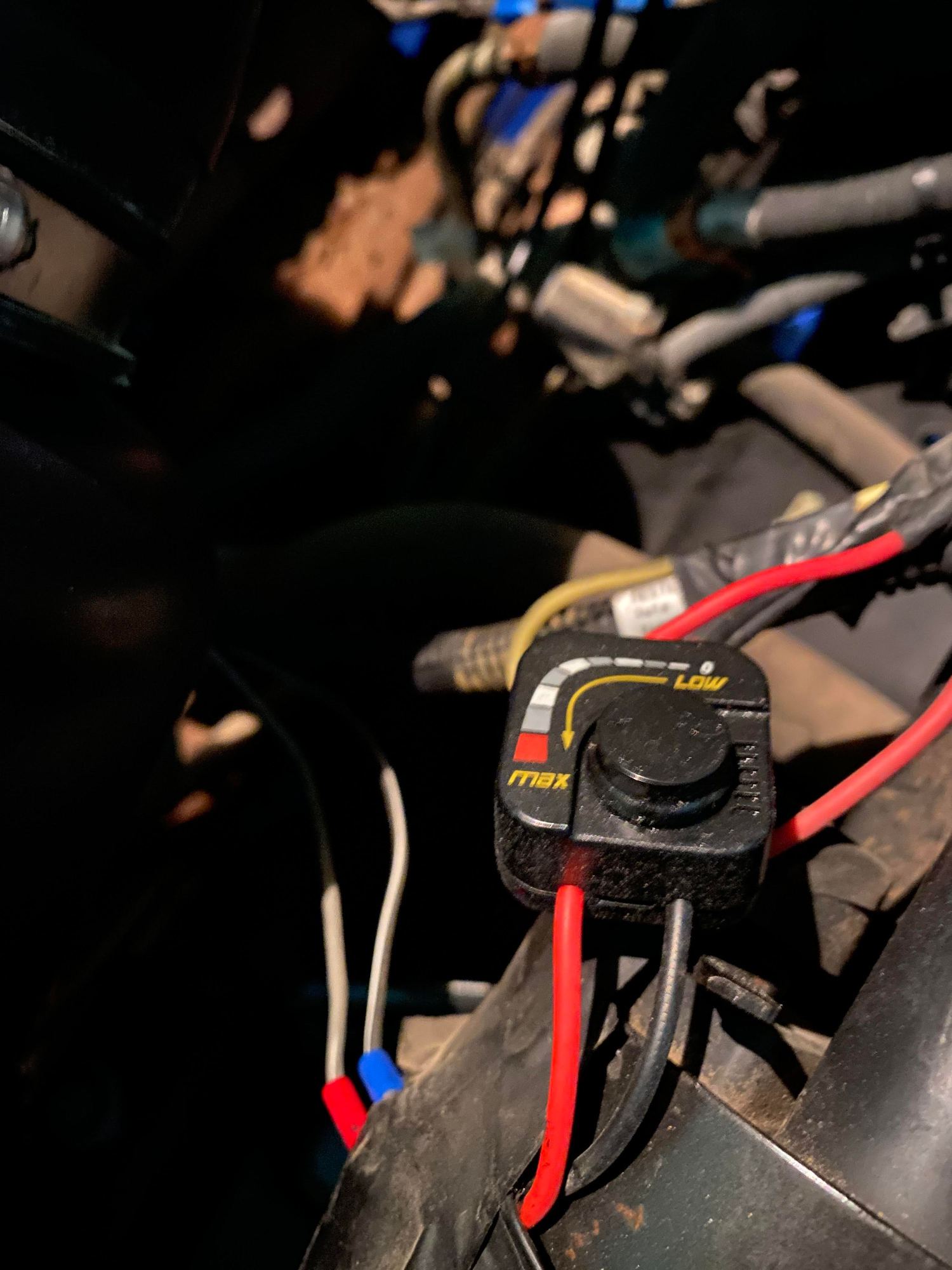

We just brought home a 2001 v10 this past Saturday. I have doing a few repairs etc. While I was installing new headlight lenses I saw this small, obviously not stock, dial.

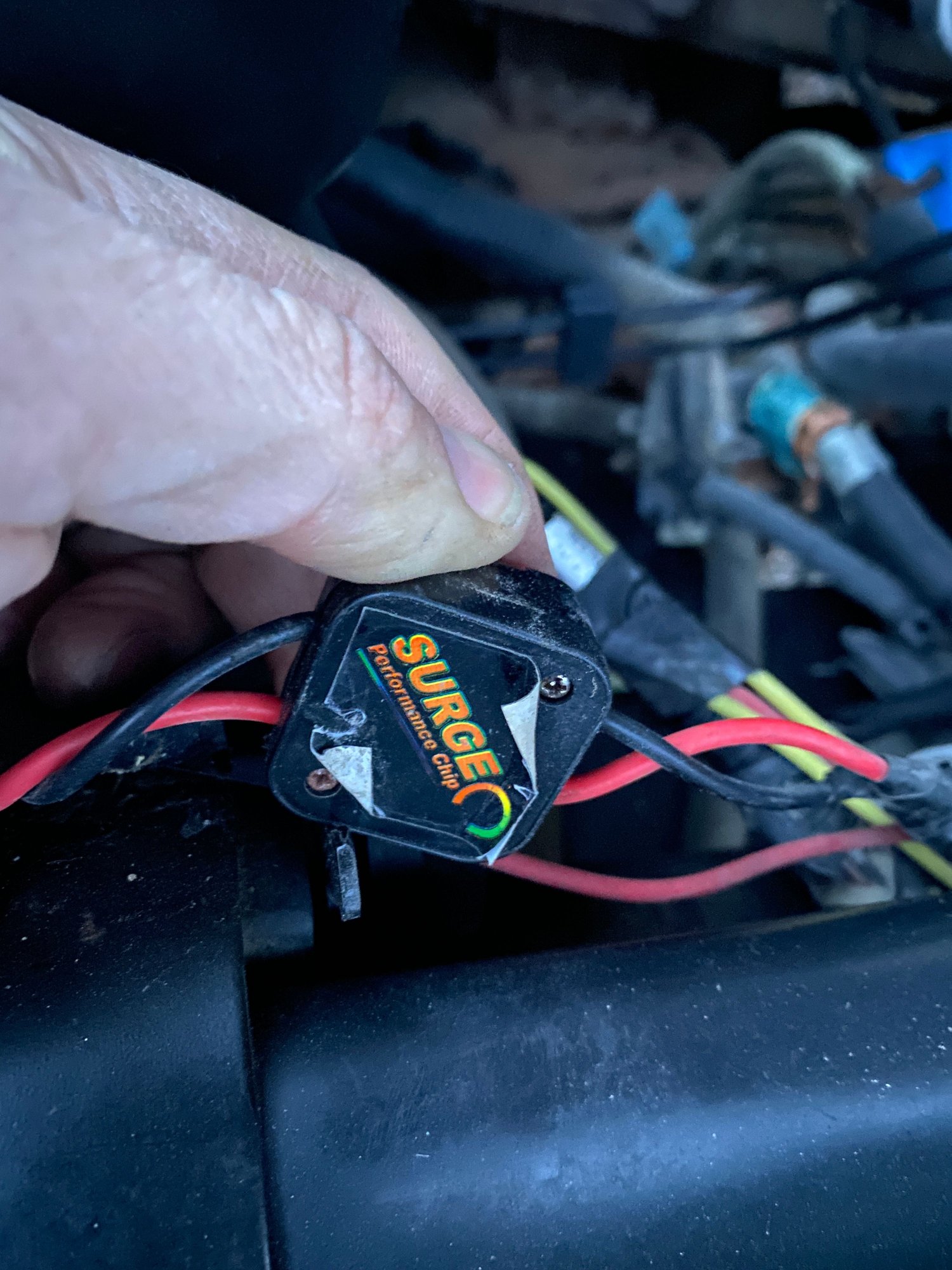

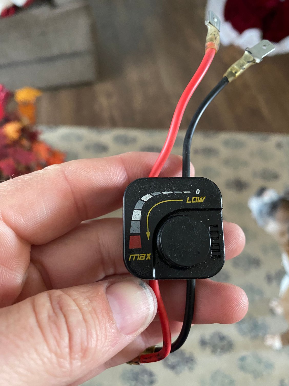

The wires went into the air intake and at first I thought it was one of those gimmick “Electric Supercharger” things that are worthless. I went ahead and took air filter box and tube apart to inspect. No “Electric Supercharger”. I flipped the dial over and saw this

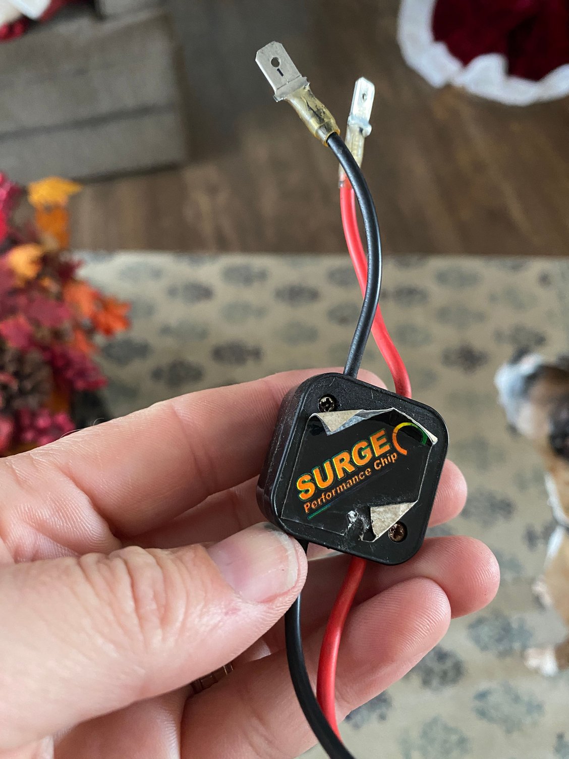

Googled it and evidently it is a super cheap “Chip” that is supposed to increase performance and mpg by adjusting the MAF reading to trick the vehicles ECU into thinking it is running lean or rich. What the heck? It amazes me what people will fall for sometimes. This could explain why my initial mileage seems to be pretty bad. I was expecting 12-14mpg for mostly hwy trips....looked like I was getting 11mpg.
Anyone see an issue with me removing this and just splicing the original wires back together?

Just remove it and reconnect everything, for the MAF Sensor, you might want to dab a little solder in there to make sure there isnt high resistance on the connection or you may get readings that are a little off, but yes, some jackass obviously believes anything they see on the internet. Its just a resistor in a shell, possibly a variable resistor by the looks of that one, but none the less. And you are best off ripping those things out before they cause problems.

It’s official, I no longer have a chipped/tuned Excursion. At least the previous owner was nice enough to use weatherproof spade connectors. Made removal pretty easy.

When other people say they have a chip or a tune, it never involves one of those, its either an actual circuit board chip that plugs into the ECM, or else a handheld tuner that edits the ECM programming directly, in the case of a chip, there is no wiring, it just plugs into a factory port on the ECM, in the case of a tuner, it just plugs into the OBDii port, what you had, was a fake knockoff.
