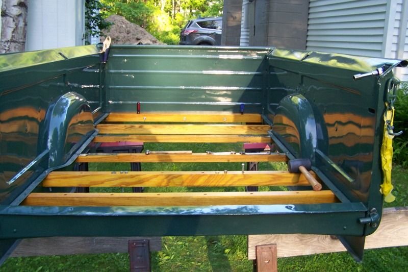

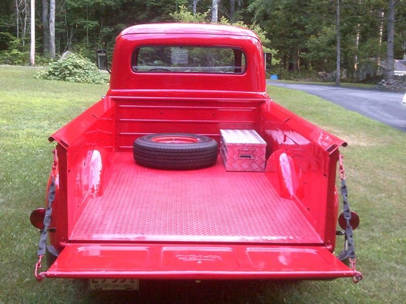

On my F2 I had, I ended up replacing the bed floor with 1/4" diamond plate painted to match the red body color. That was less money than fixing the original floor which had rotted crossmembers. A guy fabricated & welded new bed side patch panels and straightened the tailgate for me. On my F3, that bed was even rougher but I had a guy do the same treatment to that one EXCEPT I was able to replace the bed floor with oak, just like original. The reason I did that is because Bruce Horkey now reproduces the wooden floor parts and crossmembers. They weren't cheap but they fit well and make the truck look stock. I guess what I'm saying is that if you wish to preserve the bed - find a good fabricator and have him stick to the original design as much as possible. Maybe buy some reproduction 6-foot bed parts and have them welded in. The stake pocket bottoms can be fixed with a cross-section of an exhaust pipe elbow. There is a thread on here of a guy doing that very successfully. Search for 'express bed stake pocket' on here. If you are going to scrounge for parts, expect that the shipping will be as much as the parts or even more - just part of the hobby. Good luck and we will encourage and support your plan to save your bed.They all can be fixed with some time, money and vision.
My signature photo is the F3 and has the 'before' look.
Here are 'after' pictures of the F2 and the F3, if that gives you some motivation.

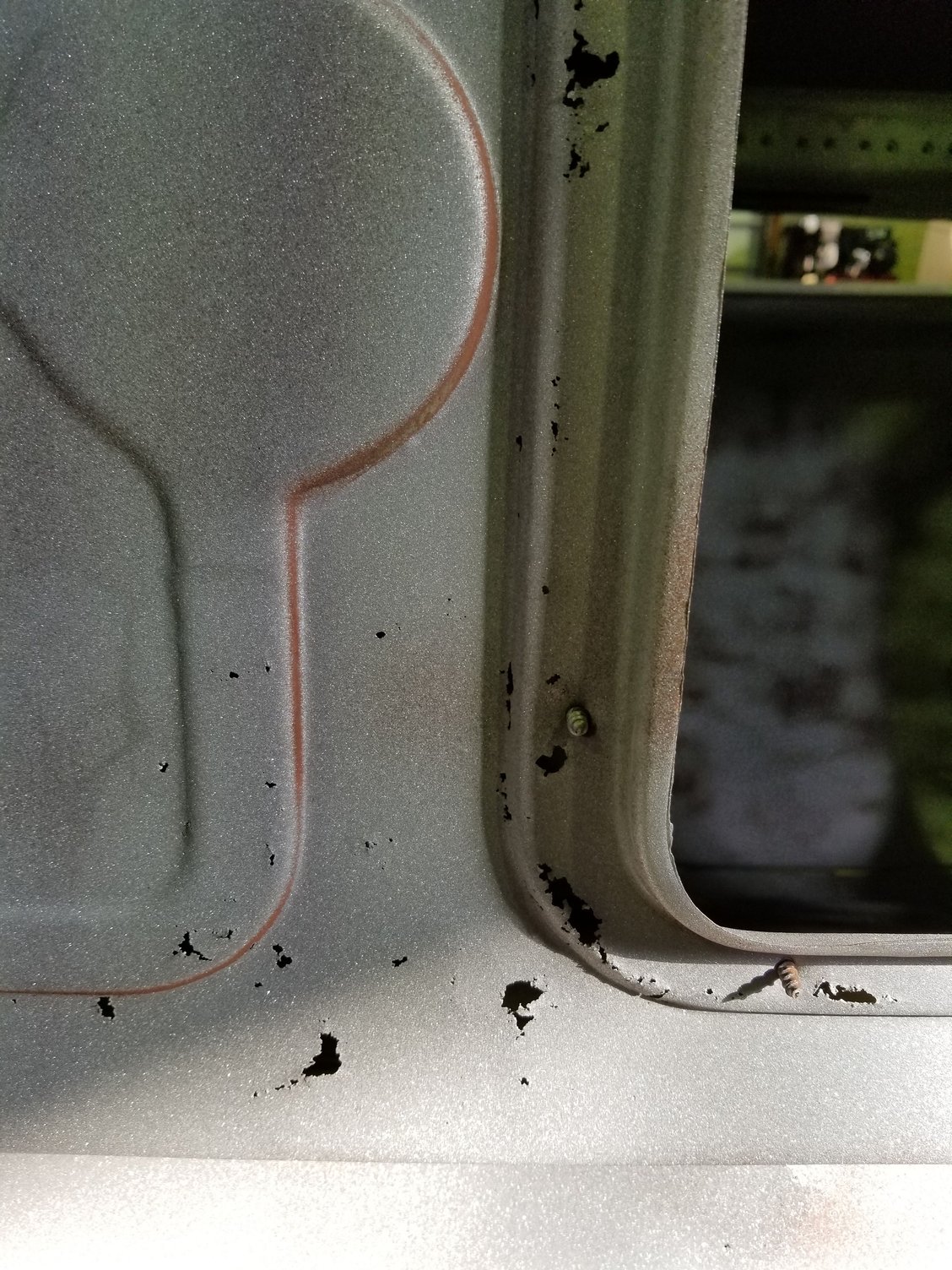

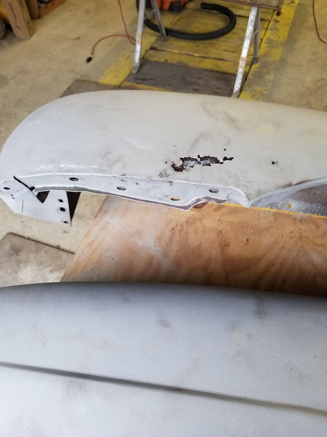

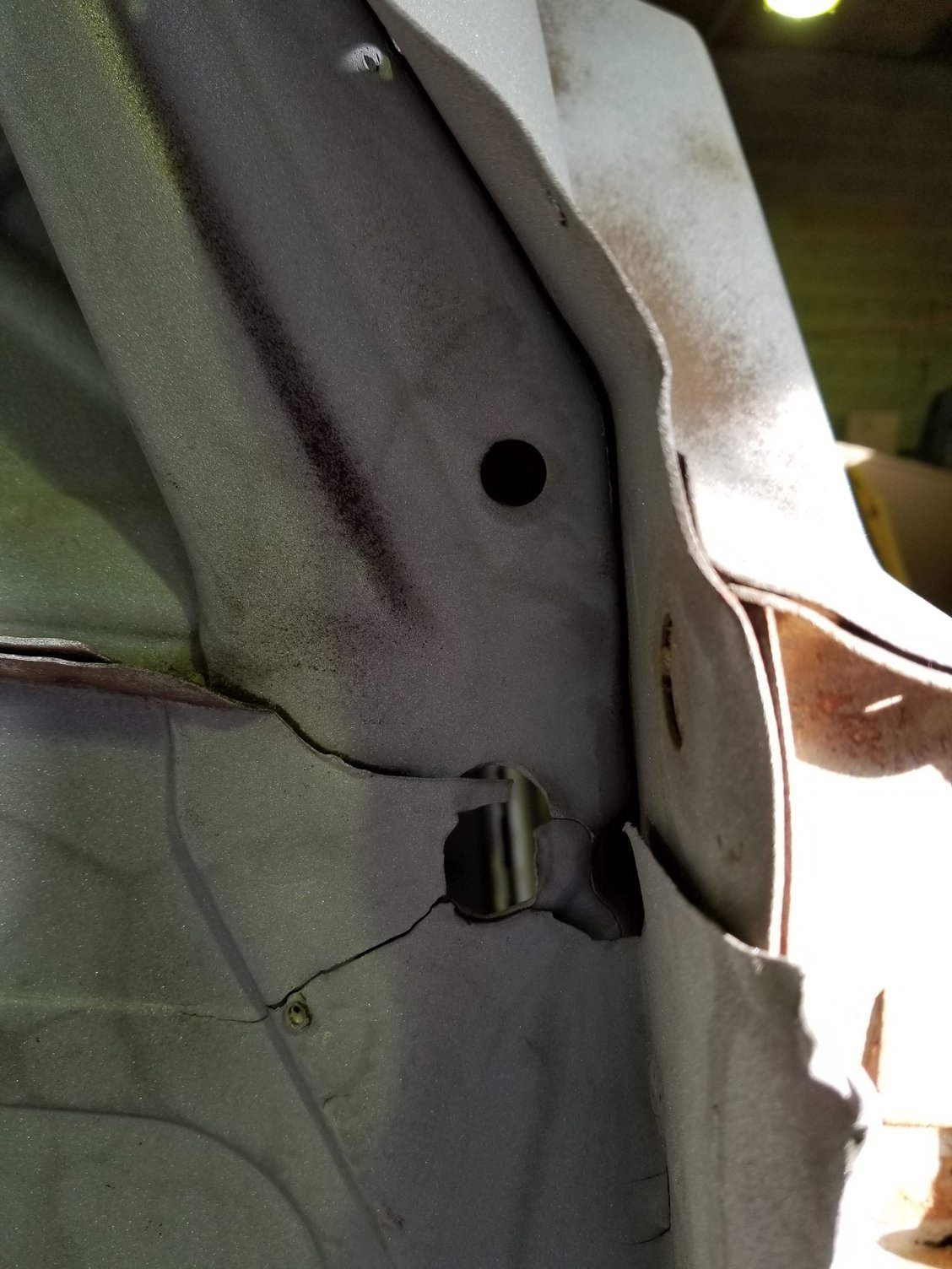

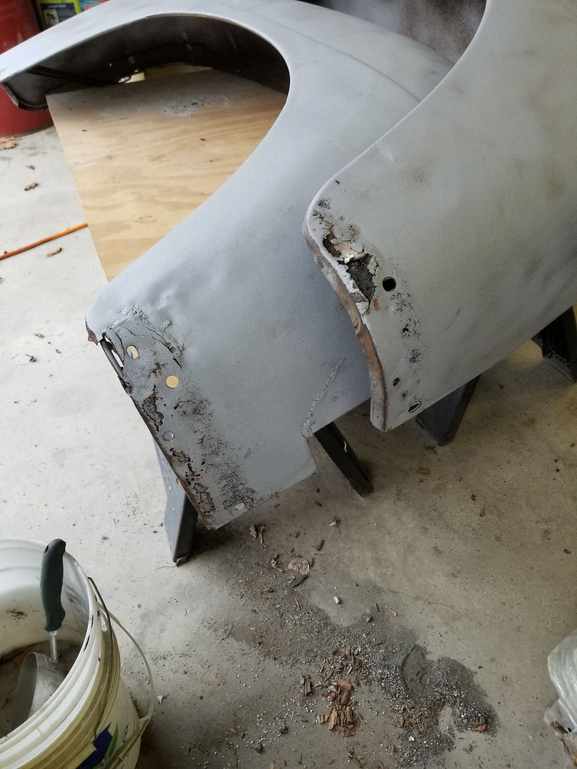

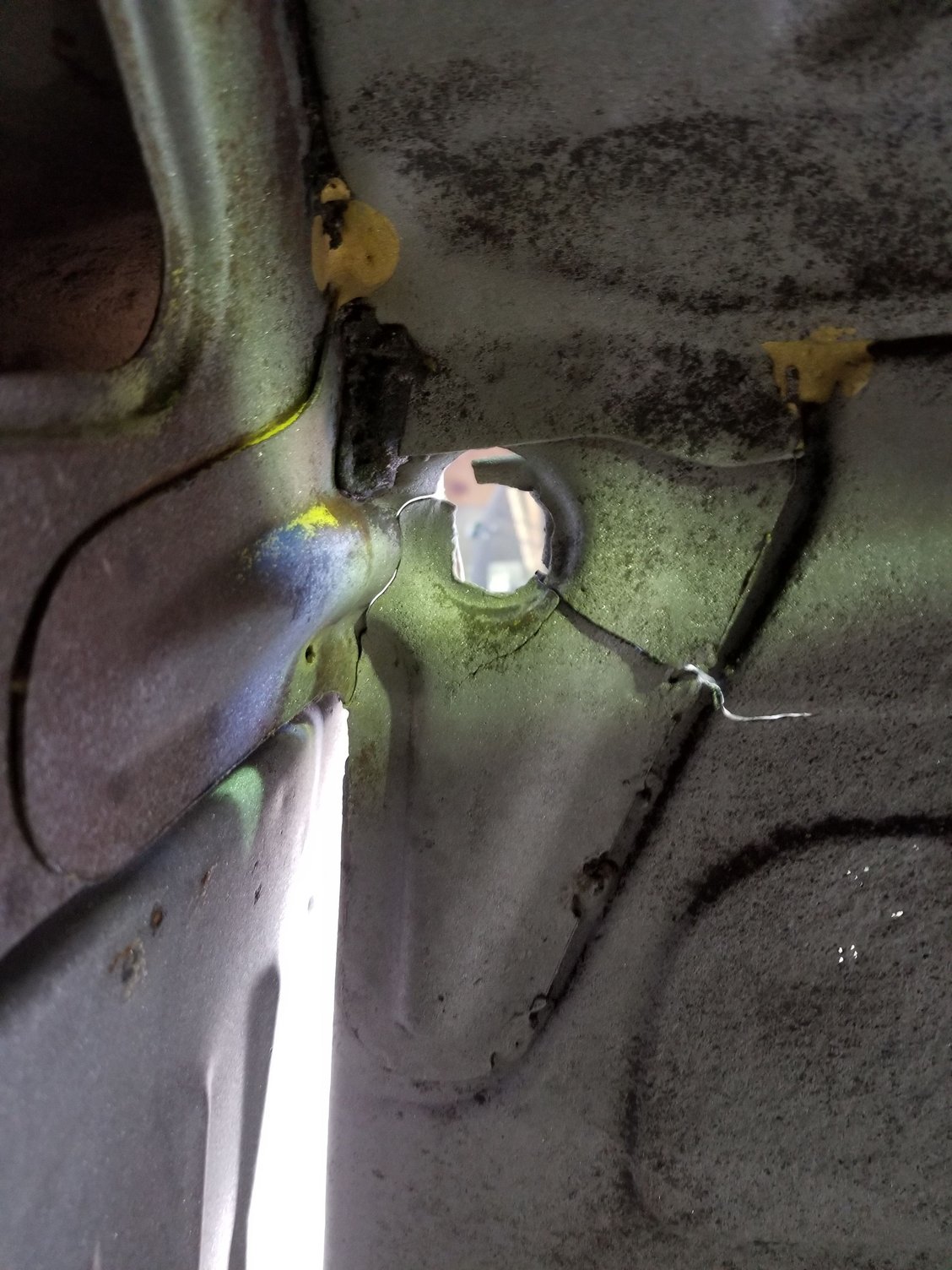

Thanks all for the help as far as the bed goes its is pretty good shape the wood is shot but the meatal is repairable. I was hoping to replace the wood crossmembers with meatal. The last owner replaced them about 6 years ago and they are all rotted out again. Its the floor of the truck that needs replacing. The one rear fender and running board that may need to be replaced. Here are some pictures.
the next two pictures are of what I think will be hard to fix its as it is rusted through both layers and the shapes may be hard to reproduce
What do you think

Everything I see there is repairable. Floor pans and cab mounts are available from any of the truck parts vendors. Those patch panels fit all series as the cabs are the same. The running board looks better than most. The fenders all have nothing more than typical rust. You may find better ones, but they'll still need rust repair, so you might as well fix, or have fixed, the ones you have. Here's a great tutorial on how to fix the rear fenders. Myers has done an incredible job, so you can see it can be done.
https://www.ford-trucks.com/forums/1...l#post19595279

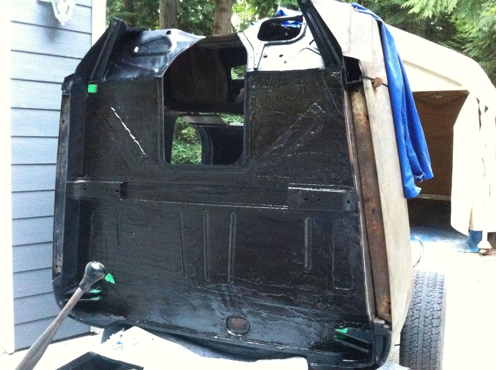

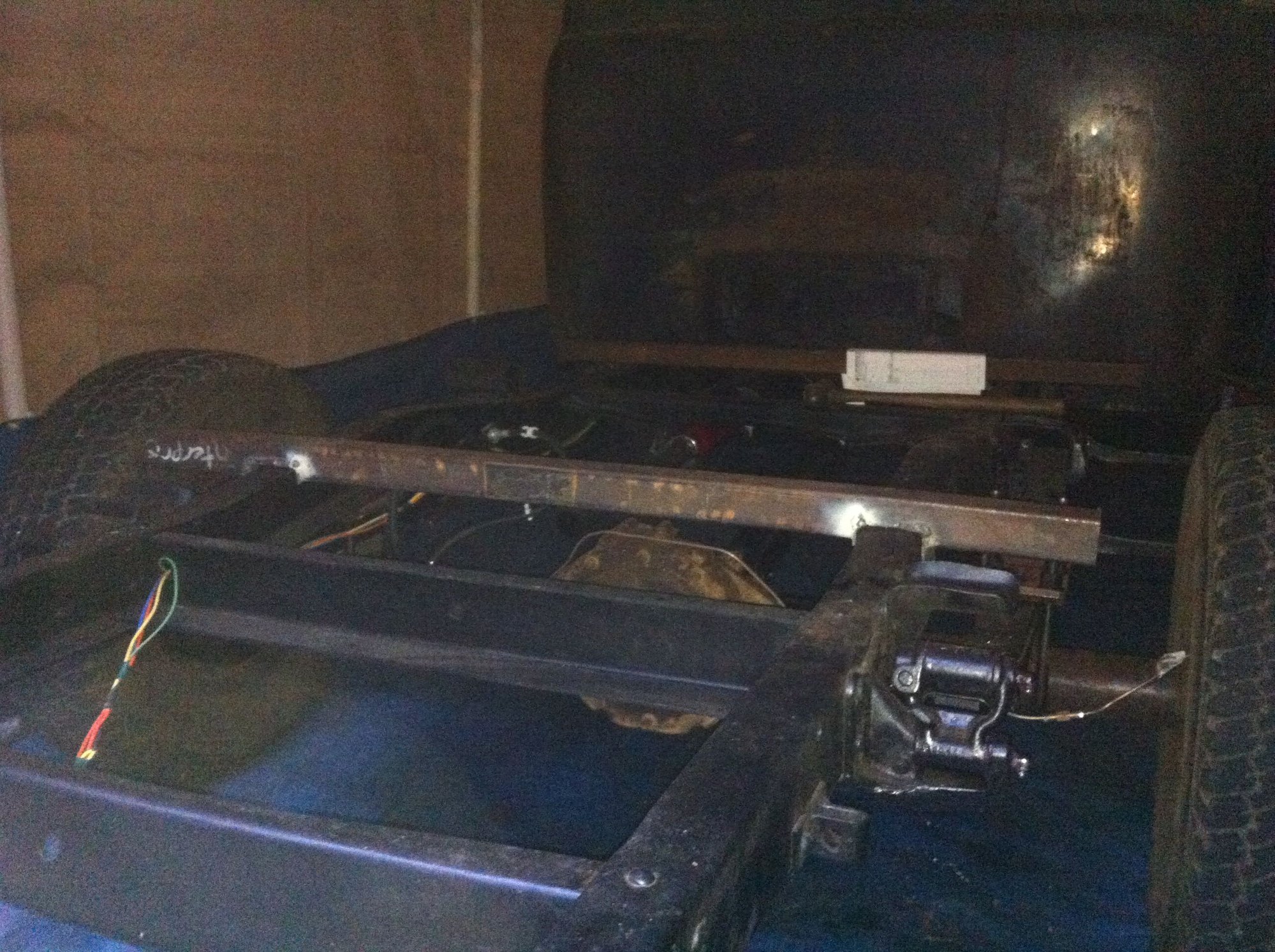

All the Cab areas are repro'd. You can get just the braces, left or right front floor sections or even the entire floor and firewall as one piece. I think the entire floor is about 500 bucks plus tax. But if it's anything like mine you could just get the front half for way less. I just replaced my floor with flat sheet metal with some gussets and that worked fine.
It's not polished to a mirror shine but nobody's going to see it.
I made bed mounts out of 2" boxtube, 3 - 1/2" channel and 1/2" of rubber pads for a total height of 2-1/2", which i believe is factory
You have to notch the center 2 tubes slightly, the rest just sit flat on the frame. Pretty straight forward.
Mine didn't have holes drilled in the frame for crossmember 2, 5 and 6. I ended up drilling those out so i wouldn't lose the rubber pads and just because i don't like the idea of that stuff running loose and vibrating against the frame. I was about 200 bucks all in, and that's including stainless fasteners and having the metal shop bend the channel for me as nobody carried the right size around here. Probably cheaper than wood all in, and it'll last foreverish.
Those fenders and running boards are pretty healthy as far as big boy pickup metal goes. You'd be hard pressed to find any replacements, let alone better ones. My right hand rear fender is so bad it actually fell the hell apart, so i just welded it back together and slapped it on as is. But it's kind of a rustomod thing so it works. If you're not doing that and can't do it yourself a bodyshop's in your future I imagine.
