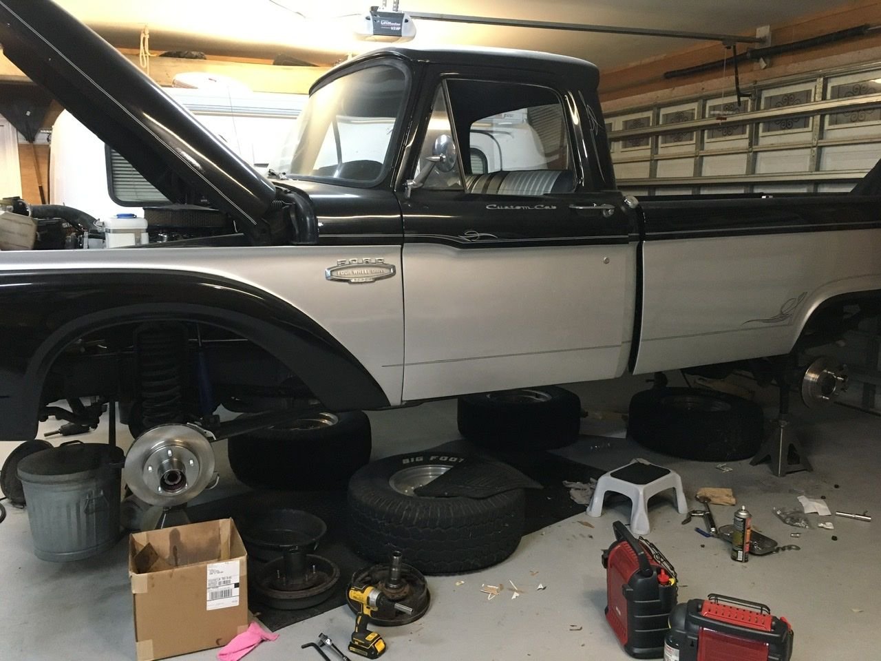

Old Jan 10, 2021 | 06:50 PM
City farmer's Avatar
City farmer
Joined: Mar 2016
Posts: 6
From: Southern LA
Thanks for the help guys. Bought the HP kit with booster and Master. Great kit. The EBay rear, I’m not a huge fan of, but they’re on. Now to run new lines and start that stage.
Old Jan 10, 2021 | 06:58 PM
53deere's Avatar
53deere
Joined: Nov 2005
Posts: 1,851
Likes: 436
From: Lehigh Valley, Penna.
Nice looking truck. Does it have a newer chassis under it? It does not have a 65 4x4 system.
