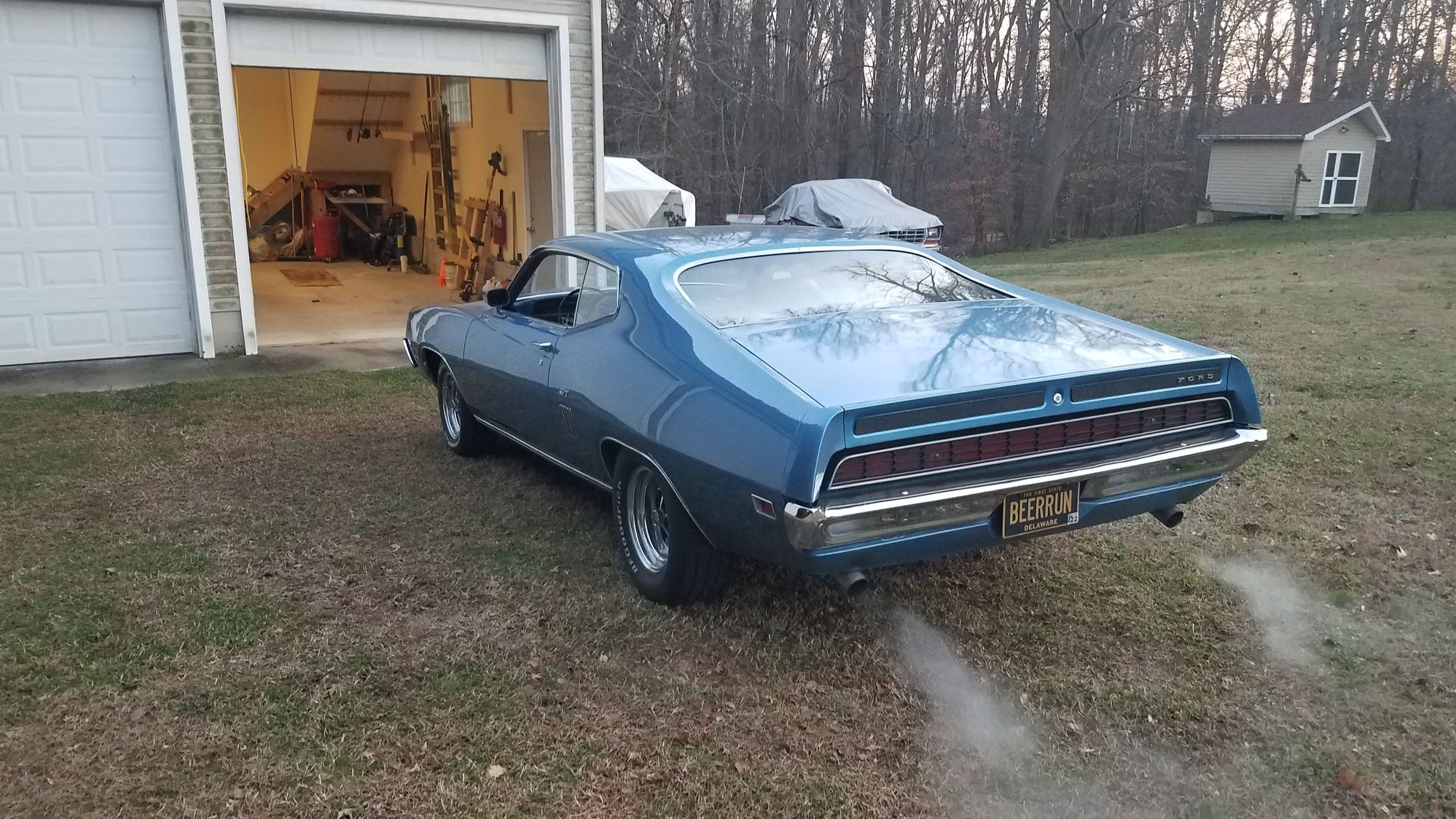

Originally Posted by my79f
Gonna be good!
More pics of the Torino, please!

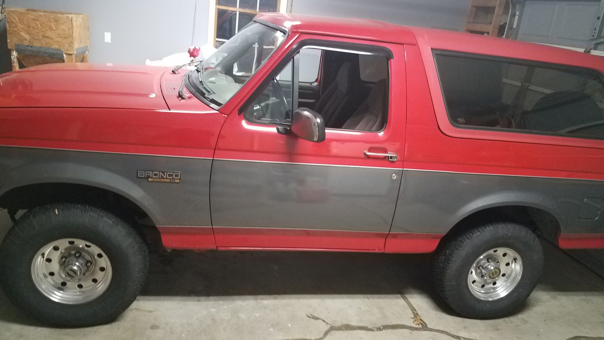

heres my other fords

"BEERRUN" Too cool!!

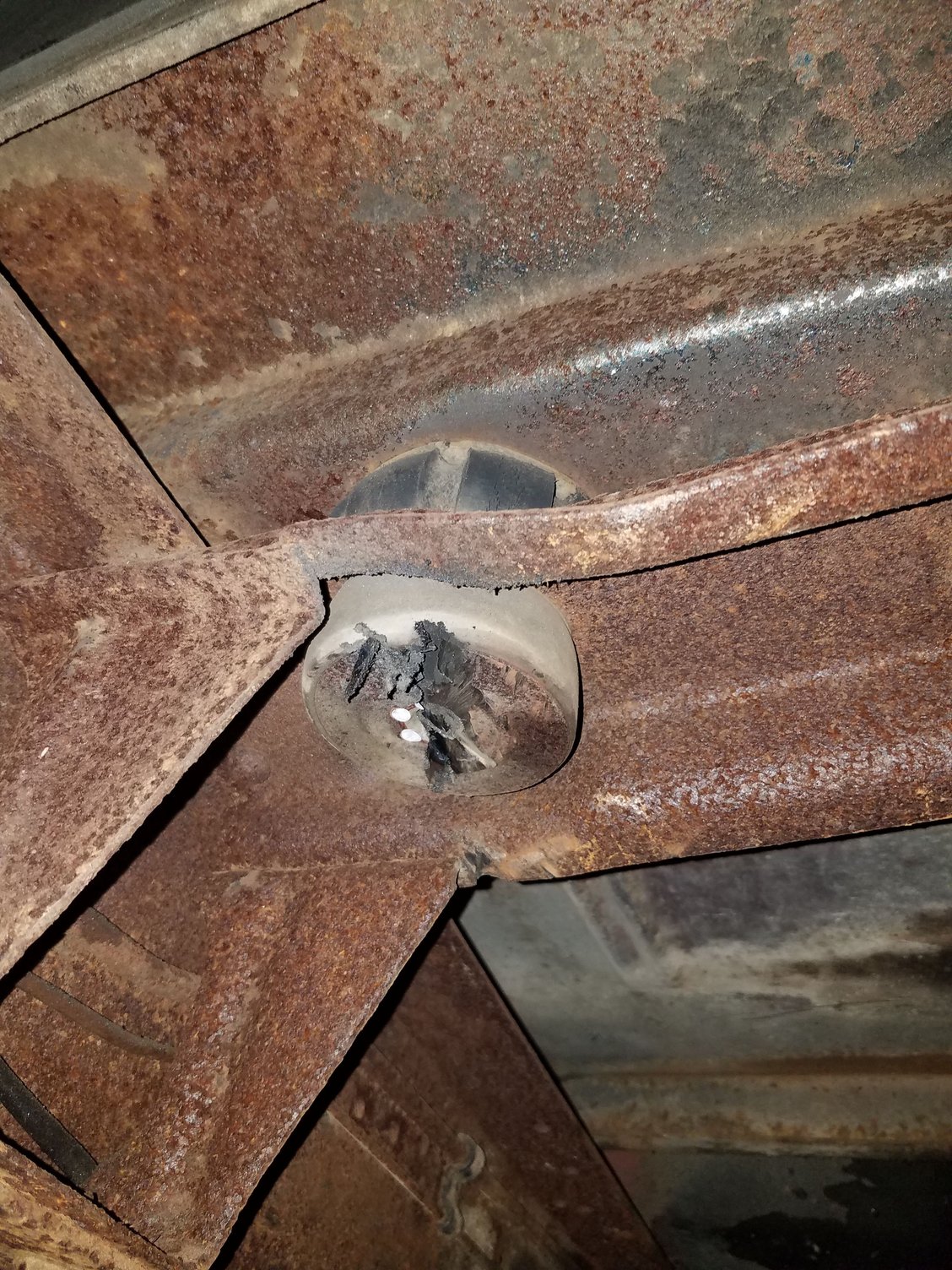

Got a 75 4wd 390 4spd short bed for 3200. Been looking for 1 for 5 years. Have been wrenching on Ford's for 40 years. I want to take this to the ground and bring her "Vickie" back to proper condition. I've never done a frame off. Just looking for any tips. Also got a 79 250 4wd parts truck
got the cab bolts cut. Couple more things, plan on cab removal this weekend.. can I just rap straps around her and lift, I got a 2 post how bout pinch welds
