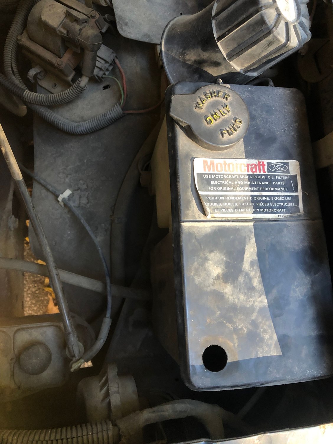

take a look guys. Help me please!

In this picture you are missing the rubber hose that goes from the coolant reservoir to the nipple just below the radiator cap.

if it were me, i’d either google the part numbers on the reservoir tank since you still have the motorcraft label or, since nothing will probably come up in the google search, stop by a Ford dealer and see if they can find a replacement part.
You’ll probably have to replace the whole reservoir versus finding just a new cap or hose. I guess if the cap isn’t pressurized, any cap will work though.

go to a salvage yard and look for another resevoir. I dont see the cap for the radiator or the hose that connects to the radiator. you could fabricate one if need be by getting a piece of hose that will fit the hole and then connecting with another hose that will fit the radiator hookup just below the cap. If you go this route just make sure the hose in the resevoir fits to the bottom of the thing. but then another problem is that there is no fill point to the resevoir!

Hey guys I just took more pictures of it, it seems like the rubber hose who goes from the reservoir to the nipple is underneath the reservoir. I took more photos. Also I think I was not clear but I do have my radiator cap the only thing that Im missing is that hole in a circle shape. Take a look and thanks for helping this useless noob.
You can see the rubber hose there! Thanks

i didn’t realize it, but the left hand side of the reservoir (with the cap) is evidently the windshield washer fluid tank. The other side is for coolant.
