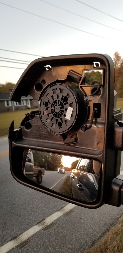

It is the driver side mirror and once the new one comes in you are more than welcome to have this one. However, This is the current state of it.
