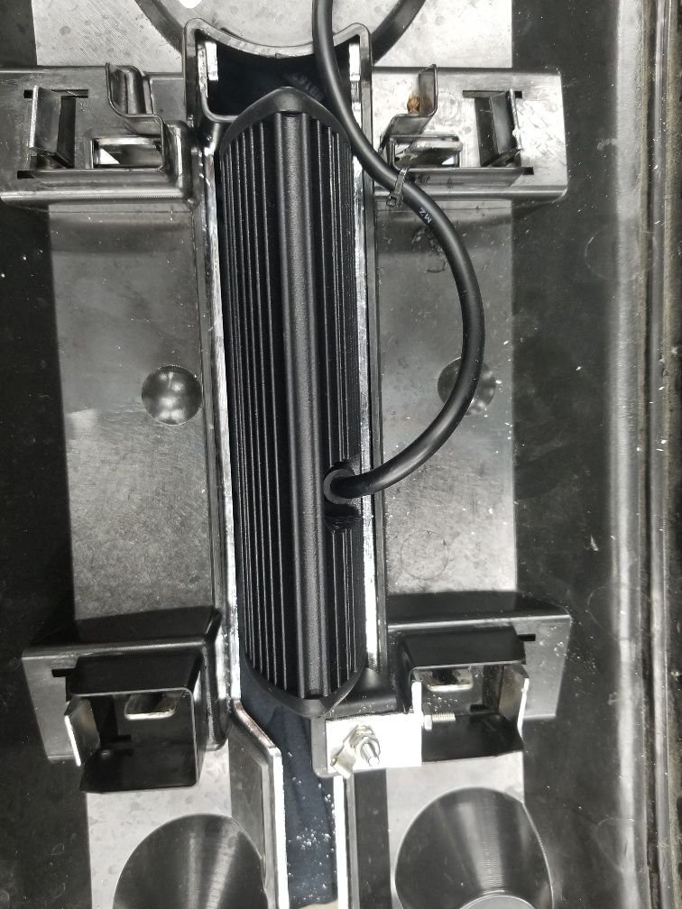

BTW - in your pic, how did you mount those strobes? That's basically what I want to do as well. I went to take off the grill this AM, but it was too cold in Calgary and I hate playing with plastic for fear of breaking it. I put the radiator shroud back on and will try on warmer day. I was thinking either mount the L brackets that came with the strobes to the plastic grill, or custom fab some metal one that attach inside from the rear.
How are yours attached?

Old Dec 1, 2020 | 08:12 PM
Curt's05's Avatar
Curt's05
Wiser by FTE
Joined: Jan 2010
Posts: 2,837
Likes: 48
Here is photo, small l brackets, adhesive
