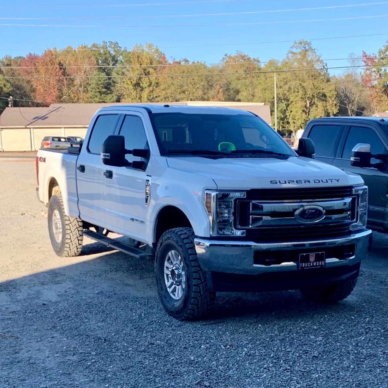

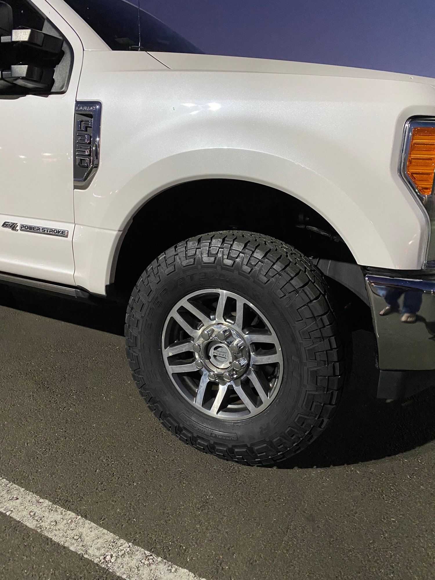

I'm guessing you ordered tires already, but I just put on some 285/75R18 Cooper Discoverer AT3 XLTs on my stock height truck yesterday. Those are just shy of a 35 and I think they look good in person.

I did but Thank you and those do look good!
Yep, this pic just sealed it for me...that's what's going on my rig when the stock Goodyears are gone! Nice setup; thanks, e!
