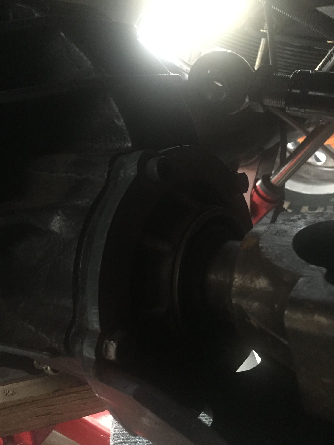

Installed ford 9” into new housing and not sure what i should torque outer bolts holding carrier to housing to? Also Installed pinion gaurd and need to torque bolts around pinion.

See post 3. 30-40 ft/lbs.
