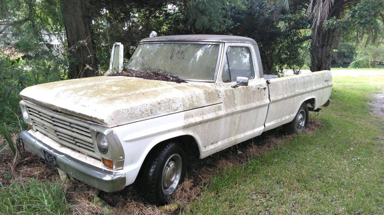

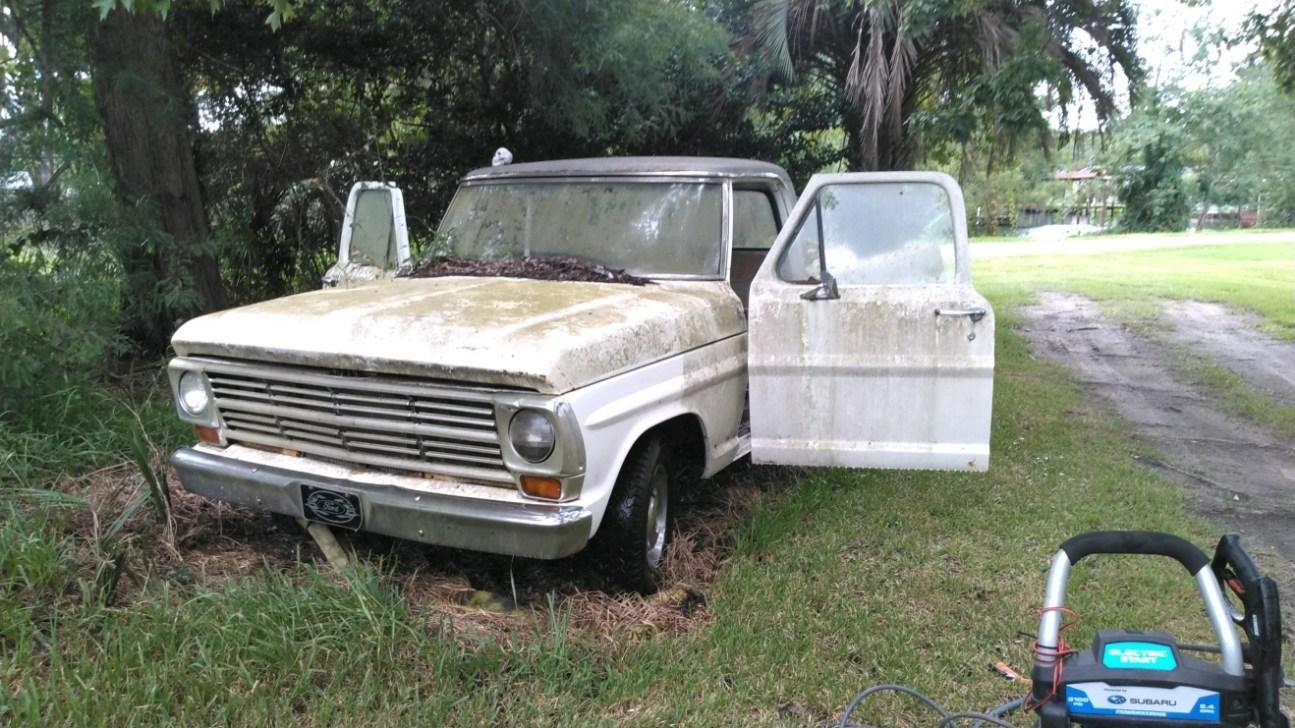

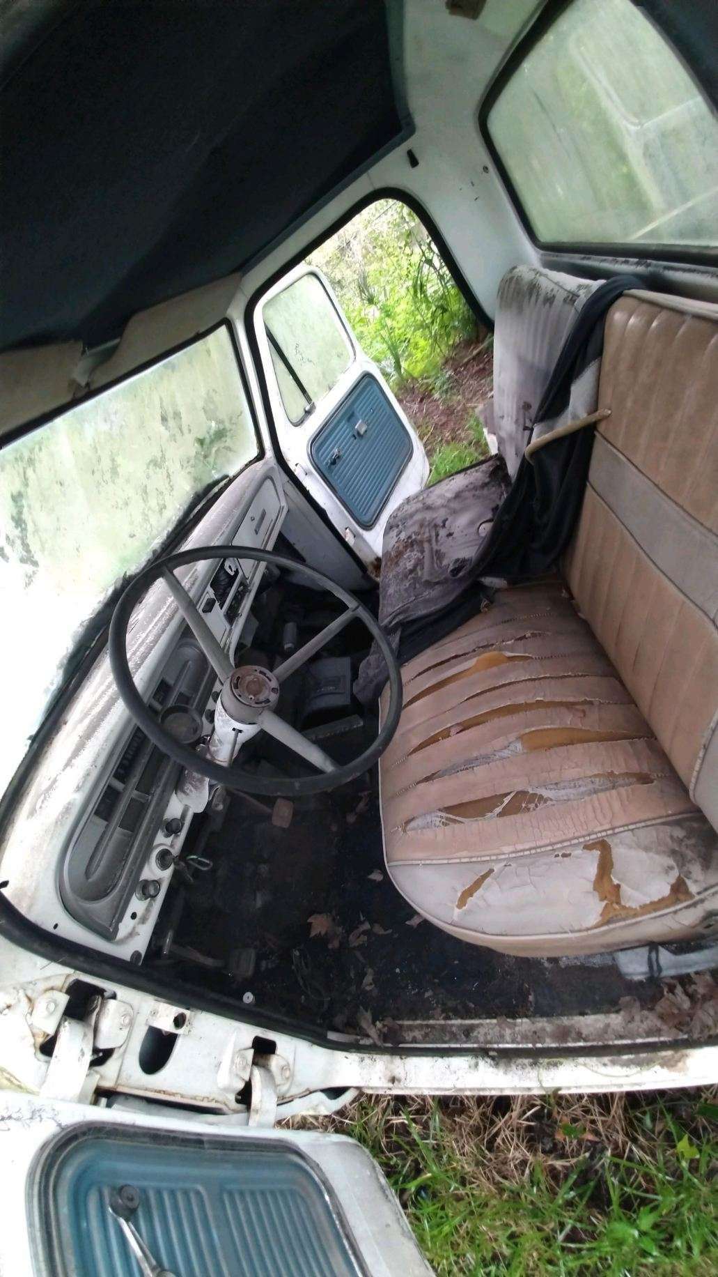

Pulled the trigger on the motor and trans ended up negotiating and trading a couple of rifles for it. I've been doing a lot more research very excited about this build. Here are some pics of the engine and the truck it's going in.... Let the fun begin haha!!
Thankthank you very much for the other feedback so far definitely will put it to use keep it coming.
We we have had the truck for several years, I drove it regularly until hurricane Irma hit us pretty hard and we took six feet of water across our yard. Flood insurance would not cover the damages on the truck and having to repair our house and everything else that we lost in the flood the truck ended up sitting for a little while. We are going to start stripping it down and getting it rolling. Very excited to finally get moving on our old truck! Her name is Betty!

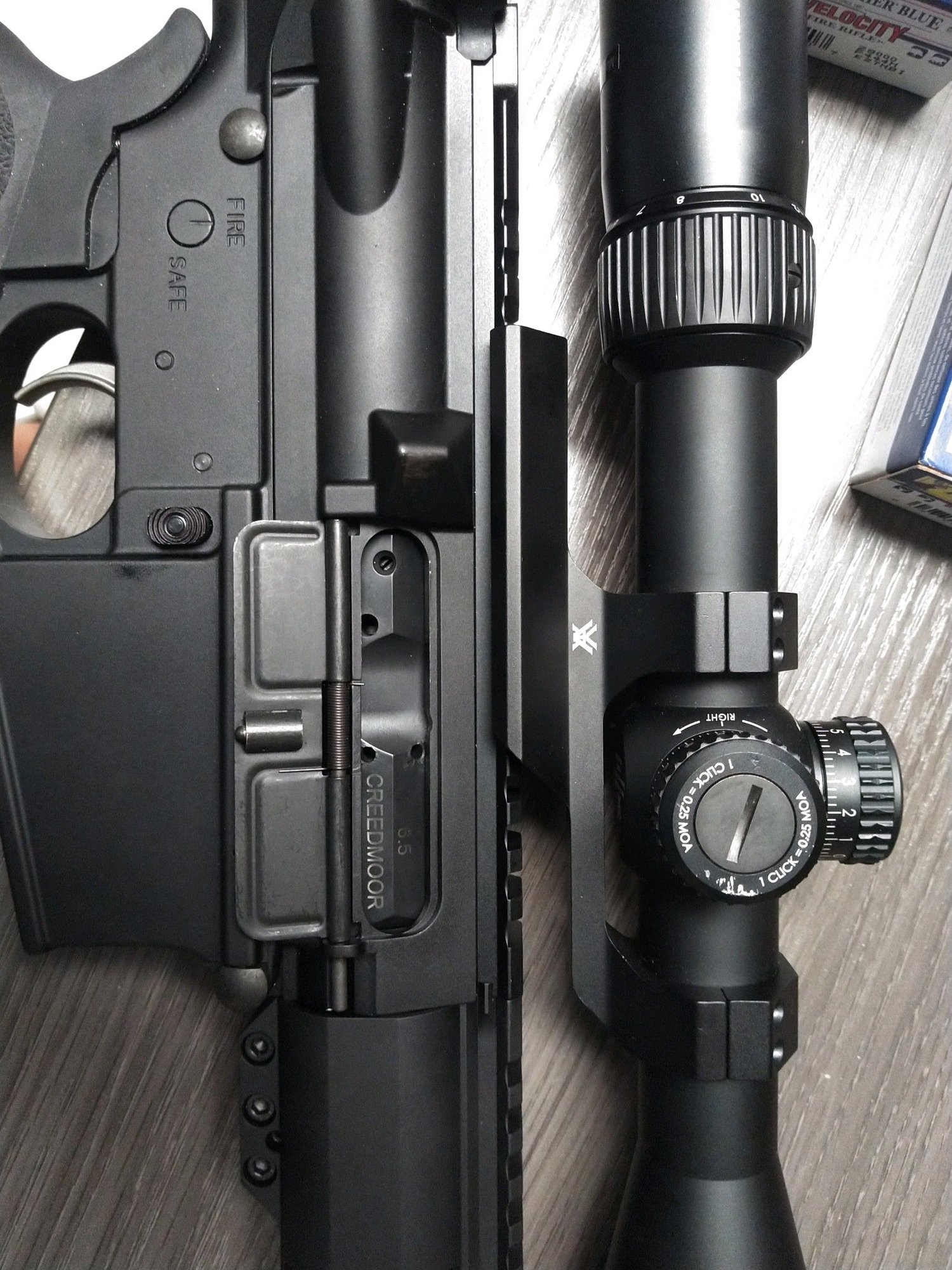

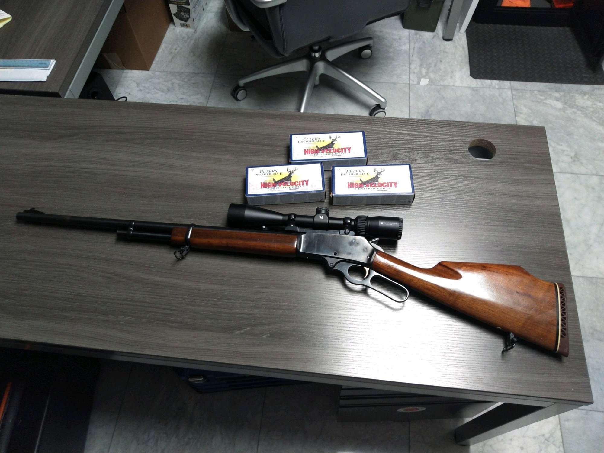

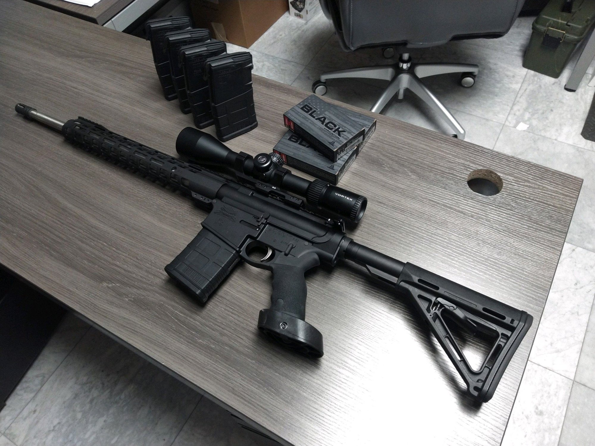

Originally Posted by myrtlehead
Have to ask, sorry! What rifles did you trade????
Good trade... Great rifles from my collection.....
AR10 IN 6.5 CREEDMOOR
MARLIN MODEL 444
​​​​​​ SCOPES MAGS AND 120 ROUNDS OF AMMO.
The AR-10 was very fun to shoot but the Marlin lever action .444 would give you an *** kicking that felt good at the same time! Serious power in that 444! It was my favorite 200yd rifle!!! Kind of like being punched by Muhammad Ali.... hurts like a SOB but very excited to get hit!!!One of those things you have to experience to understand... Haha!!... I have others though.... .338 Lapua Mag PSR that is the baddest of the bunch!
