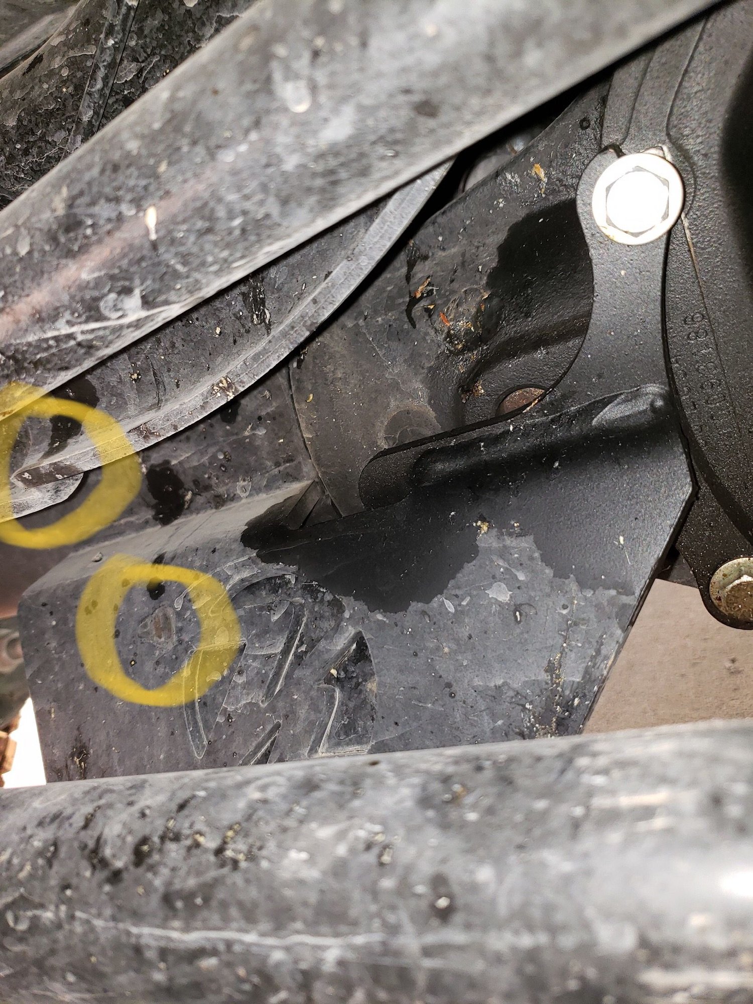

Put my Kelderman dual steering stabilizer on a few months ago and noticed today it's leaking as well. I also used the spacer too because it seemed needed to get all the parts mounted and aligned properly. Has anyone contacted Kelderman about this? I may just pull the two bolts and add a generous amount of permatex like others have done.

I think pulling those two bolts is what compromised the gasket, not necessarily the Kelderman kit itself. If PMF doesn't rely on those bolts then you should be fine, but if it does, you'll probably have the same problem. I took some pics earlier for my own reference but will put them here for others to see.

A few days ago I cleaned up the oil, pulled the two bolts, and liberally added some Permatex to each. So far so good, but we'll see over time if the leak is addressed.

Fwiw, those bolt holes don't go all the way thru into the oil. The only way oil could seep out thru the bolt holes is if the seal breaks
The bracket is probably tweaking the diff cover enough to break the seal.....
Another reason that a dual stabilizer is a waste. if you need a dual stabilizer it's because you have something else going on.. you only need one..

I don't think this is true. I didn't pull my diff cover off to look, but I called Kelderman and spoke with Kyle. He explained that when the diff cover is sealed from the factory the amount of sealant used is inconsistent. Sometimes there's enough that when the bolts are removed oil won't drain into the tapped hole. Other times there isn't enough sealant so oil does drain once the bolt is removed. This lines up with my experience when fixing the problem. After removing the bolts to apply Permatex, fresh oil was clearly draining from inside the tapped hole. It was fresh, clean, clear, gear oil. You could smell it without even putting it to your nose.
This tells me that the holes are tapped through and exposed to the oil.
