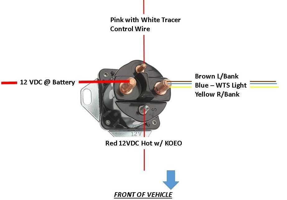

Here is a picture of the GPR as you will see it looking from the front. The small wire to the rear is the ground and goes to the PCM. Disconnect it and apply ground to that lug on the GPR and see what you get.

​​​​​​Does it matter where I ground it too? I have full power to both little terminals and the battery terminal just not the brown and yellow wires.
Direct to the battery would be best but any good ground should do.

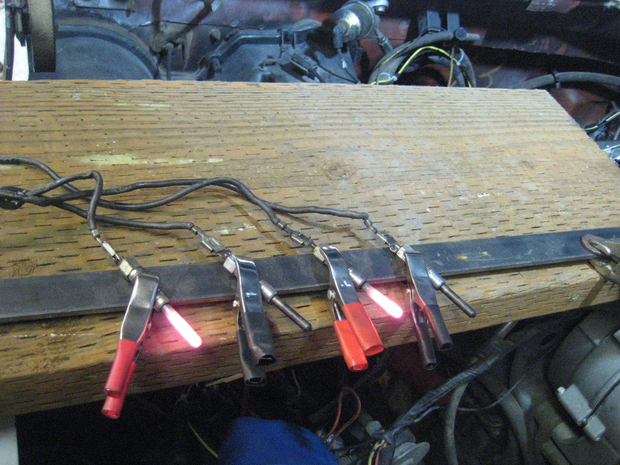

I have a cold starting issue also. My motor fires right up (without glow plugs) if the block heater has been plugged in for a few hours. What I am finding with the beru/motorcraft glow plugs is this. They appear to have an internal fusible link. If power is kept on them too long, the link burns out long before the end of the glow plug has time to swell up. This feature allows the glow plug to be easily removed without the tip breaking off. I don't know if all beru/motorcraft glow plugs have that feature or just the ones I am dealing with. Mine came from ORilley's and on the receipt it states they are warrantied for 2 years.
I removed glow plug wiring harness and made a crude test bench. Several of the beru/motorcraft glow plugs failed after one week. They were warrantied.
There is a possibility that some of the glow plugs you installed are not working properly. This was the only "test" that I trusted... I am swapping over to dual element glow plugs and fabricating a new wiring harness..
Hobo
I don't think those look like my glow plugs do.
