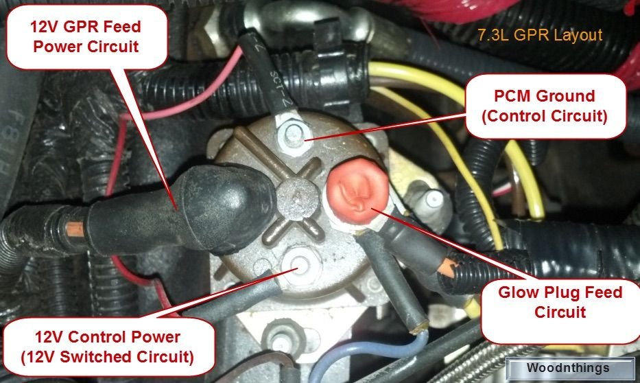

I agree mine were not as fat and a little longer. Does anyone have a good diagram I could follow? It's hard to understand exactly what works best and I have a stancor relay and it's kinda throwing me off a bit going off the original relay set up. Looks like there are many ways of doing this and of anyone has done this on a stancor relay that would be best.

Before I put the glow plugs in i used the volt meter to check the resistance and they all tested 1.2 oms exactly. The problem right now is the GPR isn't getting power from the wires leading to the glow plugs themselves with the key on. Meaning my PCM isn't grounding that terminal on the GPR and my glow plugs are not getting hot or warming up at all.

Not necessarily, it is possible to get a bad relay out of the box. And, no offense intended, are you sure the relay is wired correctly? Did you try removing the ground lead to the PCM and grounding that lug yet and see if helps? If you apply ground to that lug and the relay works, then you have an issue with the PCM or a broken wire leading to it.
No offense taken. I have watched many videos on the stancor really just to double check if the wiring is correct and it is all good. I will check to see if putting it on the negative will work once I get back home. I've also got a 97 7.3 with the stancor relay and while the key was on the terminal that mine isn't powering was on that one so I switched them out to see if it was the relay and still got the same result.

So I put in the switch to the relay and it worked. But now I got a big problem. I was warming it up and then all of a sudden the truck turns off and I go to start it again and the battery is dead. So here's how I hooked it up I took the negative from the PCM that should look like a orange wire and covered it with electrical tape. Then took new wire from that terminal to one post on the dash then with the other post wired it up to the negative on the battery.
