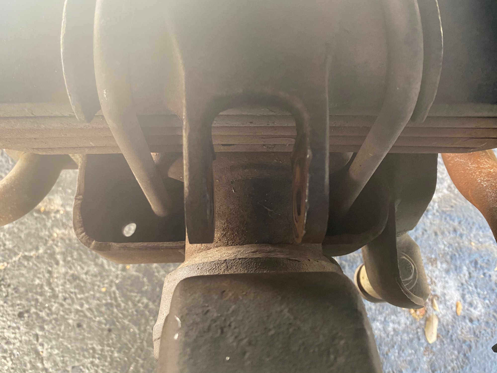

Upon going to install the lower shock bolt today I saw the part would not fit. Does anyone know a trick or two?

The shock appears just too wide for the lower mount. Having the same problem with the steering stabilizer as well. Slides on the top mount without issue.

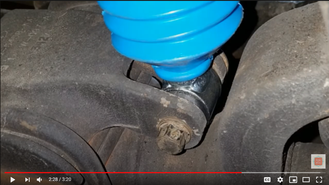

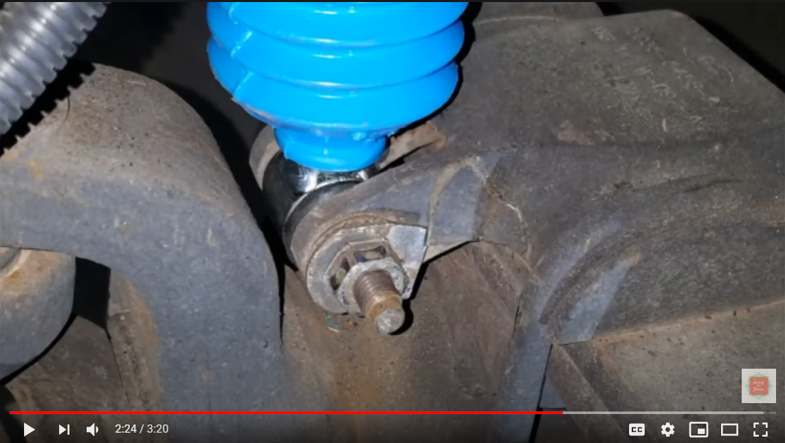

Is the rigid/metal part of the shock wider than the mount when measured with a tape measure or ruler? If the bushing is too big, you probably need to use some force in order to get it in there as long as the metal is the right size.
Below is a snip from my video at timestamp 2:24. You can see the bushing is somewhat squeezed and a tight fit.

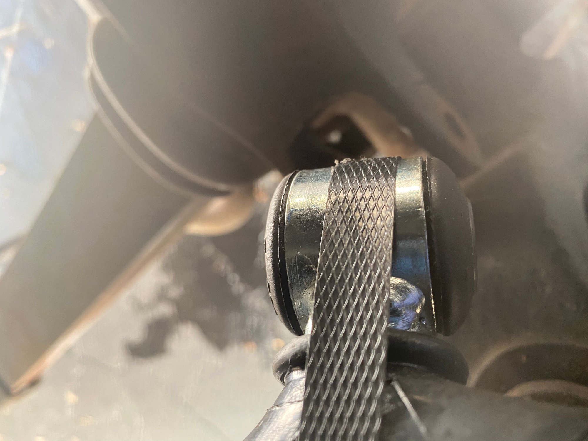

Below is a picture from the other side.

You should be able to compress the shock by hand with a decent amount of force like I do at timestamp 1:40 in the video above.
At timestamp 1:48 I begin installing the front shocks exactly the same way that Colorado350 described. If the base mounting point of the shock is of an appropriate size, it will go. By using this method and the method detailed in the video, you not on take care of the lower and more difficult mount before moving to the top mount where you have much more room to move and work.

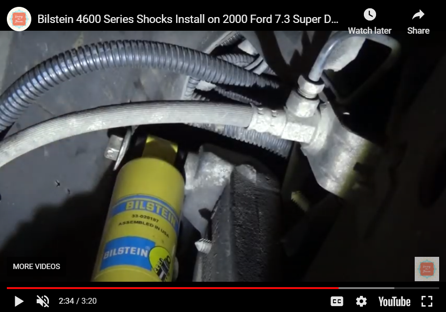

Are those shocks mounted upside down?
I don't believe so, but I have been known to make mistakes before... This was a while ago when I installed them, but based on what I remember from the time of installation the "Bilstein" was printed to be read upright as if someone was looking at the shock from the side of the truck.
Here is a snip from another section of the video where the "Bilstein" is visible and in the upright position.

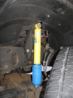

Here is another image of them, which is the same kit I bought for all 4 corners. The rear has the blue cover on top, but the front has the blue cover on bottom. Again, I could be wrong, but that is what I understood about how to mount them. I will do some looking around and see if I can verify they are mounted properly or upside down.
Here is an image of the same shock on another 7.3L SD truck, which is reassuring.
Image source: https://www.ford-trucks.com/forums/7...ml#post6056620

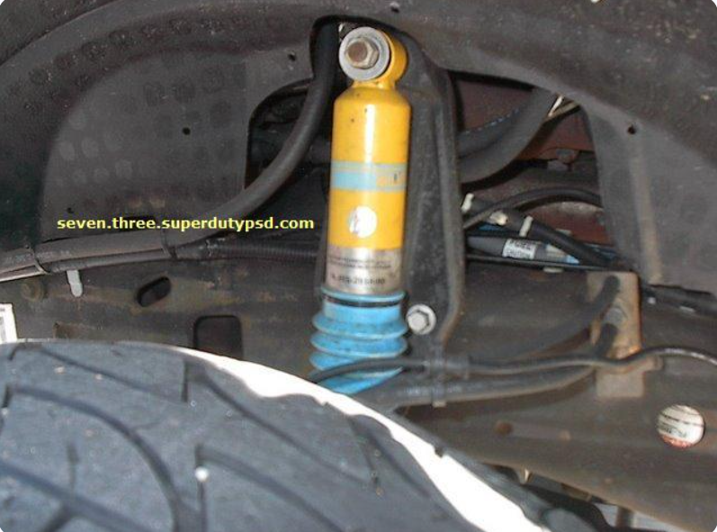

Another somewhat confirmation on the method of installation I selected from www.superdutypsd.com website, which I have used for years and trust as a reputable source.
Image source: https://www.superdutypsd.com/shocks.php
Brokestroke, I do appreciate you checking my work and my back though. I am in no way perfect and will admit it when I make a mistake. I would much rather admit the mistake and correct it than to roll on like it was right and knowing in my heart it was wrong.
