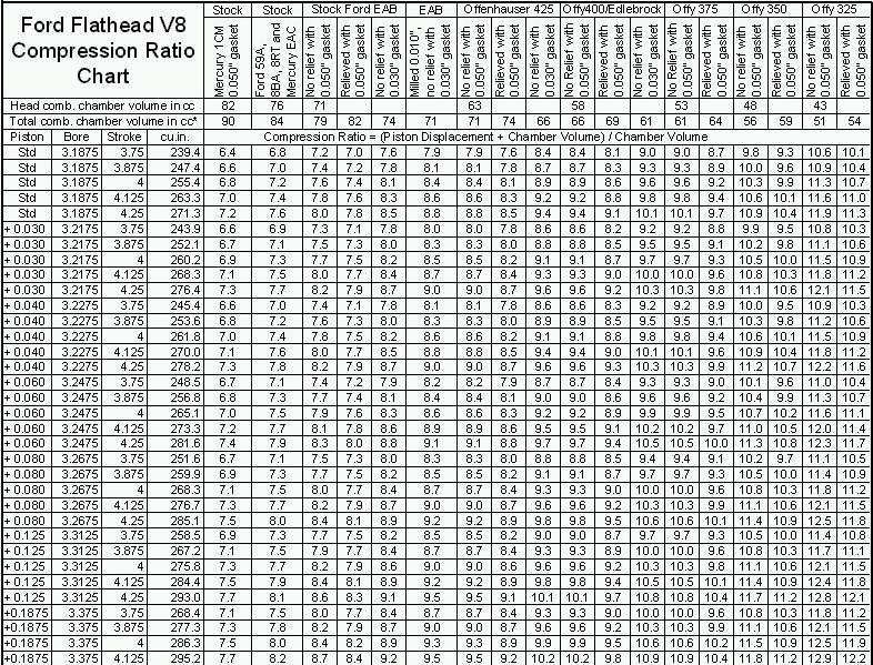

Long answer to a short question - the combustion chambers of Flathead Fords are frequently out of specification due to casting variations. Typically the chambers are a bit bigger, not smaller, than stated in the various Ford literature. Also, the piston dome shape varies a bit between original and the various manufacturers today so stating a compression ratio without actually measuring is pretending accuracy you don't have. That said, someone went through a lot of effort to try to be as accurate as reasonably possible and compiled a huge list of flathead compression ratios using all the combinations of bore size, stroke length, and head types that can be put together. The table can be found here (I saved a copy on my computer a while back for reference). According to that chart a 0.030 overbore (assumed since that is typical first rebuild size) with a 4" crank (260 cubes) and stock 8BA / 8RT heads results in 7.25 to 1 compression ratio, up from 6.76 with a stock bore 239 cube 8BA / 8RT motor, and up from 6.67 to one for a stock bore 255 cube 8CM motor. Milling the head for piston clearance doesn't raise the compression much, but does improve the mixture turbulence and combustion event.

I couldn't get the link to load, I suspect it is for this table?
It is the expanded version of that table, findable from HAMB and Ford Barn threads, one here, hopefully with a working link to the attachment here.

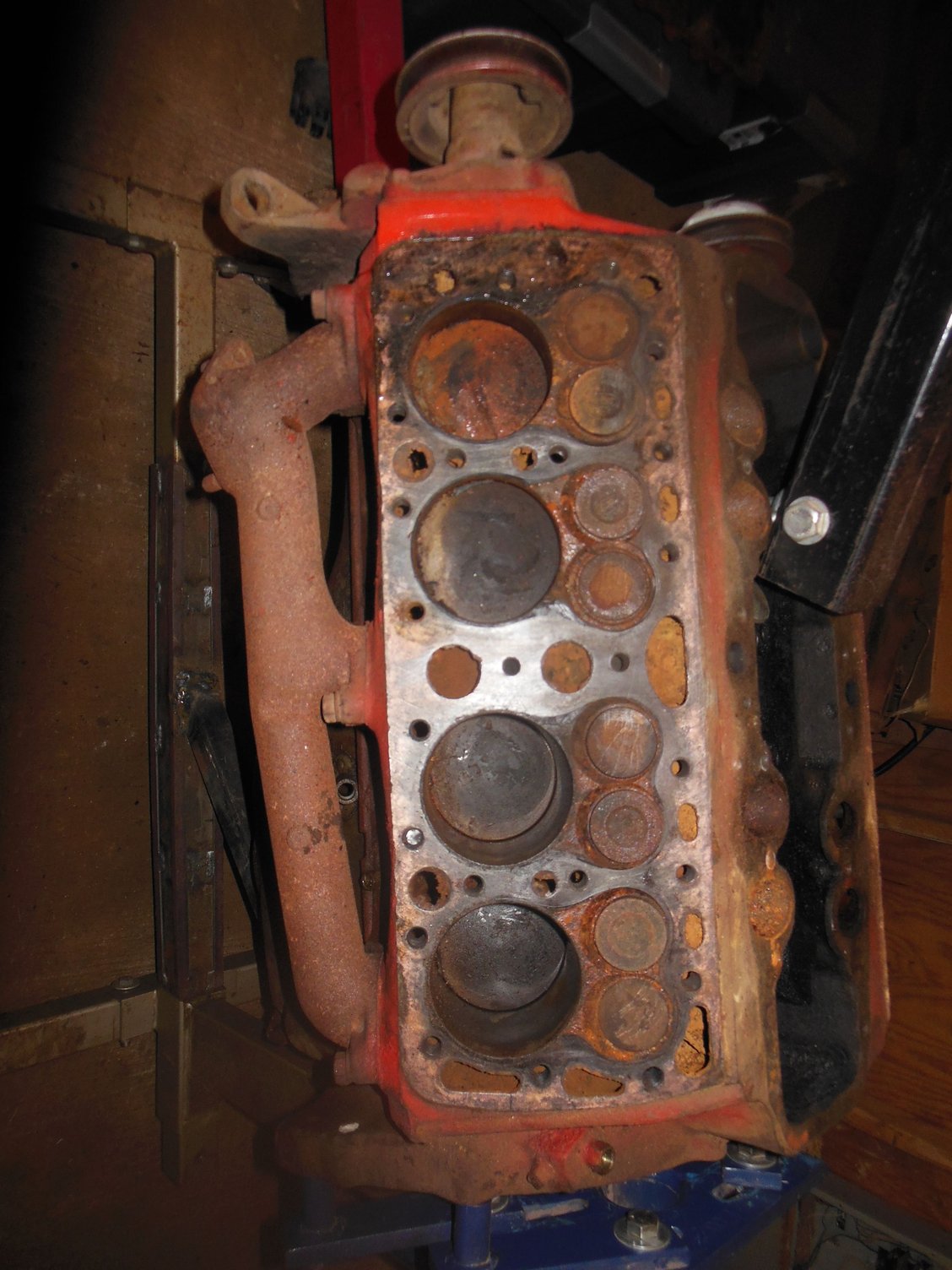

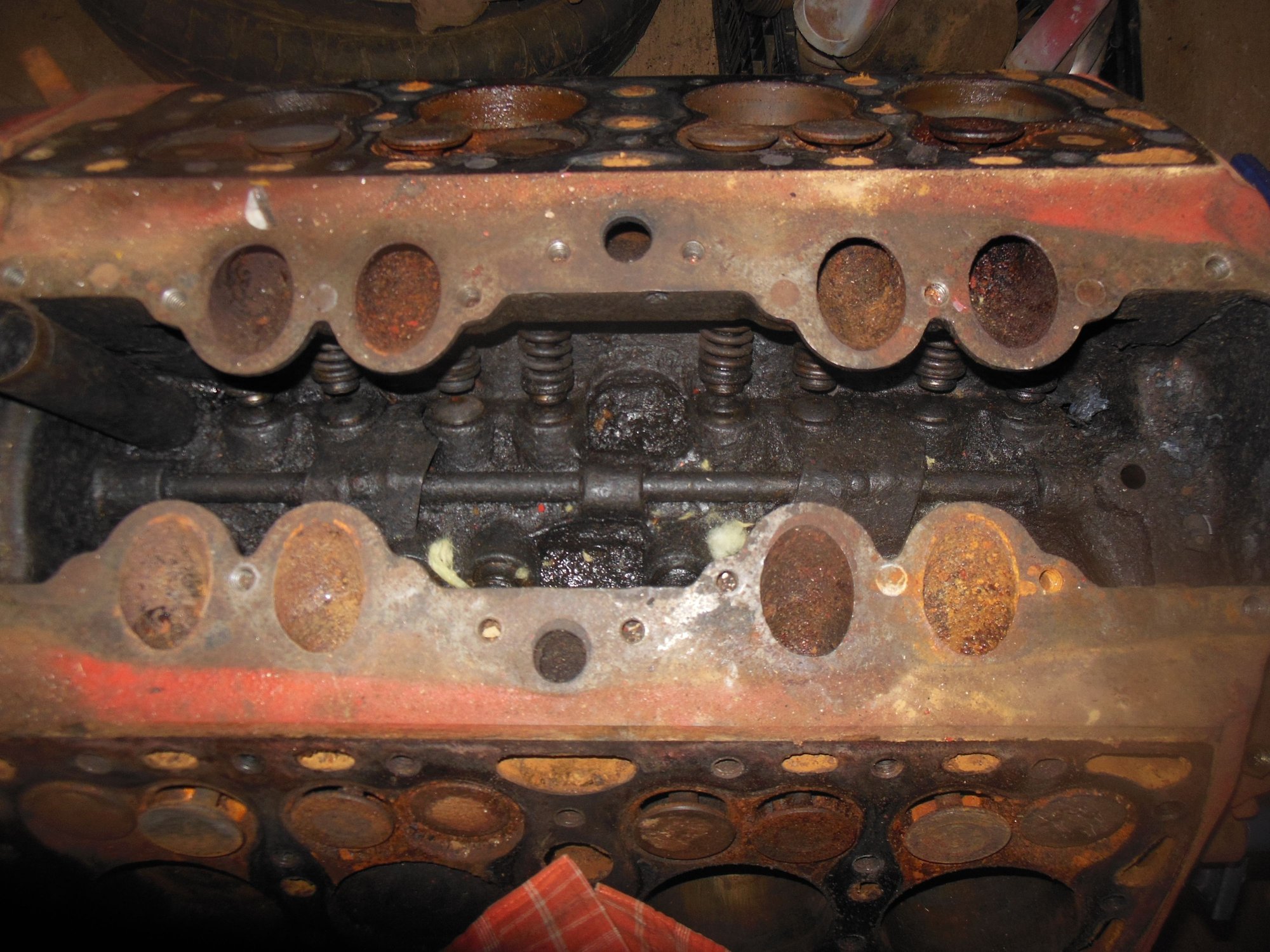

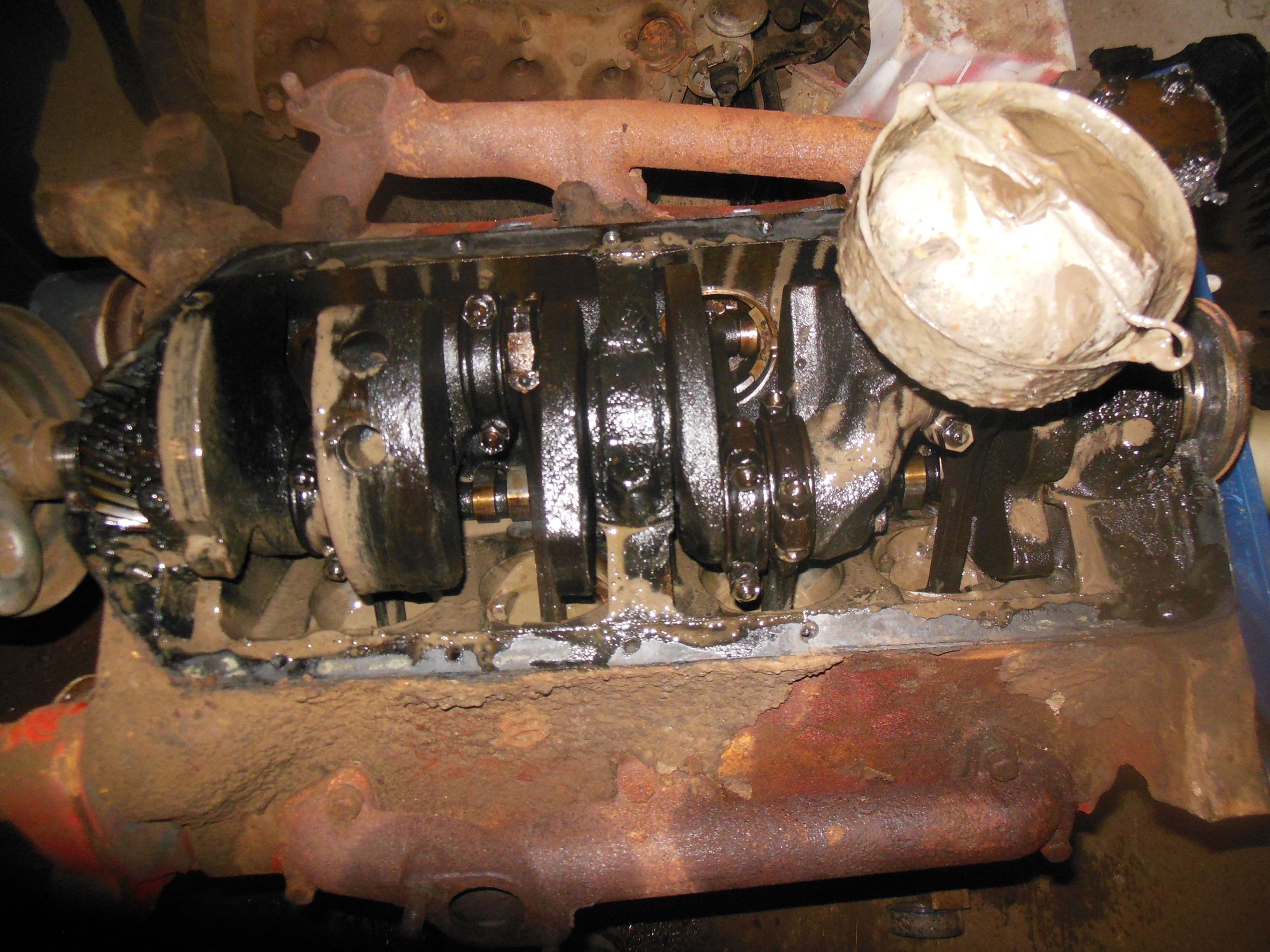

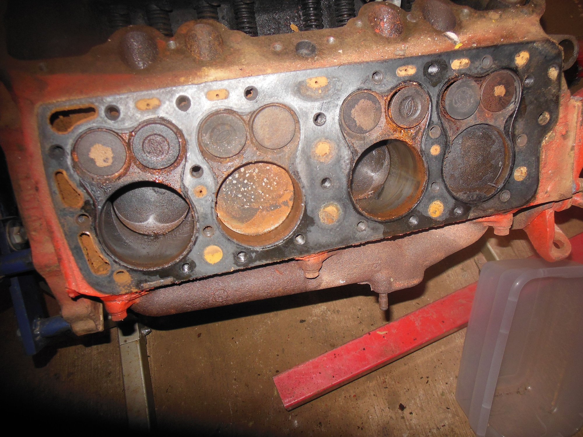

Pics of supposed '51 Mercury

That doesn't look promising...

Hard pass... it would take a lot of work and $$ just to find out if it is cracked or not. I'd guess every one of the valve guides is stuck hard, likely have to cut the valves to get them out. If you just want a runner, there have to be better choices out there.

Why, it ran very well for about 2 weeks and then quit. What problems do you see.

There is a lot of rust in the bores, valves, and ports. The color of the sludge in the crankcase looks like water and oil mix. Thick baked on looking sludge in the valley. There is what looks like old gasket on the oil pan rail, if it isn't gasket then the block is cracked a the bolt hole.
Old Nov 28, 2020 | 10:04 PM
ALBUQ F-1's Avatar
ALBUQ F-1
Joined: Jul 2004
Posts: 27,299
Likes: 1,059
From: NM
What ^^^ he said. Did you change the oil before you ran it? if so then all that water got in there during the 2 week run, almost certainly means the block is cracked.
