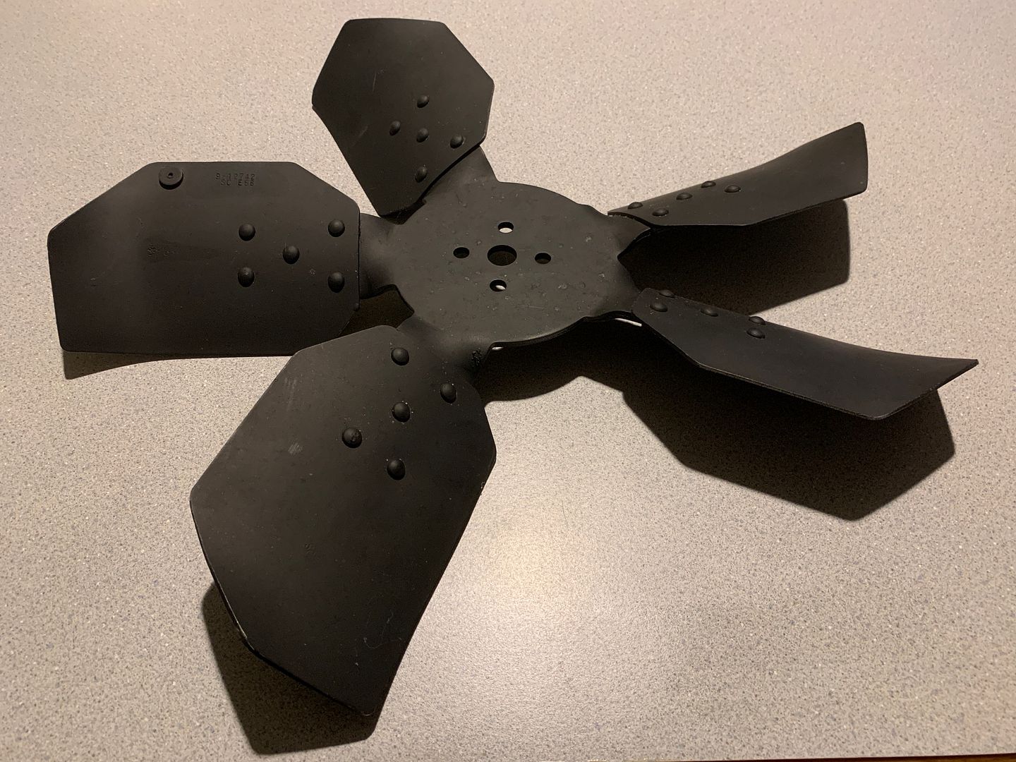

I have been looking for a correct Ford clutch fan for awhile now to replace the Chevy clutch fan that required an adaptor to fit the 3/4" shaft. Anyone know what it would have been original to?

That is a centrifugal clutch, so it is aftermarket, all OEM clutches are Thermal. Not sure what the blade came from, but it's a typical configuration for any Ford that is the same diameter. The thing that varied was the length of the clutch shaft.

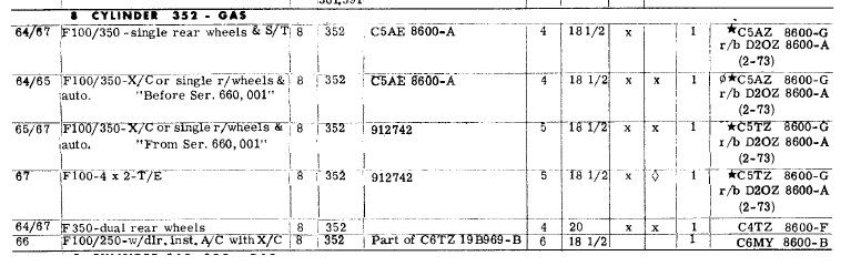

The C6ME-A applications are listed here (click on the link). Obviously not original to our trucks since it is 7 blade.
https://www.ford-trucks.com/forums/9...ml#post8466940
What John says about all of our trucks having 4 blade isn't correct. Many did, but not all. There were factory 5 blades and a dealer installed 6 blade.
My own truck with MX COM came with the 5 blade fan. This is the 912742 from the MPC entry above.

My 66 CS did come with the 912742., Then I added a shroud, that's where this journey started. The fan was so far forward it just created a lot of turbulence inside the shroud a no real movement to the rear at idle. The 6 blade clutch fan on there now requires an adaptor to fit and is PITA to get off and on. This new fan will eliminate the adaptor and move the fan back almost flush with the rear of the shroud. We'll see how it goes today.

Air movement to the engine is much better at idle. Here are some before and after pics.
New fan
Old fan

According to Number Dummy the C6ME-A 7 blade clutch fan did come on the 68-72 F series, trucks did come with this fan. My wife just bought a new Retro 23' travel trailer that she expects me to tow around so I'm getting things in order to do so.
