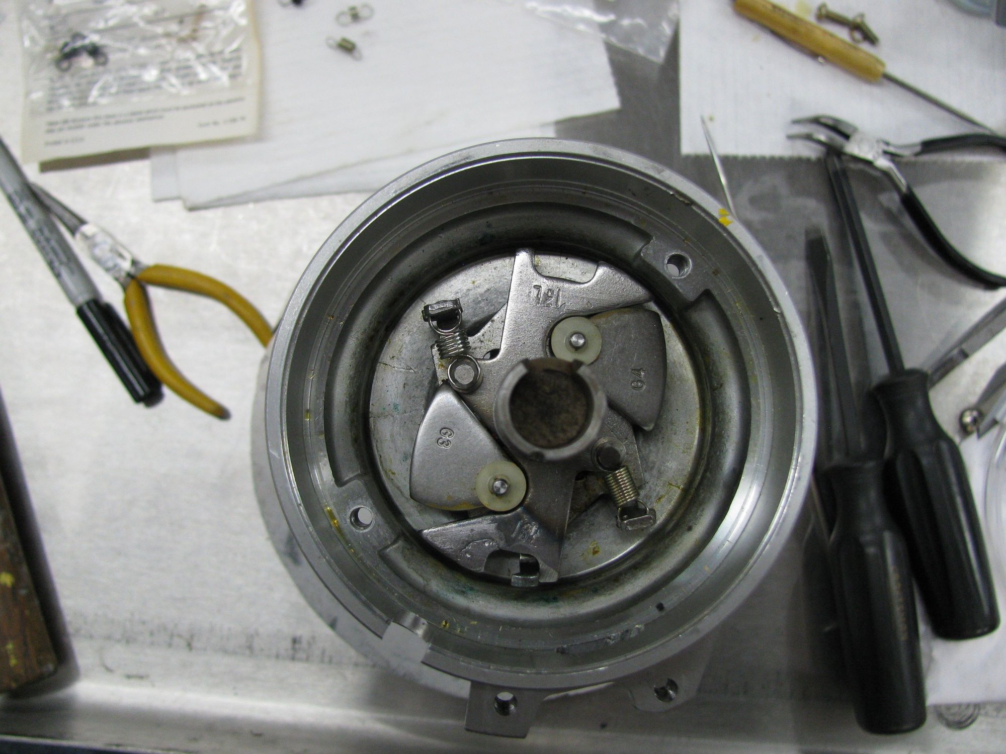

This is what it looks like inside.

The spring on the right looks like it needs bending in at the catch. The way it is, it has less spring tension than it should, which can advance your timing too much too early.
Compare how it's attached to the spring on the left.

Looking at the housing that distributor has the appearance of a made in china one size fits all distributor. There are two waysto fix it. The simplest is change the advance plate. The next is to remove the plate and weld up the slot then resize it to what you need. the picture is one I did awhile back. The advance plates with the high numbered slots like you have are usually found in medium duty trucks. They also have springs that are way to stiff for a lighter vehicle.
If you are handy with a welder or know someone who is the slot width needs to be .013 inch per degree plus the width of the stop pin about .150 inch. A 14 degree slot is .514.

I guess we were typing at about the same time. Yes the plates interchange. In fact you can convert a points distributor to a Duraspark by just changing the advance plate and everything above it. The reason I think you have a made in China distributor is if you look at my pic you see the Ford distributor is machined on the inside the Chinese ones are just rough castings.
You can file that 13 degree notch out a little to get a little more advance. If I were doing it I would get a Moroso spring kit and lighten up the springs a little and get the advance all in by 3000 or so.
