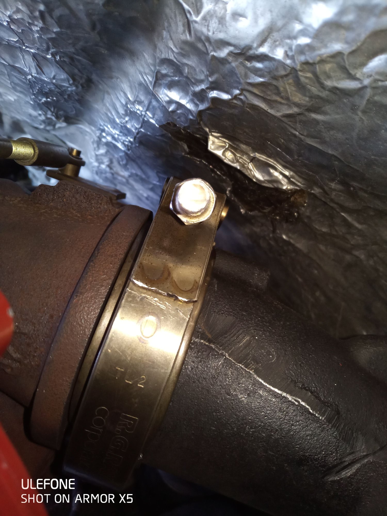

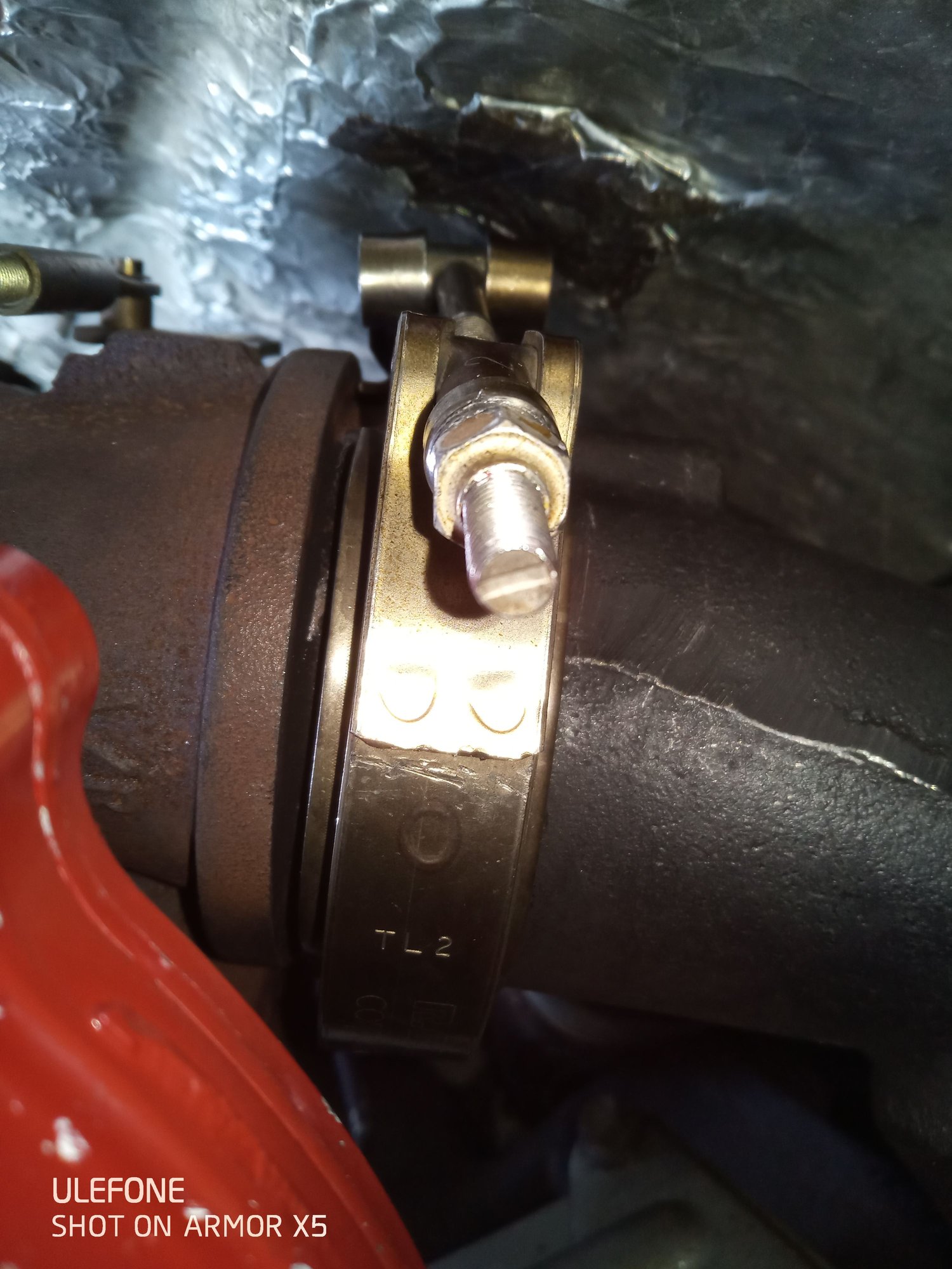

Pulled out all the stops for round cinco! The test fit is OK a bit rocky. I filled the pin some. I'm not sure that helps, but never try this with out a test fit! You can get a feel for what it should fell like when it going together, how much play ect.
When I went to install it, I left the pedestal loosely attached and all of the exhaust disconnected. It did not feel any different from the last try, it looks about the same, but this time it worked. I did a quick test drive, she will produce at least 28lbs of boost on an on ramp, it's not leaking so that's one in the win column boyz. This kit is from ebay or amazon I don't remember it been siting around for over a year. It looked good, but it did not cost much It says PSD on the pipes. It may have been hanging up on the 4", or maybe the pedestal was in the wrong position. When I pulled the pas side down pipe there was a rub mark on it.
Thanks for all the hand holding. it's been so much fun. That last pic is from my 4th attempt.
