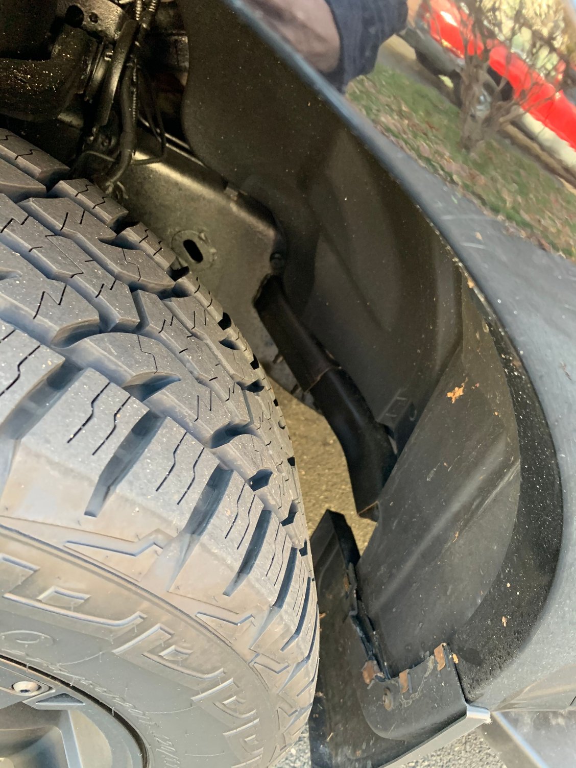

So, I just purchased a 2017 f150 super crew with 6 ft bed. I noticed that any full turn (turning to end of steerting capacity) results in a vibration or slight bouncing of the truck. Additionally, the turn radius is not very good. I’ve read a review of a 2015 f150 where they confined the below average radius so it is what it is. But the bouncing or vibration doesn’t seem like something that should happen.
I have a 2013 Tahoe that doesn’t do this so should I be concerned? I had the wife turn the wheel while I watched and I could not see any rubbing.
is this normal behavior? This is my first Ford truck and first full size, so not much to compare it to.

You either have a 5.5' bed or a 6.5' bed. My truck has a 6.5' bed and the turning radius is awful. You get used to it though. There shouldn't be any vibration unless your truck has somehow been put into 4 wheel drive, in which case turning on dry ground has that kind of affect.

It also will depend on the tire tread type. Some All-terrain tires have more of an aggressive tread edge that is more like 90° than rounded as in a passenger tire.

What size tires? You may be hitting the crash bars or other stuff when at full lock if you have larger than stock or different wheels.

I’ve got 275/55 R20s. I didn’t think about the crash bar, that’s a good point.

You have aftermarket wheels. Do they have the proper lug nuts and are they torqued to 150 ft lbs? The tire size if the same as factory, so that shouldn't be an issue.

That all said, we do not have the symptoms you are having (outside of the turn radius). I'm with JKBrad, that I suspect your aftermarket wheels are suspect.

Thanks fellas. I didn’t think about the lugs. I just assumed the dealership checked all that with their whole CPO program, but I should know better. I’ll check that out tomorrow.

I’m surprised they did CPO with aftermarket wheels. I believe those are drilled with 12 holes so that they will fit both 6x6.5 and 6x135 lug pattern trucks. Dual pattern wheels are much weaker in the hub areas, so check for cracks too.
