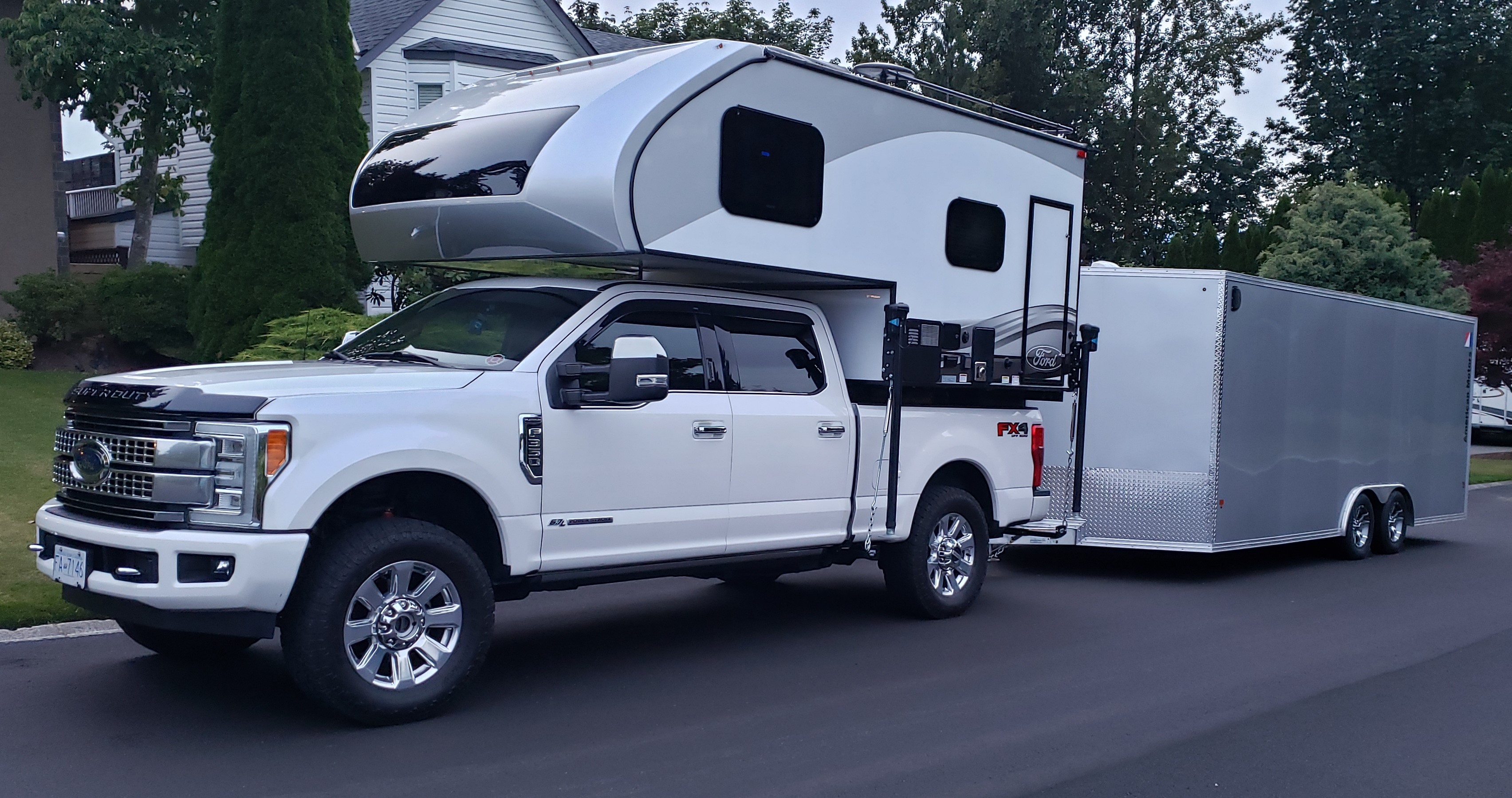

I don't consider my "safety solution" a band-aid at all. I bought a longer and extended shank for my drop hitch. This allows me to lower the tailgate without it contacting the tongue jacks on any of my trailers when accessing stuff in the bed with a trailer attached. It also gives me a little more length between the truck and trailer if I need a tight turn.

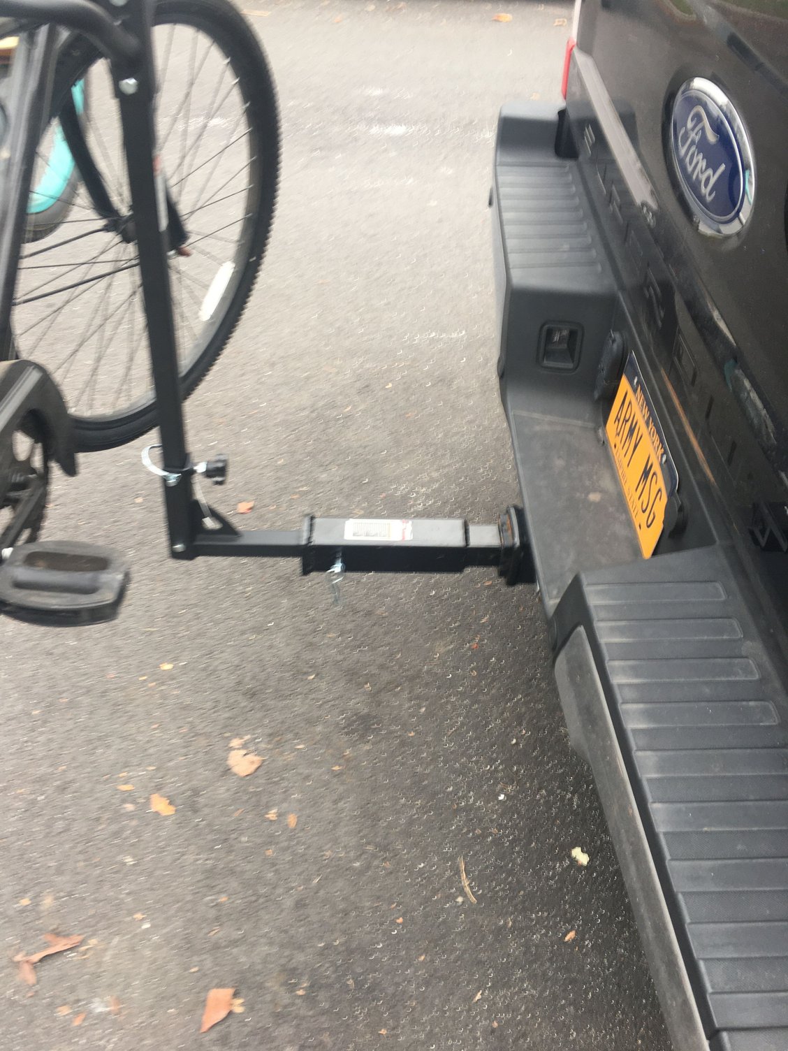

Originally Posted by speakerfritz
So I have a 2019 that needs the unattended tail gate opening recall. Took it in and they couldn’t do it cuase the guy who usually works on Ford escort oil changes couldn’t print out the instructions to do the cutting and splicing.
been trying to get the recall print out do I could see how complex this is
in the meanwhile. Wife wanted to take the bikes to the park. Typical bike rack will cuase tail gate damage if the unattended tail gate opening occurs.
I installed a 1 Foot extension. So now if the tail gate opens...it won’t hit any thing.
Just trying to stay ahead of Ford engineering.
how can I look this up to see if my 2019 Lariat has this Issue?
I have something quite similar to this. When my trailer is hooked up, I can actually open the tailgate if needed and not hit the trailer jack. Love having this long receiver on it. Plus I painted it red so nobody can say they didn't see it when they run into it.
have you noticed any greater sway with a longer shank? I may be looking into this, but heard it can increase sway the further you get away from the truck.
I've never experienced any sway, and I've hauled cross country several times in a lot of windy areas.
Attachment 280105
