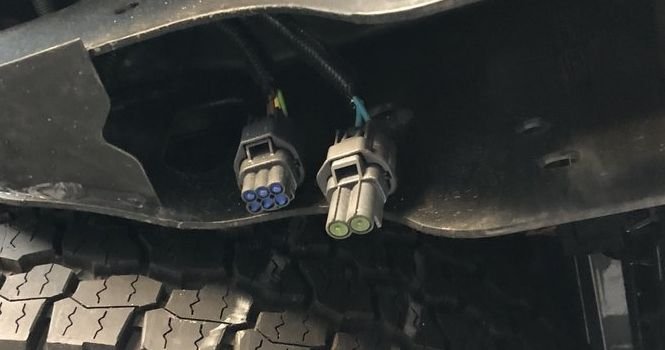

So planning to add extra reverse lights when I get the truck. Has anyone used this connection listed. I'm not quite following how to use this. Any guidance would be apricated, would be nice not to have to run wire all the way up to the upfitter box:

These are the plugs on my 2018...I plugged into the reverse pin (used a test lamp to confirm the circuit) for my back up light. I also used the tail / parking lamp circuit to add a bed light. I have a "kit" for making weather pak connectors, so I just removed the blue plug from the OE connector, terminated the wires for my circuits, and plugged them in.

To be clear, does this only apply to 2020 and up? I have a 2017 with a tommy lift that I installed an extra set of tail lights onto and ended up plugging them into the trailer wiring to get them to work. If I had a plug like this it would be nice because the truck wouldn't always think there's a trailer hooked up.

FWIW.........The plugs pictured above were factory installed on my 2018 Super Duty

I'll have to go see if they are on my truck. Where exactly are they located, near the spare maybe? Also, where could I get a pigtail to plug into that as I don't have the tools to make a connecter like that.

Thank you for the confirmation. It doesn’t state, but assume when you put in reverse this circuit is activated?
I read that if you plug in extra reverse lights here that it will state a trailer is connected; is that true for you? Also, it was stated that it monitors amp draw and if it goes over settings will throw an error and disable the reverse lights. From your post I assume you’ve had no issue with that? Plan to use LED’s so wattage will be low, but don’t want these types of issues.

My extra tail lights (including reverse) that are plugged into the hitch wiring are leds and do make the truck think a trailer is plugged in. They do not cause any sort of errors and I can (and do every time) tell the truck there is no trailer connected so that it doesn't rack up miles on a non existent trailer. I would love if this plug didn't cause the trailer issue so hopefully someone else chimes in.
