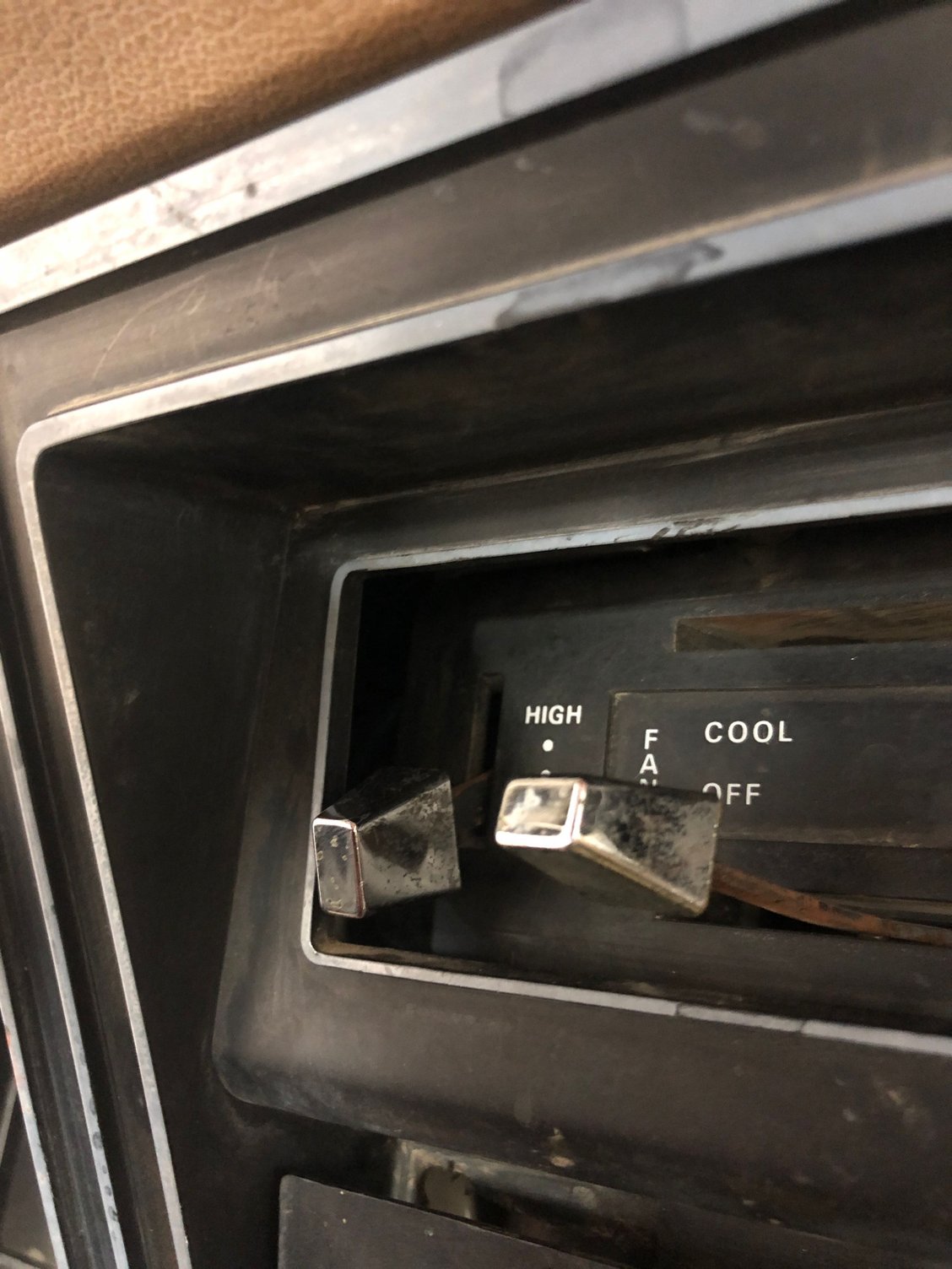

I have no idea what I did but this gap here doesn’t look right how can I fix this? I guess I messed up something or somewhere lol

looks like your radio isn't in correctly.

like the whole radio and heater control mount is wrong

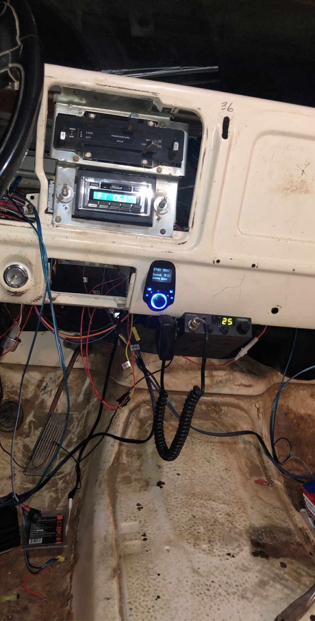

That’s how I have the radio and heater control mounted

Looks like you maybe have the bracket in the wrong place (mounted to far back)? And do you have the environmental control panel mounted properly? Or maybe put the radio shaft mount nuts and washers on, then put the OEM pot metal cover on? And made that gap.

I have made this same mistake, you mounted the control panel behind the mounting bracket of the dash rather than in front of the bracket.

I figured I watched a video on how to install the radio and I say his heater control panel was mounted outside well I have a project today thank you guys! I appreciate it
