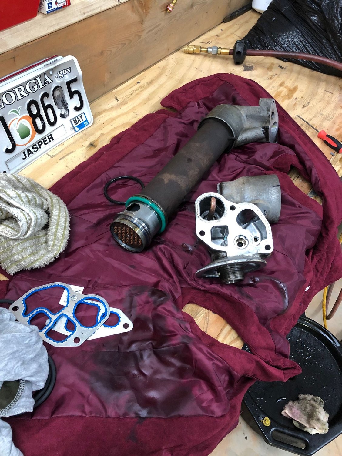

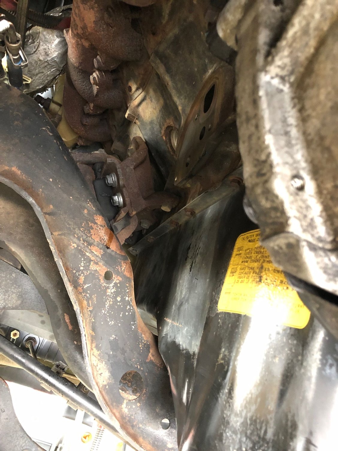

its not too bad, u can get to front bolts thru inner fender with extensions and swivel. I use ratchet strap and rubber mallet to coax it back together.

I did mine w/o removing the front header, greased everything up good & pried against the exhaust manifold to get tube back into the front header. Went together nice

if you wanna make it easier, get some long bolts (i think they're m8), cut the head off, and use them as studs to align everything, remove a stud, insert a bolt. I found it was a huge pain in the *** holding the cooler with one hand, getting a bolt started while having the gasket aligned.
This is a bad plan. You need to replace the gasket anyway and by not unbolting this, you are risking breaking the front cover and having to remove the engine. Besides, what an unnecessary PITA....
